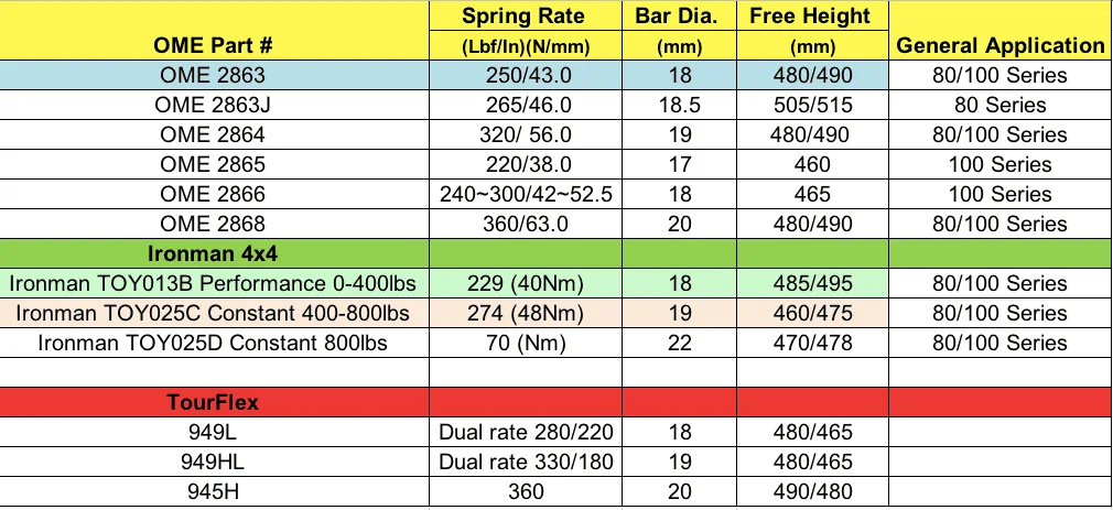

Ive maxed out the rate on my Ironman TOY13B springs with my build and looking for an option that will get rear height back up close to 23" hub center to fend lip height.
The Ironman TOY13B is a "performance coil" for loads from 0-220 kg ~40Nm spring rate 18mm coil 485/495mm free height- when I first installed them before the rear bumper and sliders my rear hub center to fender edge measurement was closer 23.5" . Later adding rear bumper & swing outs, sliders, drawers and fridge Ive lost some height and measuring 22,25 & 22.5 with a static load now closer to 450-500lbs.
So my next move is to go up a step on springs. Theres a few OME to consider, as well as some others. For those with set up similar to mine ( rear bumper & swing outs, sliders, drawers and fridge) running 2863 or another spring- what are your current hub center to fender edge measurements?
@atnolan94 What are your current measurements with the 863's we have similar set ups.
Here a comparison list I've started to put together:
