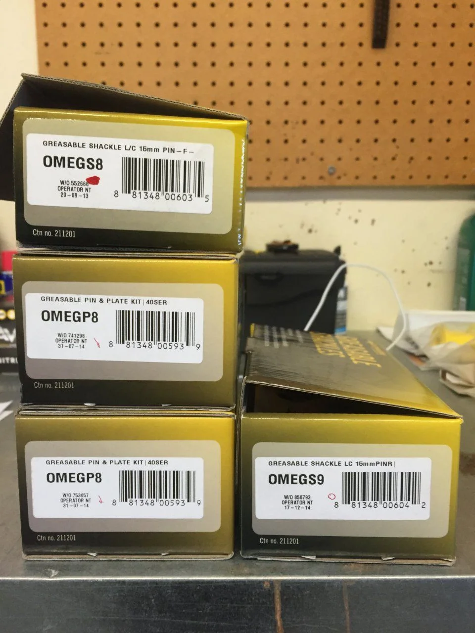

I'm helping my cousin install a 2 1/2" OME lift on his 1974 FJ40. We unpacked everything and noticed that three of the shackles are GS8 and one is GS9. This can not be right, can it? I know the answer but wanted to have a second opinion before they are returned and we are set back another weekend of work.
Believe it or not these are the right parts. We laid them out and they are all the same size, but are different looking which was confusing. Then we looked at the parts numbers again and found they are correct.

Pics please. You may want to ask ARB. When I installed my OME lift, the front pairs were shorter than the rears.

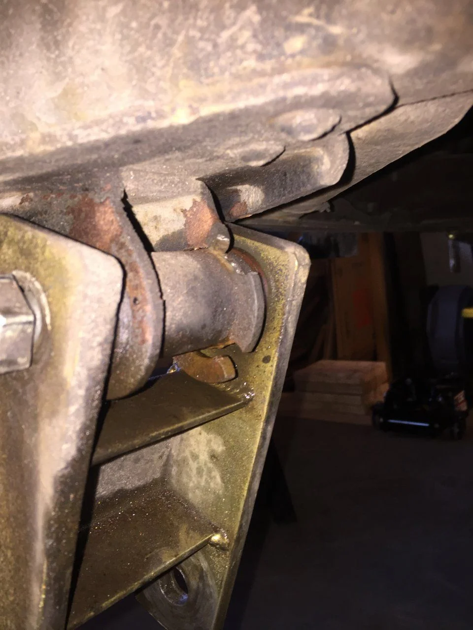

We were able to find an air hammer with a carbide chisel and began the process of removal. Thankfully it was found before it broke out on the trail or highway. This is what we are working with above.
That's kinda bad!!
I've never seen that before. Best to check the other side too. Looks like those shackles have very little lateral movement, based on the bracing. A little flex is actually good and the shackle flex is counted on as part of the suspension.
Well the new mount is installed. It took a little wile to punch out one of the rivets. We had to drill it out. It also required a little grinding to remove the short welds to the frame on each side of the mount.
Once that was done it was a matter just bolting in the new mount with copious amounts of Lock Tight. We were thinking of the lateral movement in the axle. Everything looks like it is order- not sure where the lateral movement is, if at all. The only thing we could think of was at some point a hair-line crack developed while off-road, became worse over time and revealed itself when we were pounding out the bushing bolt, which by the way was not coming out easily even with wacks from a 5 lb. mallet. Again, good thing this did not happen out on the road or while wheeling.
