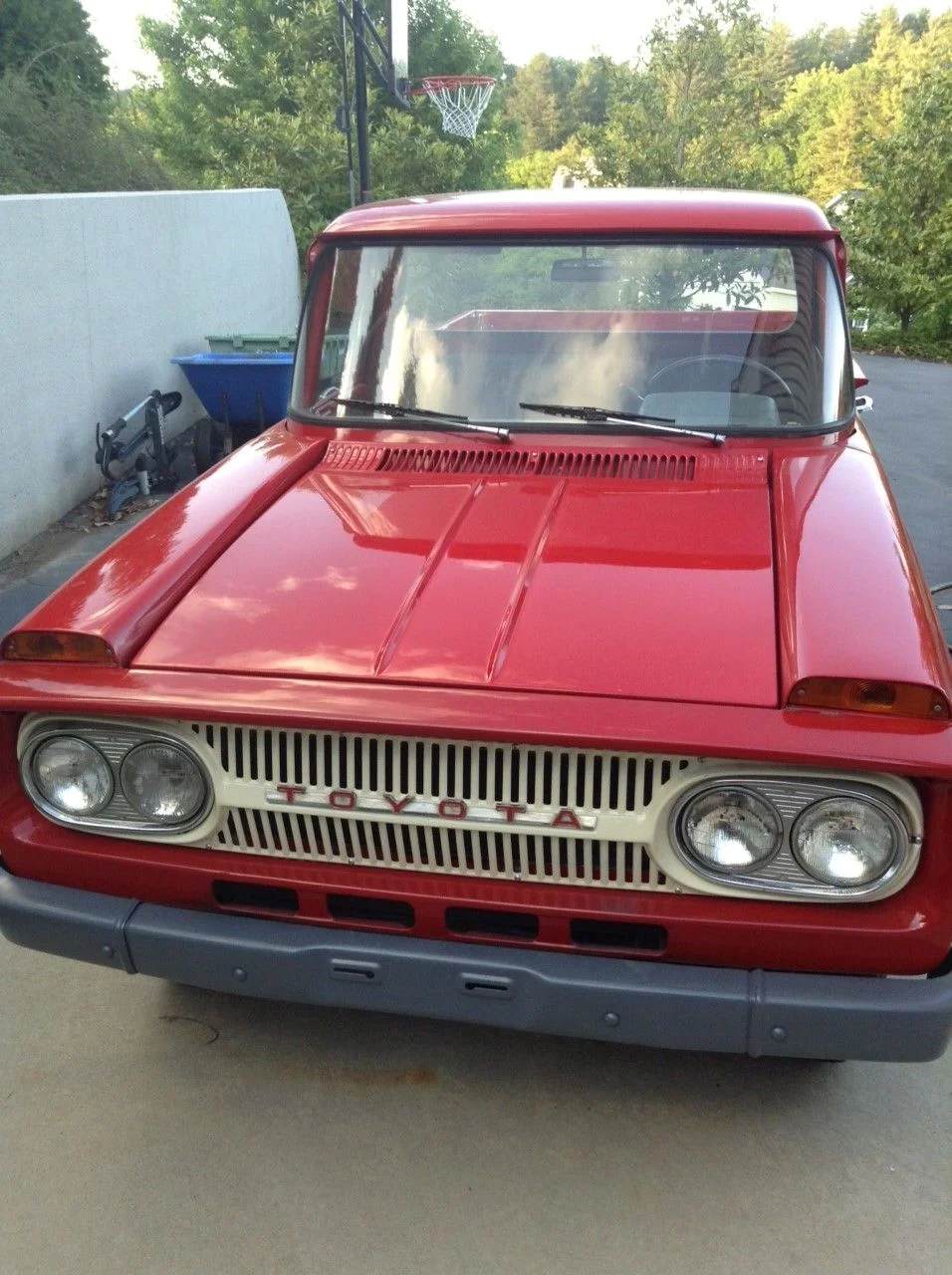

Looks like timing chain....more to come.
Yep, after nearly 50 years, it might be time to rebuild anyway.
