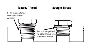

I'm about to replace my oil pressure sensor. How is it supposed to seal? (Should there be a gasket? O-ring? Just the threads themselves?)
I do not see a seal associated with the oil pressure sender.
Is the seal built in like on the oil filter?
The " seal " occurs due to Pipe Taper JIS threads
as the cone gets bigger it seals itself
to be clear , the OIL Sender has the Tapered Brass Threads
