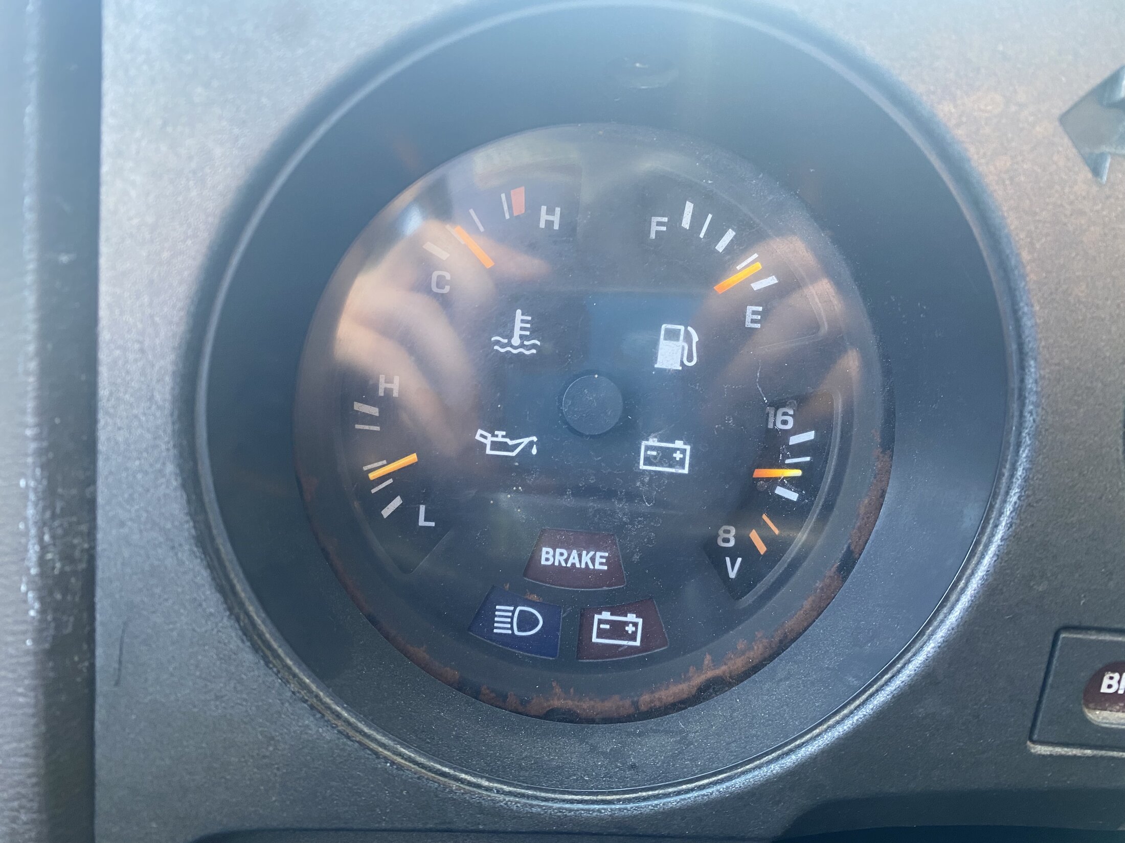

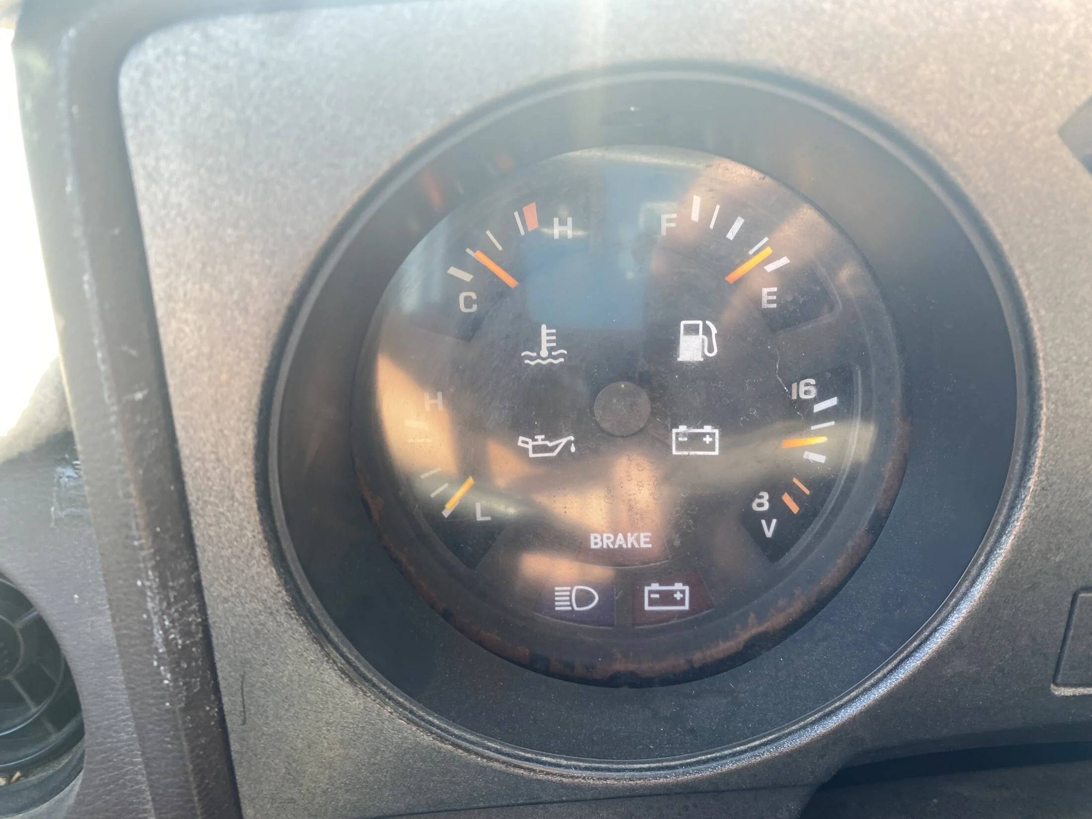

Just got a call from @cruiserinsanity regarding unusual oil pressure readings with the stock gauge on a 3FE. At idle the gauge is reading about 1/3 on the gauge, while at elevated rpm the needle is resting just above the lowest mark. This is opposite of how the gauge should be functioning which is a lower reading at idle and increased pressure at higher rpm.
While on the phone he looked over the engine. Oil volume is reading on the dipstick, no oil leakage at the sending unit, nor at the oil filter, plus there are no major oil leaks. Also pressure is not dependent upon volume until the amount of oil drops below 2 qts or so allowing the oil pickup to suck air. Then oil pressure will drop.
At the moment we think that the issue is a bad gauge, wiring, or sending unit.
Any input?
Oil pressure at idle
And oil pressure under load
I don't remember if the 62 gauges are better-grounded than 40 gauges, but a bad ground would be my first suspicion.
Yep, grounding for the sender would be the first thing I'd check. Then failing that, pull the sender to give it a good cleaning with some throttle body cleaner. A few years ago my gauge started reading excessively low, and for some reason I had remembered recently (at that point) reading about cleaning out the sender. Mine wasn't too bad inside, thanks to a couple decades of running synthetic oil keeping sludge buildup to a minimum, but upon cleaning and reinstallation, my gauge was back to working normal again.
