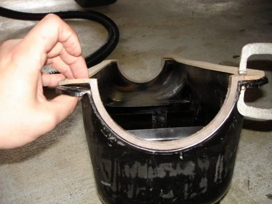

well i replaced the oil pan gasket once and it leaked pretty bad on the corners where the bearing caps are. it has been a few years since i replaced a op gakset and that was on my 74 F motor and i didnt' have any problems with that. this time i didn't pay that much attiention to it when i put it on but only to the bolt holes to make sure they linged up. I bought a new gasket and compaired it to the one i put on and its the same and then i fit it on the oil pan and in the corners it dont quite fit like i think it should. its sticks up in the corners almost 1/2" Is this normal?
Where did you get the gasket? That doesn't look right.

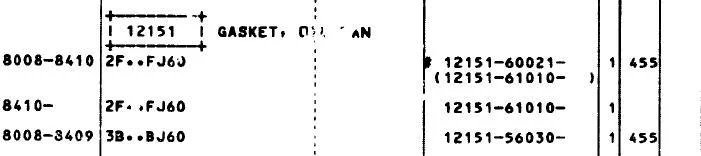

got it from the dealership 12151-61010 its the exact same part numer i used last time and i compaired it to the last gasket and it fits the same way. this is on a 87 fj60 2f built in feb of 87.
There are two versions of oil pans and two versions of gaskets. I think that if you get the newer oil pan, it'll fit this gasket better. I would call up Cruiser Dan and ask him about it. I recently got a new oil pan from him (200+bux) and the gasket seemed to fit ok.
Man, that looks off by a mile. I wonder if you could cut a section out of the middle of the curved part and glue it back together with High Tack to make it fit?
That's the correct part number for the 2F engine. There was a part change in '84, but the old part is superseded by the new part.

cutting it is an option but i really dont want to.
and 2mbb is correct there is only one gasket now. the guy at the dealership looked up both pans because of notes in the computer and came up with the same part number.
That's what mine looked like when I did it a few months ago. It was a pain to keep it lined up, but it seemed to go in fine.

it looks good because i scraped about a 1/4" build up of oil and dirt off of it. and cleaned it with laquir thinner.
I know the Felpro gasket comes in 4 pieces so I doubt there would be any problem cutting the gasket. I used the Felpro and did not have any problems with it leaking so long as you put a good dab of black rtv in the corners.
well i got home from work and checked to see how the gasket fit on the block and it fits perfect around the main caps.
Personally, I would stuff it in there and see how it goes. Keep an eye on it for a little while and if it starts leaking, then get a different gasket. That's just my opinion.

well thats just it I have already done that and it leaks alot. I just put the other gasket on 2 weeks ago and i have only started the truck up in the driveway and in the garage.
call up cruiser dan and see if he has any of the older style gaskets around. As stated before, the old gaskets come with 4 parts....two bearing caps and two side gaskets. Are you sure that you got all of the original bearing cap gasket out of the grooves? It took me quite some time to get it all out when I did mine. It was real hard and I had to chip it apart.
The multiple piece gaskets were replaced several years ago.
The 12151-61010 is for the original pans. The 12151-61011 is for the current number replacement pan and for the 3FE pans.
There should be a couple paint marinkgs on the gasket. Are they blue or red?
Not if it had had the oil pan replaced with the new number pan. It would then use a 12151-61011.
they are blue stripes. what are the differences in the the two gaskets? and thanks for popping in.
There is a slight difference in the arch. I do not recall exactly what it is and I'm not in the office at the moment. I also don't remember which color goes with which gasket. I can look tomorrow and find out. It is possible that the gasket is mis-labeled but untill I look at the ones I have in stock I can't say. I also stock the current pan and I can set both gaskets in it and see how they fit.
