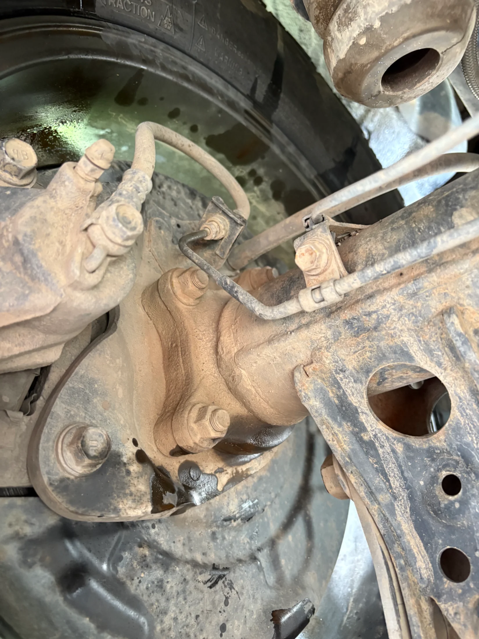

Just got back from a couple weeks in in Colorado over landing in wheeling fairly hard. Wash the truck and then noticed it looks like oil on my fake bead. Locker rims crawled under the truck and it looks like oil‘s being sprayed on the inside of the wheel.
I’m guessing it’s gear oil from the diff. I need to get the truck down to my shop which is 120 miles from my house wondering if I should make that journey as is or if I really should take it to a local shop?
You don’t need to guess about gear oil because it such a strong odor. Does it smell like gear oil? Maybe a bad seal ? You’ll know more if you remove the wheel. I don’t think it’s any problem at all going another 120 miles to a good shop.

If it is gear oil, first check to make sure the axle breather isn't clogged. If it is clogged, it can allow high pressure to build up in the axle, which will push oil out of the seals.
If the breather is working properly, the seal probably went bad. Check the wheel bearing for play and parking brake shoes for oil contamination.

If your air locker has a manifold I’d check around it for gear oil. I had an issue with my rear ended breather is it was puking gear oil up at my air compressor. If it’s gear oil it’s going to take the path of least resistance and I’d have to image it would go out the air line before the axle seals. You can pull that breather tube out and try to blown air out of it, that would be an easy way to rule it out.
I ended up adding a purge valve for my locker and running that ARB diff breather to get around the clogged stock breather.
I just found my extended breather tube has come in contact with my exhaust and cauterized it. I’m sure I have some pressure built up in there.
I’m just going fix the breather and see if the seal still leaks. What parts do I need beside the seal if I end up having to replace the seal?

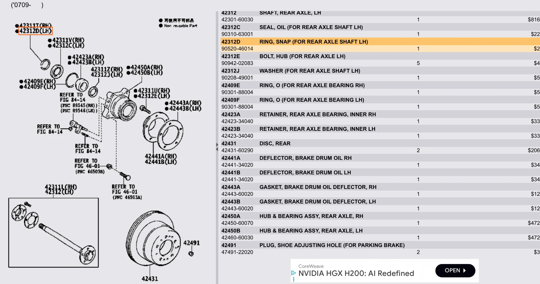

You'll need the oil seal 90310-63001 and the o-ring that seals the bearing assembly to the end of the axle housing 90301-88004

If you want to see what's involved with swapping bearings see this thread.. also has pictures of the above seal and o-ring

I would go with this first. Had a similar issue on my 100 and the 200 now and then gets fluid up to the manifold that drips down below it
I spliced the breather tube back together and pressure washed all the oil off the rim and axle. Drove down to our lake cabin (120) miles and there was a small amount of seepage. I’m hoping it was just residual gear oil that had already got past the seal. I’ll just keep an eye on it for now.
