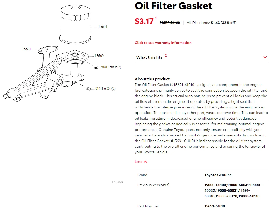

I’m not sure that gasket is available, I read a recent thread where someone made it out of gasket material for that reason.
There are 2 o-rings and 2 copper washers for the two cooler mount bolts. It’s easy to separate from the mount.
Are you referring to the oil filter mount gasket? I hadn't even looked into that one but frankly it wouldn't surprise me at this point if it's NLA. I see the oil cooler O rings and gaskets are still available, so I'll see if I can get them at my local dealer for less than an abhorrent price and if I can I'll just go ahead and knock it out this weekend while I've got coolant drained.
