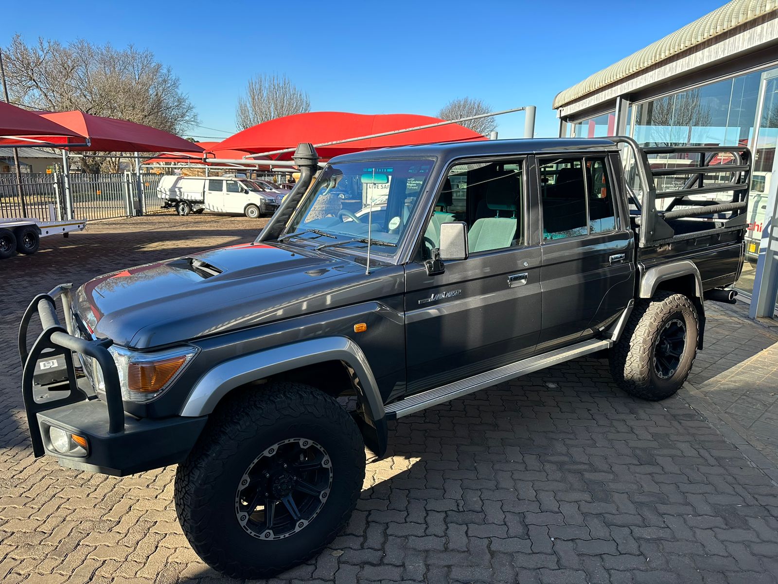

I have a 79 series double cab arriving shortly (pic attached) I don’t like the rims on so will be purchasing some lovely Nomad wheels from California.
The question I have is re. Offset. I just placed an order for 5x Arvos with 0 offset. They have just announced they now have -25 as an option for the same wheel. Should I change my order to -25?
It currently has 317/70R17 Bf a/ts. I really like the stance it has and worried the 0 offset will make it look a little pinched.
Any guidance much appreciated.

yeah, still dont how wide they are, also is your new rig one of the ones with different front and rear track widths? and do you want to make the front and rear width the same? that is going to require front and rear specific offset wheels like in the 55mm range assuming 8" wide

Sorry Rhino, really appreciate the help. Yes, the rear is like 100mm narrower than the front 😂. Due to logistics I won’t have time to wait and see and need to make a decision now. Attached is a pic of the actual rims on website. They said 0 offset will work for me but that was before they released the new options. I guess I could always use spacers to fine tune the desired look. Thanks again.

i dont know either, but he says he wants to keep the stance it has, and to me, it looks like 8" wheels with -25mm front and -55mm rear, or -25mm rear with spacers. its a common combo on these track impaired rigs
