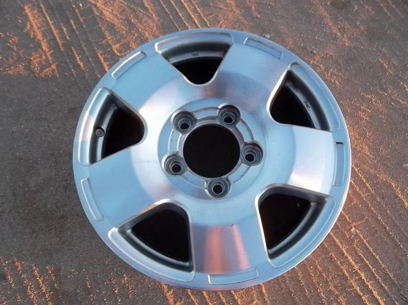

18" Tundra 07+ TRD Aluminum Wheels - 36.4 lbs

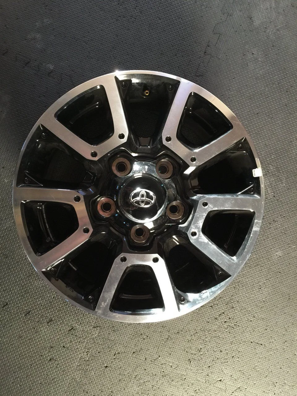

4) TRD 17x8 Rock Warrior Alloy +50mm offset 24lbs (less weight if you remove the fake beadlock rings. I'll weigh those later)

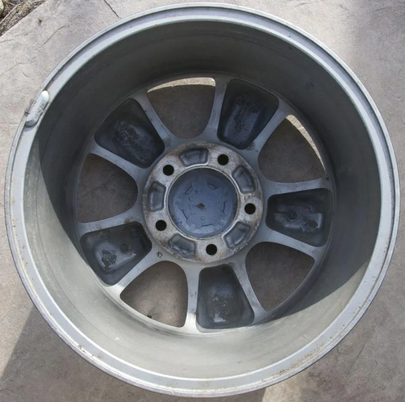

The 18"x8" Land Cruiser wheel as shown weighs 27-1/2lbs on a bathroom scale. This is with the center cap, small lead weight and stem.
The same size Tundra wheel I'm running weighed 29lbs without the center cap...

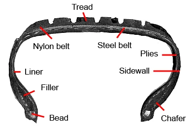

Interesting... for a given width and overall diameter (say a 33" 285 tire), it appears that the tires get heavier as rim diameter gets larger. :hhmm: Is this because of typically increased load range counteracting less sidewall rubber resulting in a heavier tire? In general, it seems that 18" wheel and tire combos will weigh more than their comparable (width and diameter) 16" counterparts.
I was removing the tires on my new '04 to do a lift this weekend, and was surprised by how heavy they were, compared to the 16's on my 2000. The '04 has 285/60/18 Nitto TG's.
For example, a 285/65/18 Toyo Open Country AT2 on 18" alloys is 7-8 lbs heavier per corner than a 285/75/16 on 16" OEM Alloys. Throw it on Tundra 18" steelies and you're about 13 lbs heavier per corner (ish).
I've noticed this too. My best guess is because the bulk of the tire's sidewall weight is in the steel bead and chafer. Chafer is a stiff, thick piece of rubber encasing the bead. The nylon plies and thin rubber in the sidewall weigh little in comparison.
So, 18" rim tires will have an 18" diameter steel bead and chafer vs a 16" diameter of bead and chafer.
