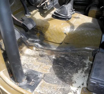

If you really must (I wouldn't), you could spray on some lizard skins on the driver's floor board. The passenger side did not have it. There is also a pattern of it on the tranny tunnel. The MT bracket is embedded into the goop. Edit:

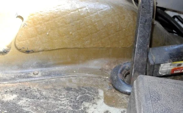

Hard to see, but the insulation goes past the seat bracket, not quite as far down in the back as it goes on the sides.

As you can see, I hate removing it more than I hate it. Wheeling with no mats sucks. It gets about the texture of bubble gum and sticks to your shoes. I"ve got a floor mat I found when we were wheeling that's cut out for the roll cage.
Not sure how you're going to reproduce the quilt patterns there on the tranny tunnel.
