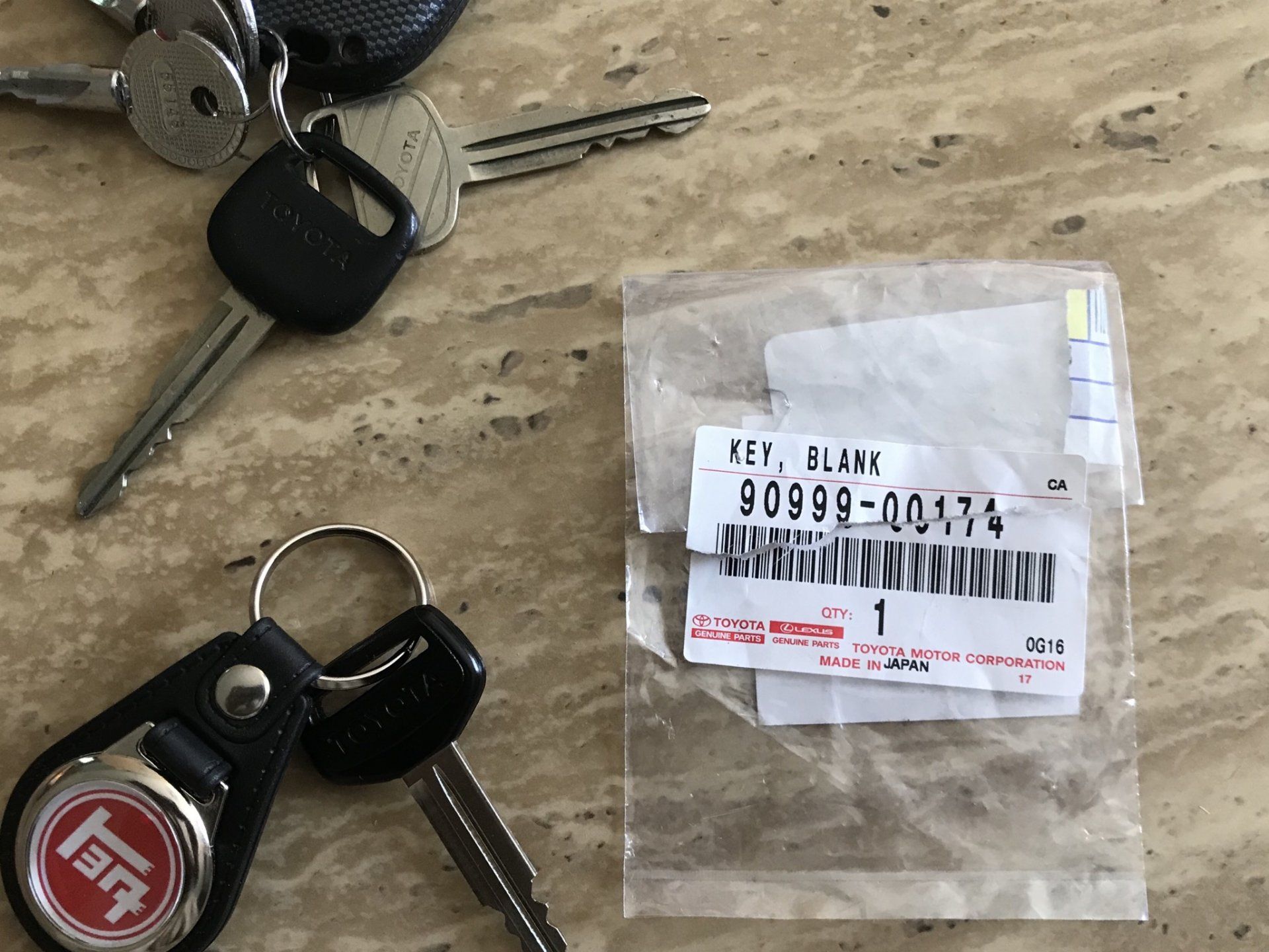

- Noteworthy NOTE Alert : 🚨
- it is my conclusion as of right now , in the last " ? HOURS ? " ...
- the 90999-00163 OEM Toyota Genuine Parts 91-97 all things 80 Series Cold-Spec. / SNOW-VERSION Land Cruiser Key Bank ...
- has been Disc. / NLA .....
- however , i have only seen this very unique and exact same in kind : Parts Supersession of 90999-00163 to now 90999-00174 play out a hand full of times ....
- i have faq-checked this topic at least a dozen or more times today as well
- the 90999-00163 does NOT come up anywhere as simply Discontinued or out of Production ,
- it has 100% simply changed the part # to the -00174 and use the " TERM " replaces"
- below are current and verified Toyota genuine parts images as today 3 / 30 / 2024 , of 90999-00174 & 90999-00163
- if anyone else has facts based technical input to share here , please do so .....
personal last thought :
- this topic pizzes me off royally
:mad:, yet another example of " Stupid Toyota Japan " decision with no-clue who & what the global land cruiser Community is as there greatest and most lifetime loyal end product users & supporters .......:rolleyes:
