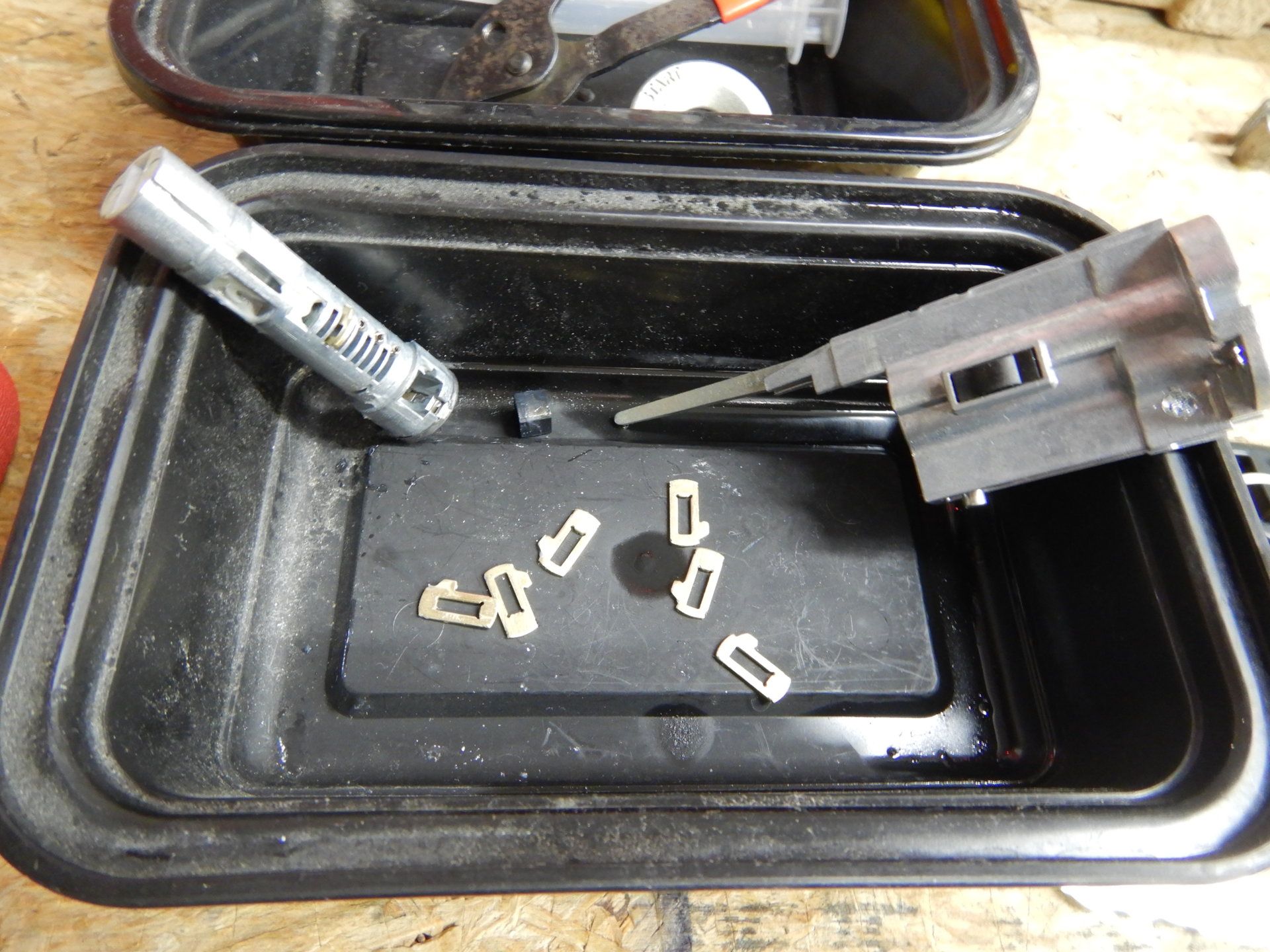

First we Always start out with OEM Toyota parts when ever and where ever possible ........
- Aftermarket brand TOYOTA Lock's from say NAPA or You Local Lock Smith Shop or Ebay South East ASIA stuff simply suck's , Period
- Don't waist your hard earned money on Rubbish ......
- So do ANY hardware style Keys from Home depot or any Locksmith shop , = " Trash " !
- OEM TOYOTA FJ80 Key Blanks are made form SOLID NICKLE Alloy , NOT cheezy Yellow Brass
- next we remove the face cap using a TOYOTA SST Tool
- Then Remove ALL old tumblers and Then insert the New Correct ones
- there are 6 sizes or CODES

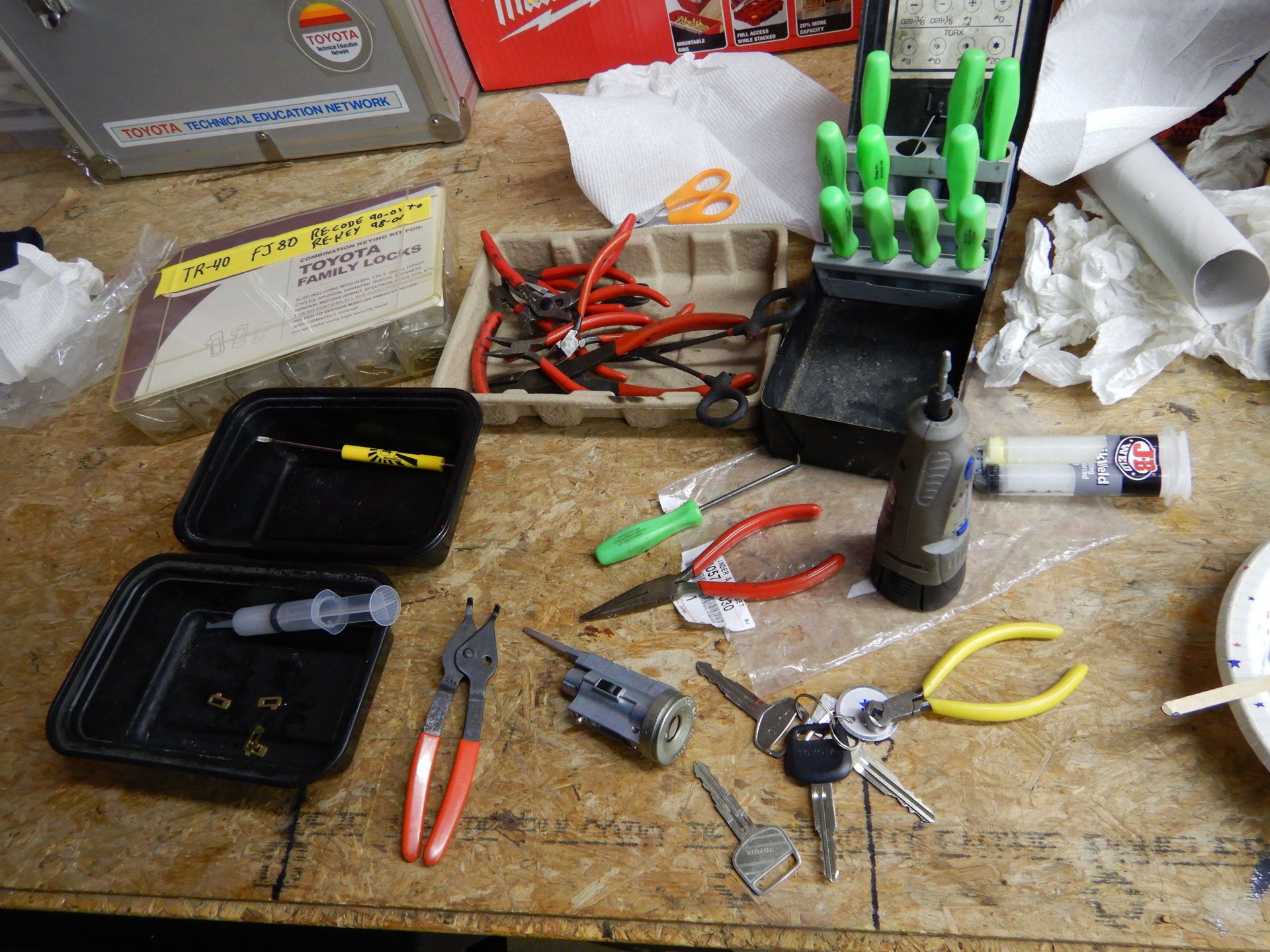

- NOTE: the new ones OEM TOYOTA are color coded
- Tools Required To Re-Key / Re-Code Lock Cylinder
- I then Apply Lock-Smith Grease to the Entire new Assy , them re-assemble the Cylinder Bore
into the Lock Cylinder Housing .....
