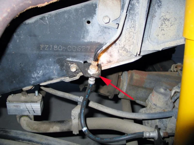

The lines work on a '94. I recently installed them. The only problem is that the front PS (if I remember correctly) does not fit into the retaining clip. I had to open up the hole on the bracket and find my own c-clip, if that makes sense.

Excellent, if you do find the time pics would be great.
thanks
Here is a pict. The line normally fits into a recess in the bracket. However, the front PS line does not have the same shape as the hole in the bracket. I opened it up with a step drill and found my own c-clip to fit. The only bummer with this method is that the line will rotate when you tighten :confused: But, other than that seems to work fine.
I have an idea, for us with earlier model trucks. Is it possible that we could just use the bracket off of a 95-97 truck, then everything would work as OEM intended? I have no idea what this bracket looks like or if it could just be bolted in right where our current bracket is. Maybe there is a picture somewhere.

1FZj80, how long have you had your new extended lines in for? Any line rubbing from the modified bracket? I may end up doing similar.
[edit: forgot, Dan said further up river of this bracket, at the next bracket I believe(?), he said the part numbers converge again. So theoretically you could replace everything downriver of that point with 95-97 and you would be golden.]
