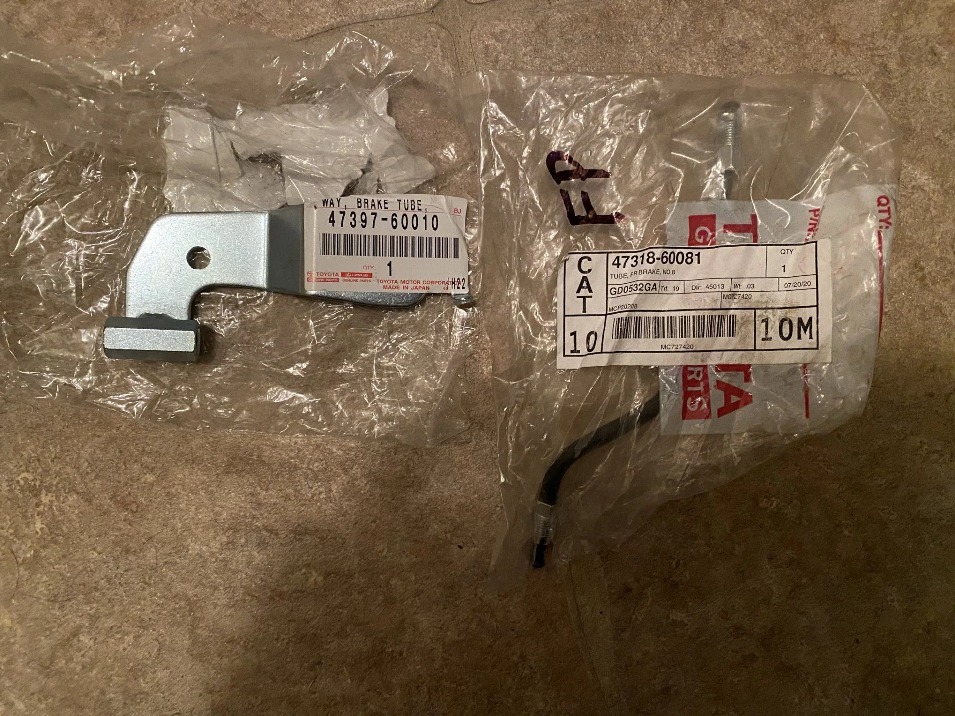

I've posted this before and I'll post it here again. The 93-94 trucks have a different RF bracket on the axle and the extended OEM hose used for the drop will not index into that bracket. I've had to source a bracket from a 95+ truck to use that line. All other lines are fine.
I found this out the hard way and modified my hose on my 93 to index the bracket. That was a bummer.
If you find some time, can you provide the bracket part number? I’m not sure which one it is looking at the illustrated parts breakdown on partsouq.
I just did mine, hopefully it’s the same part# you need.
RF: 90947-A2016
LF: 96940-34605
Rear: 96940-34705
