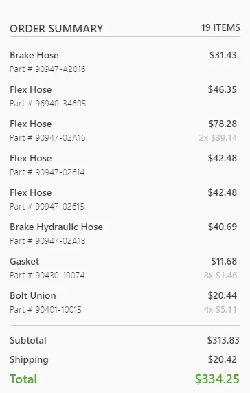

so did you buy 3 of 90947-02A16 lines? I'm filling my cart now... also anyone know part # for the banjo bolts and washers?
I bought 3 of those lines.
90430-10074 copper washers. You need 8.
90401-10015 banjo bolt. You need 4.

Here is what I paid using McGeorge Toyota Online Parts:

Look to spend anywhere from $330 (with discount) to $525 (no discount) for factory brake lines at your dealer. That is assuming tax rate at 9%.

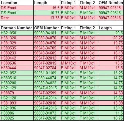

There are numbers that are NOT listed in the chart to give lengths of the original stock length. (90947-02817 RF Brake hose)

Sooo...does anyone know the actual overall length of the oem lines for '95-'97?

OEM purists may hate me but here is the equivalent PN list for Sunsong brand hoses. Been impressed by their quality for brake and power steering hoses for a few NLA applications in other vehicles so I gave them a shot during my brake system refresh. Everything worked out well.
