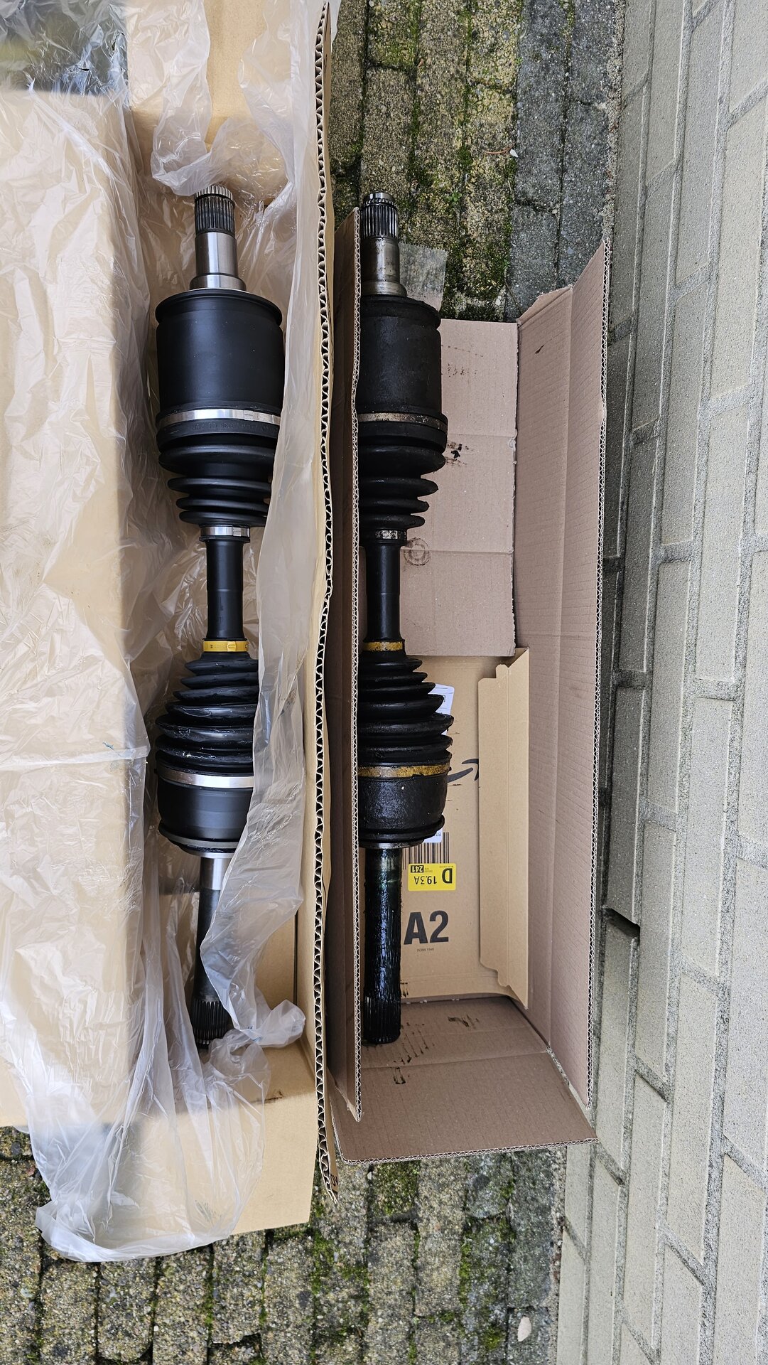

Just had a set of new CVs installed at Lexus. When I checked for the tell tale sign of the yellow bands to make sure the CVS were OEM I found that there was only 1 yellow band on each. Pictures below, however I also got the box that both came in which appears to be OEM. Thoughts? Are these new OEM CVs and they no longer have two yellow bands?
Yep-OEM. They changed to a single yellow band some time back.

For a while some Toyota cv axles had no yellow. I bought a pair from McGeorge Toyota (now ourisman) in early 2023 and they were all silver banded. Here's a post from 2001lc also discussing it.
Yellow bands do indicate OEM, but there are OEM TOYOTA cvs out there that came with all silver banding.

I bought OEM from McGeorge in like March 2021 and they had the two yellow bands. I bought the driver side in Feb. 2022 and it was one yellow band. Hope that helps some!
