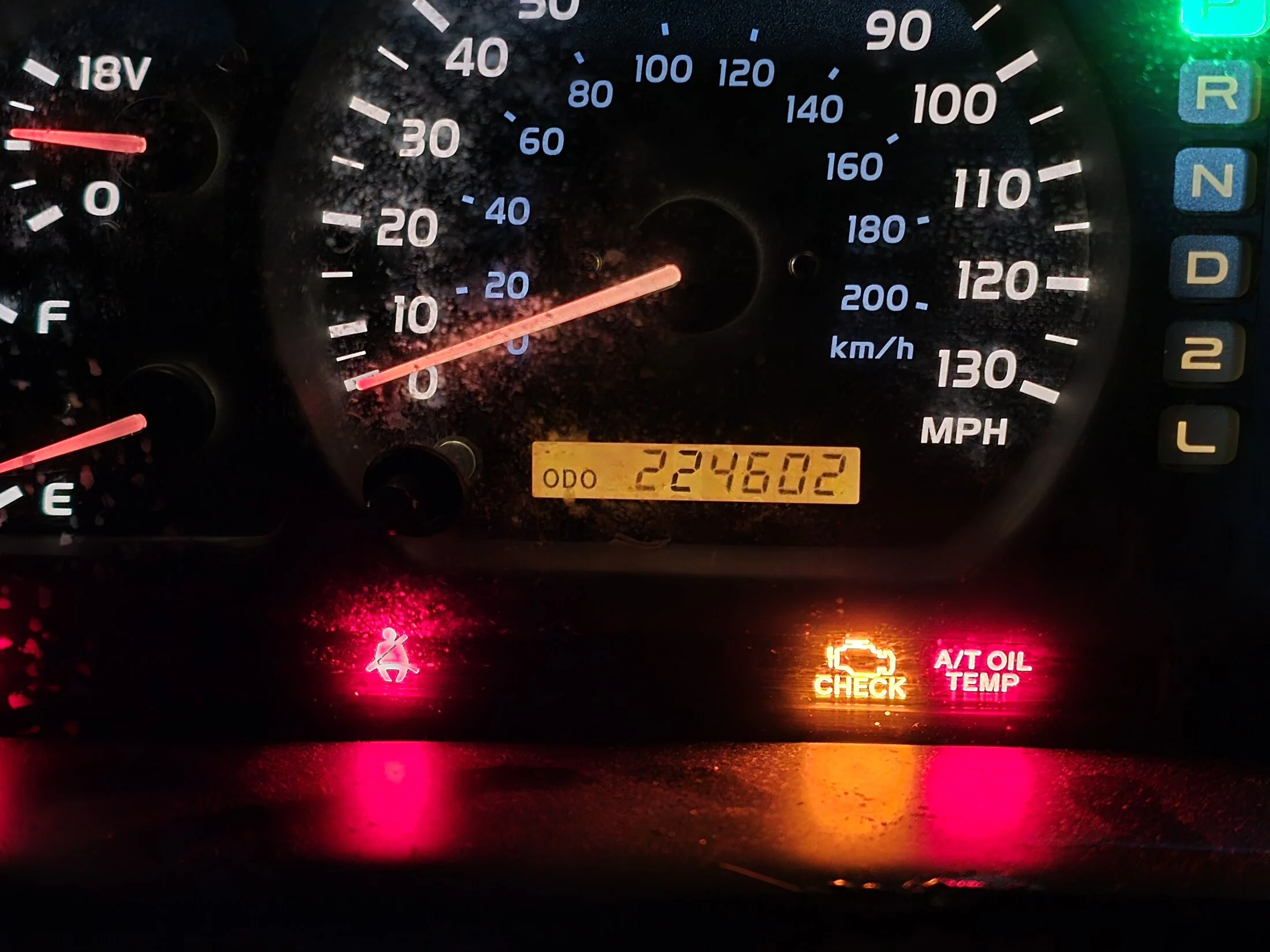

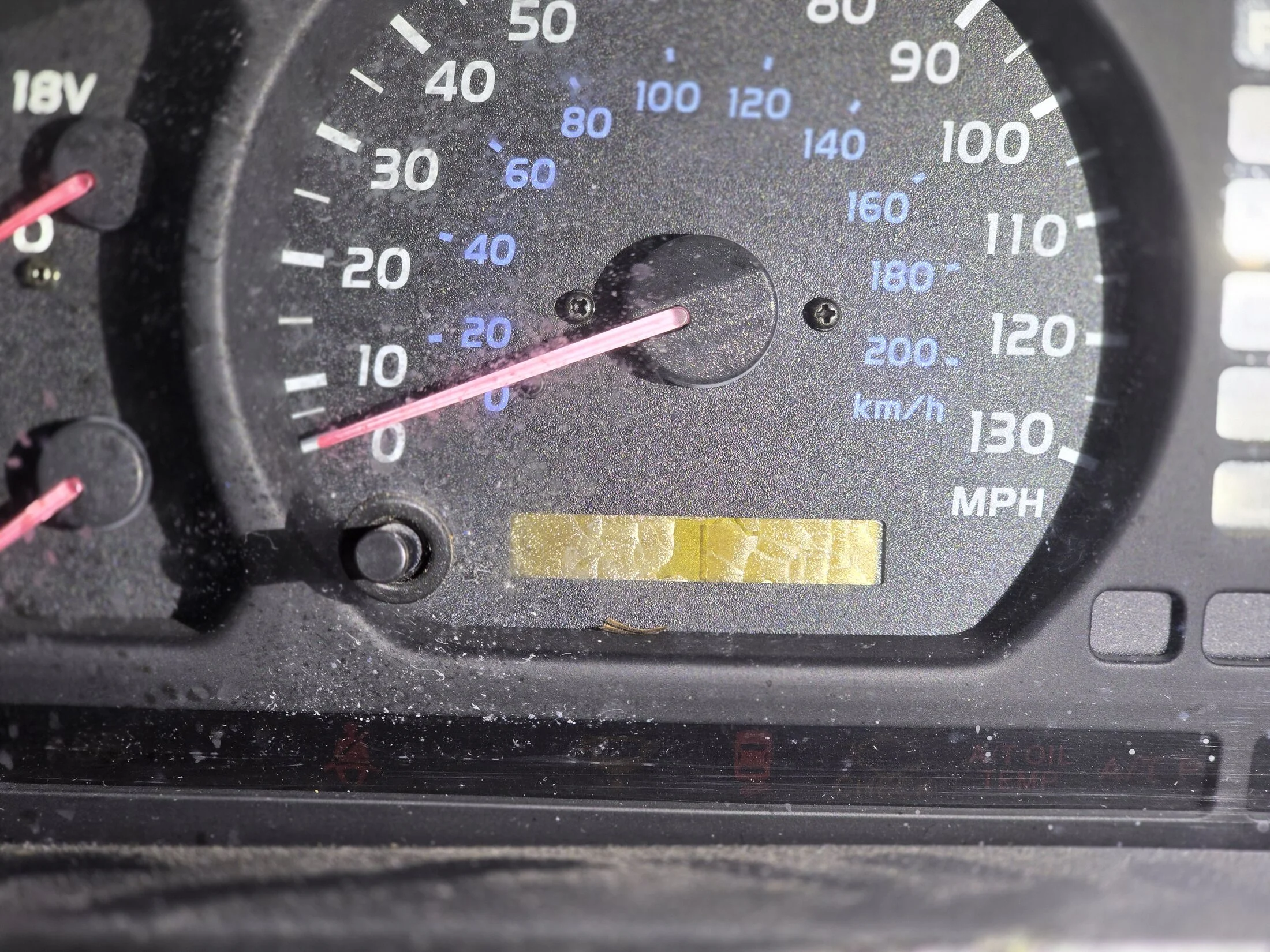

My odometer screen needs replacement, the number portion of the display is "krinkled" up. Is there a way to replace it?
I'm posting pix of my problem. One shows what the odometer looks like at night and one shows what it looks like during the day.
How do I fix this LCD screen?
Night Shot
