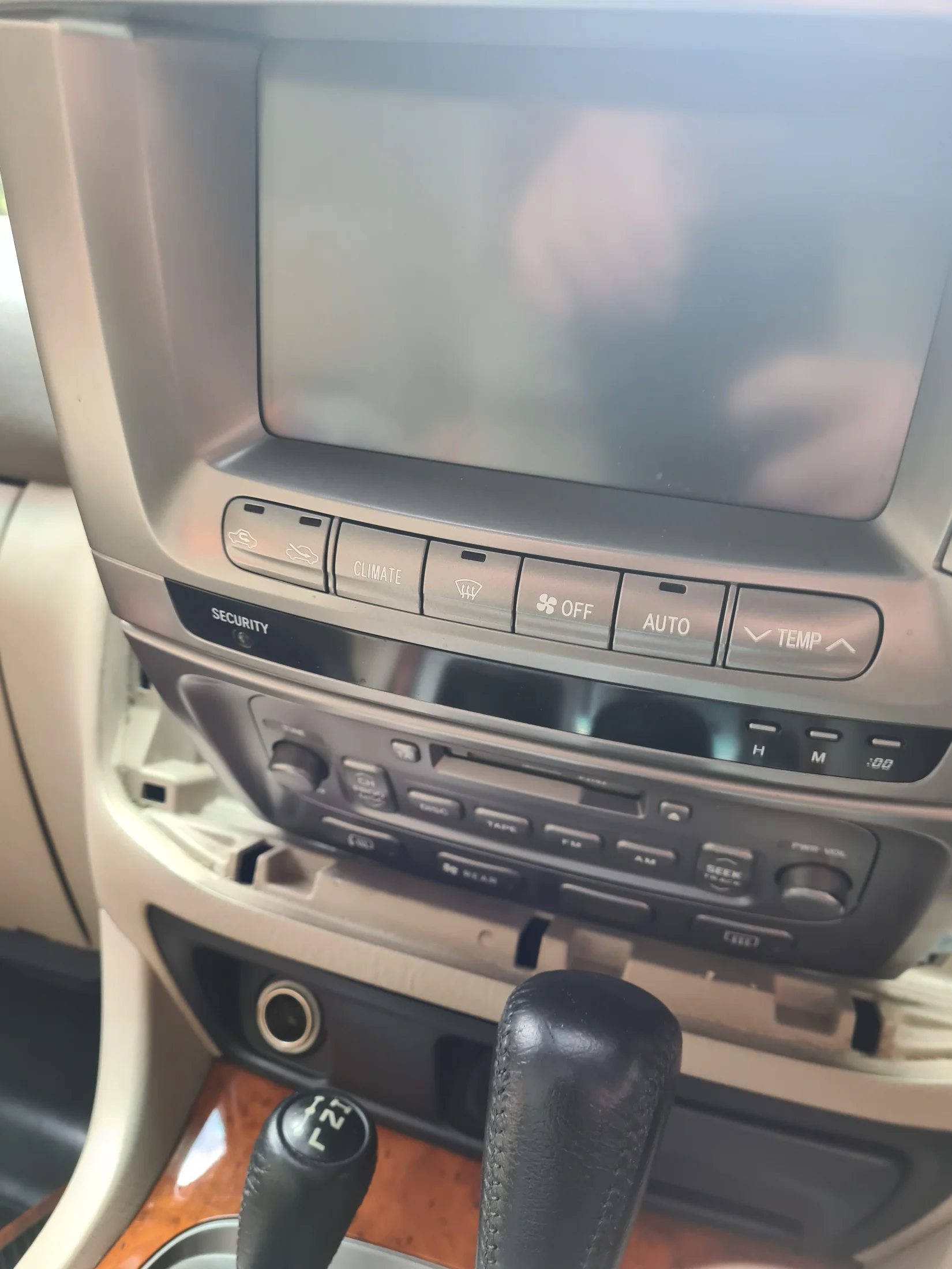

My touch screen stopped working today
Any tips on how to fix it
I’ve checked fuse under bonnet and drivers footwell both ok
Cheers all

Hi all
My 2004 100 series UK spec. The touch screen has gone blank . I've checked other fuses under bonnet and drivers footwell. Both OK
Local Toyota dealer did the same , no idea.
Does anyone have any experience of fitting more modern screen thst will carry out all existing functions and more? Also is there a lexus compatible one

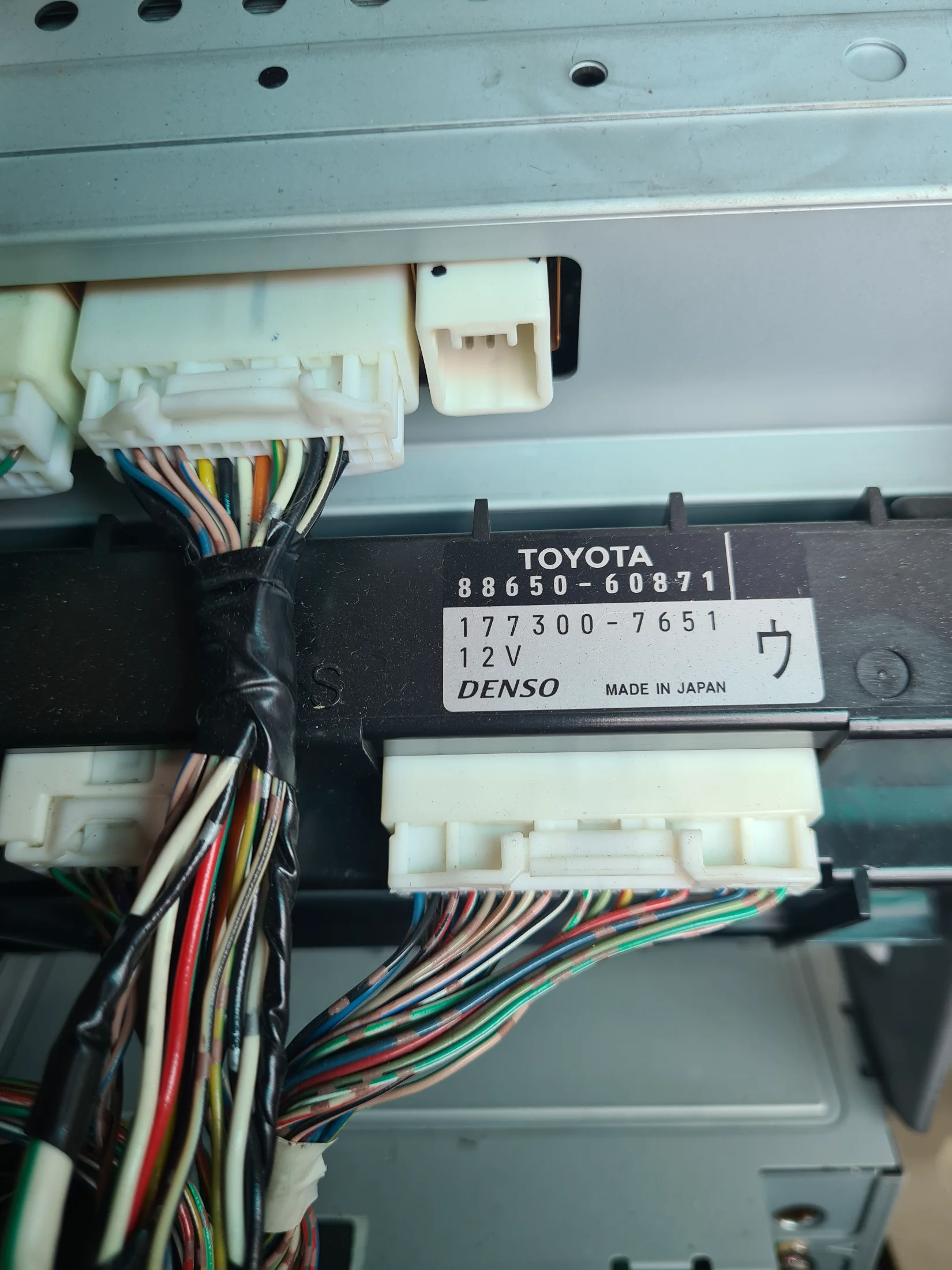

I've hot the screen hanging out of my dashboard. Can snyone help me identify the feed to the screen. I've checked the serial number, but that relates to the ac amplifier.

Did you accidentally turn the screen off? There's a button on screen in the display settings, asking the obvious just in case. I did have screen issues on my 2004 several years ago, was unresponsive – it ended up being a bad Gateway ECU. Tried AC amp and new head unit first but did not fix. There's a thread on this here somewhere.
