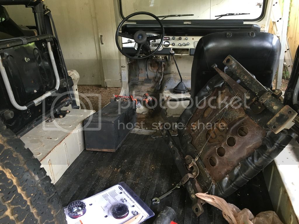

So decided to fix the driver's seat sliding mechanism today. First thing I did was remove the seat then spray the sliders with PB blaster. They were not moving a bit before. I worked them back and forth with a BFH, and eventually got them to slide freely. 40 years of grime, mud, and surface rust had welded them in place.

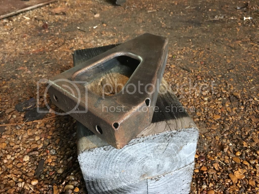

I then decided while I had the seat out, I'd remove the mounting bracket and repaint it.

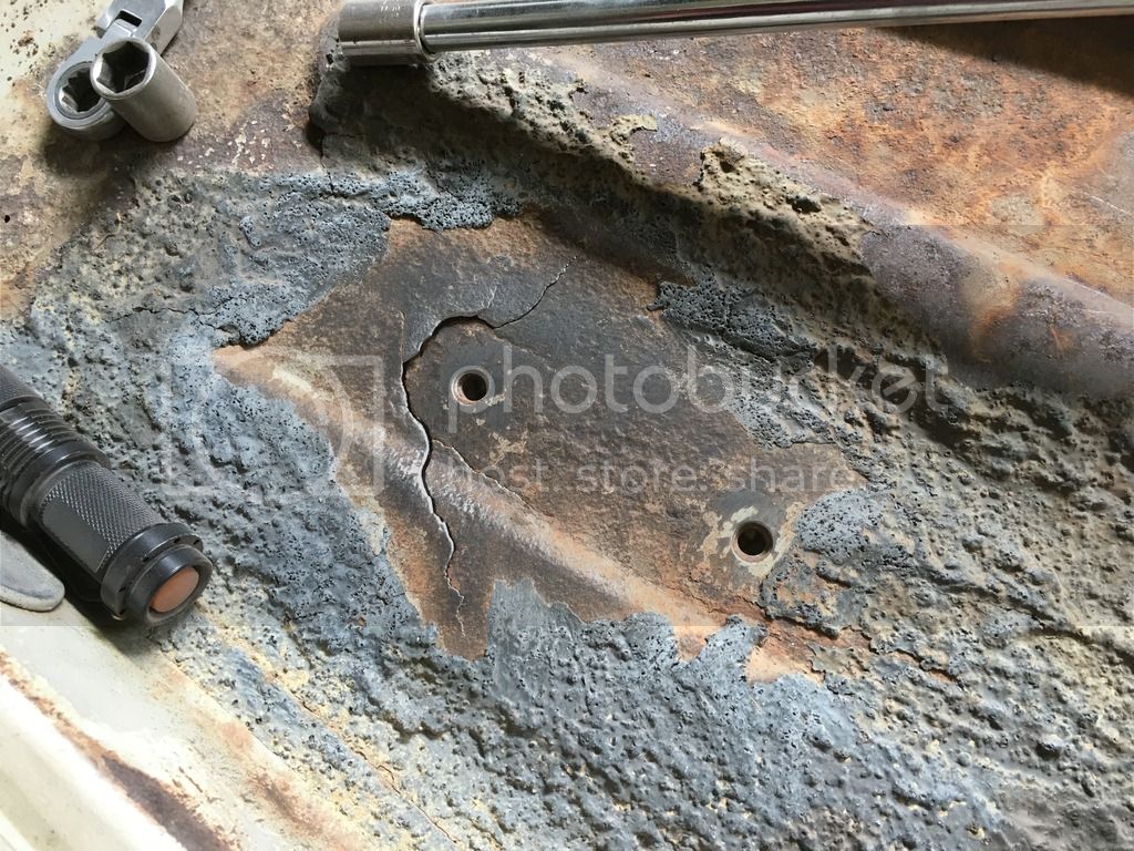

Got my first oh s*** moment when the bracket came out. I found a huge spider crack in the sheetmetal. Bummer!

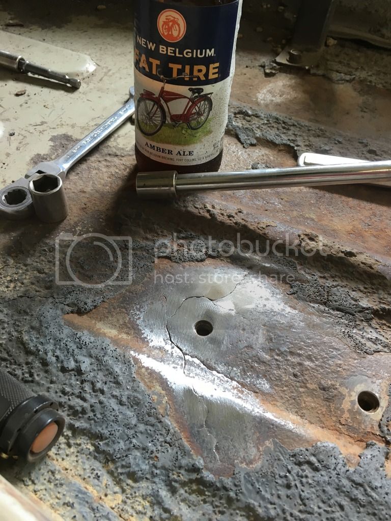

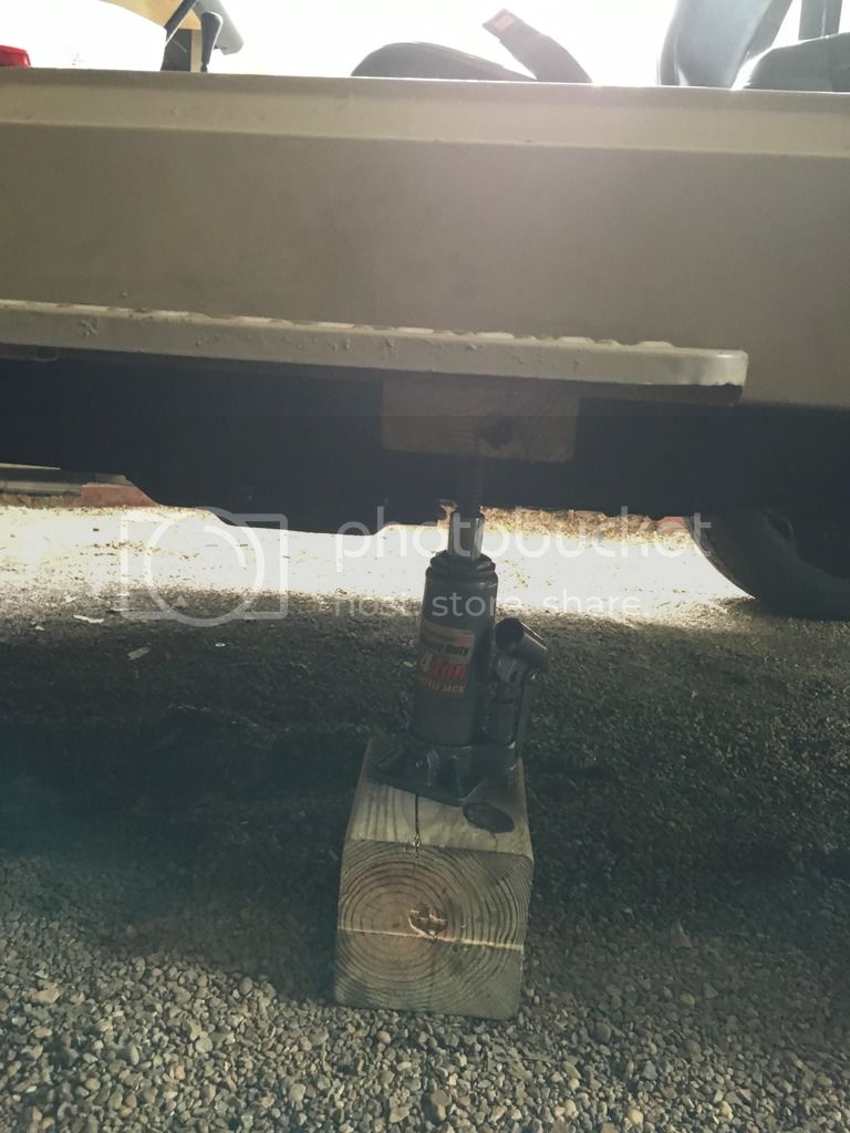

I started removing the old liner, saw that the crack was even bigger than I had first thought. I then put a floor jack under the crack to help close the gaps, and then started grinding it down to bare metal.
I then put a few stitch welds in place. That's where I left off today.
