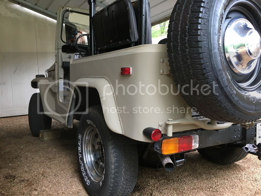

Tan flares:

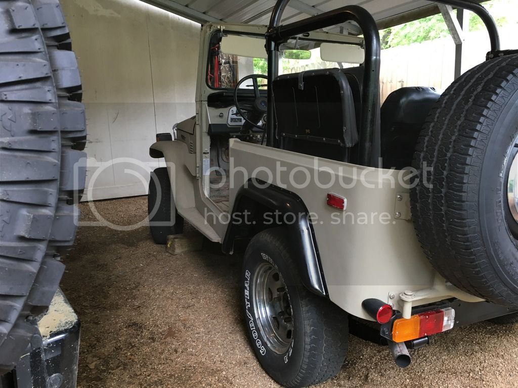

Black flares:
(I hate fender flares, but figured black would look better until I get some new quarters installed.)
