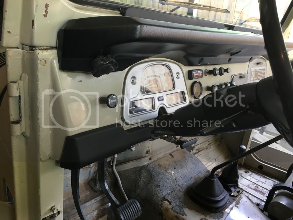

Dash Pad and Vinyl Reconditioning
Before:
After:

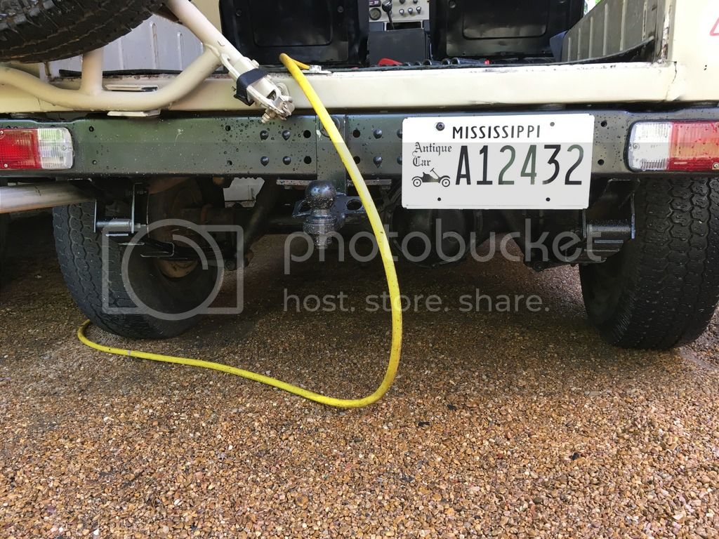

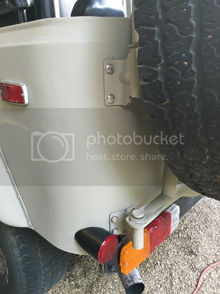

Painted the rear bumper:
Cleaned overspray and rust from exhaust:

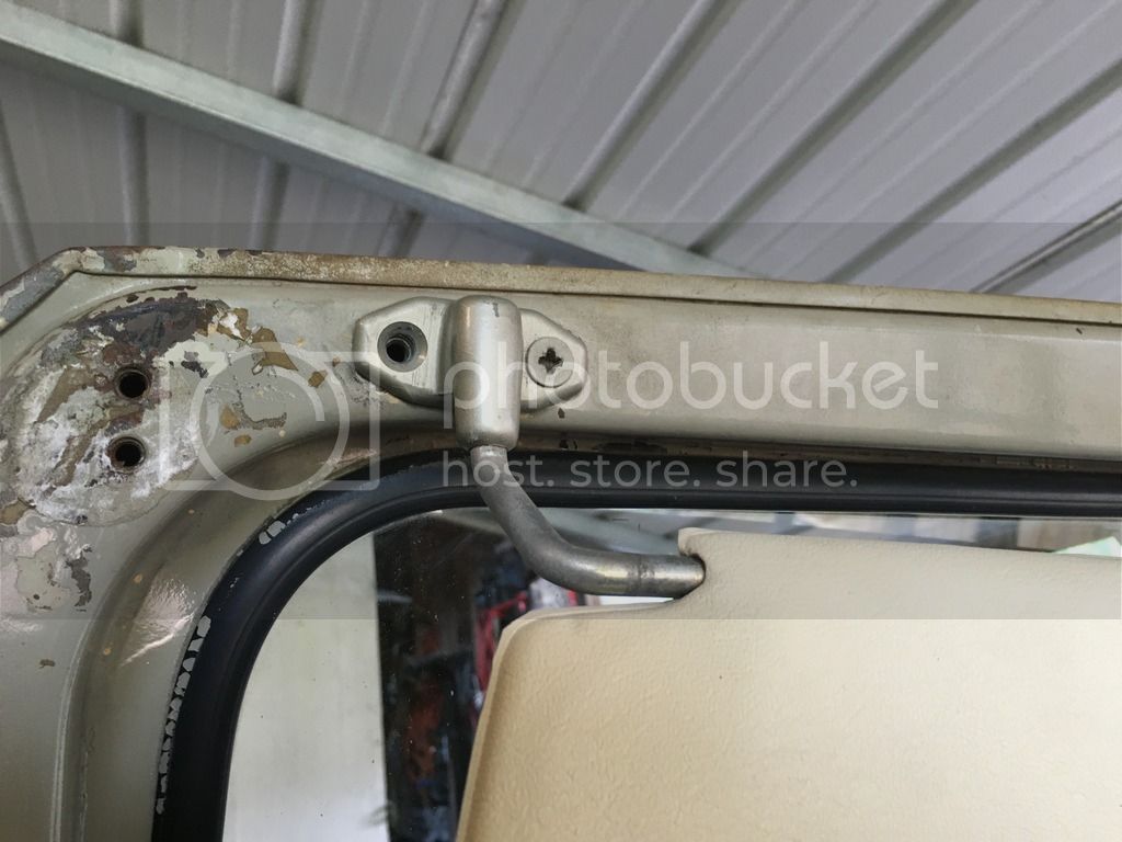

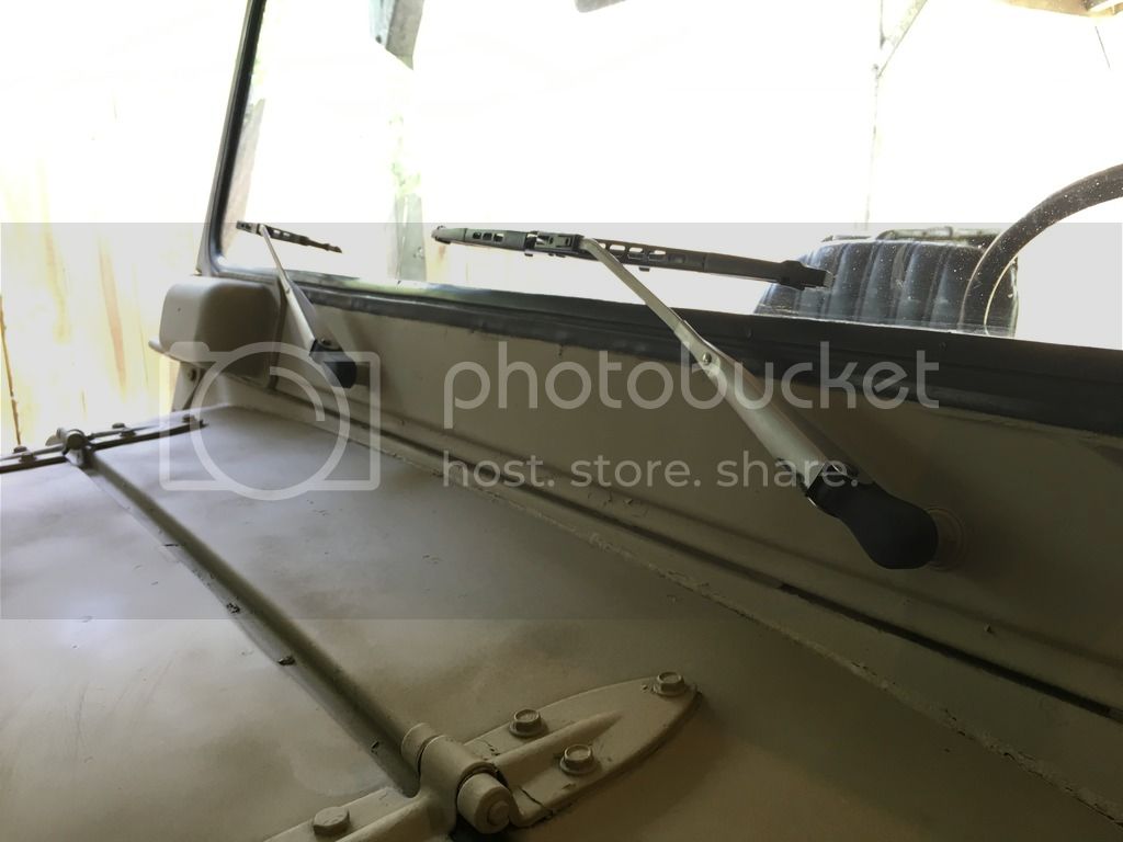

Cleaned up and reconditioned the wipers:

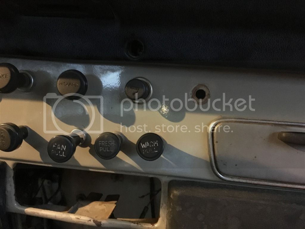

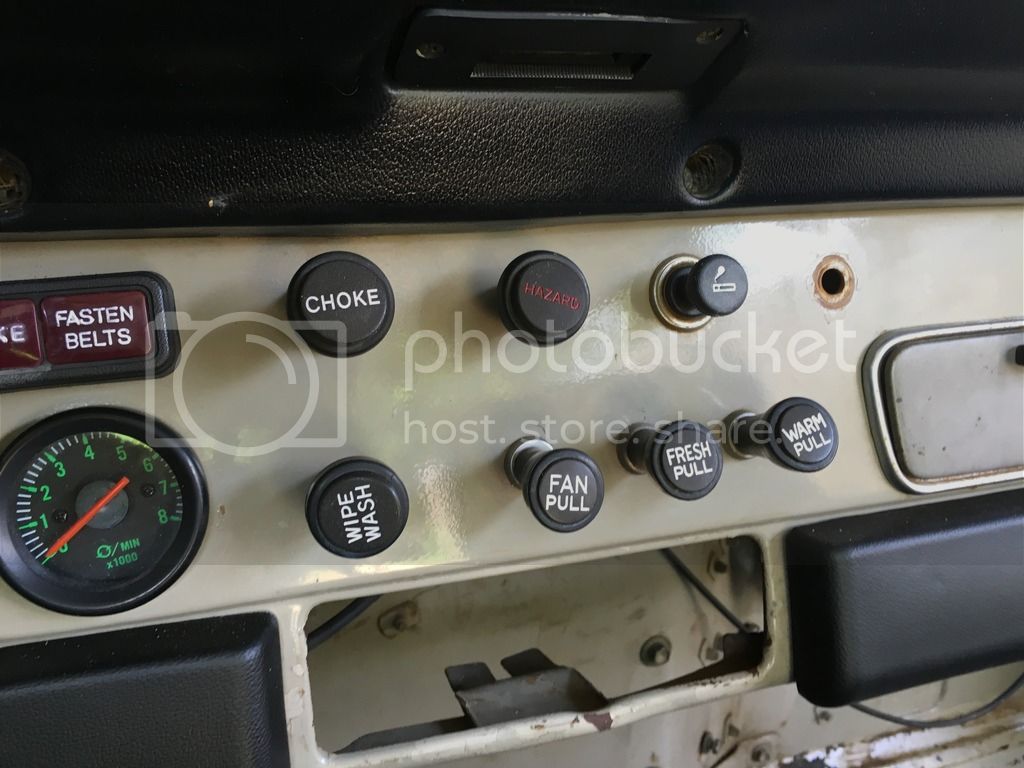

Switches before reconditioning:
Switches after reconditioning:

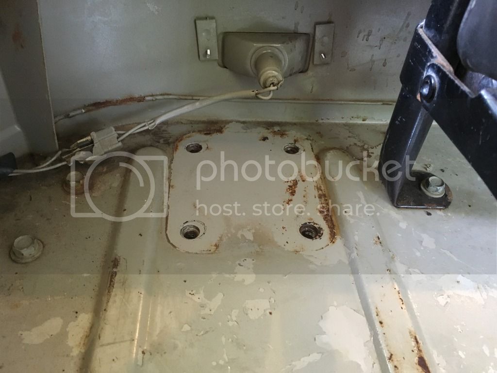

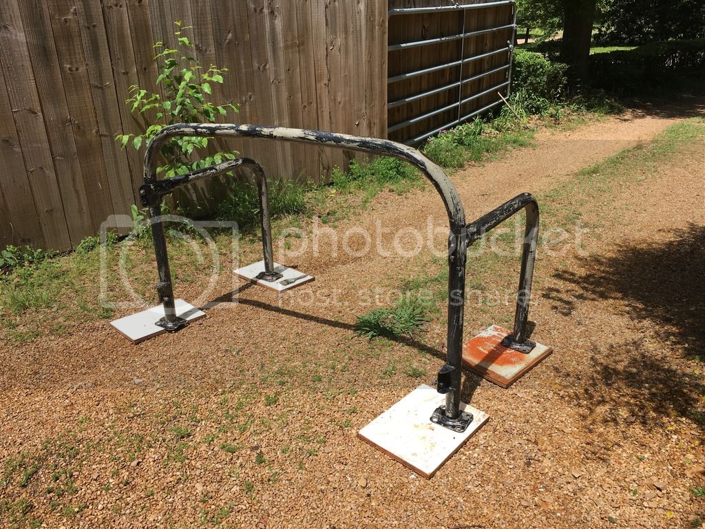

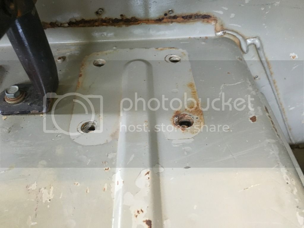

Decided to paint the roll cage black, and was worried about what I'd find underneath the mounts. I was expecting cancer, but boy did I get a nice surprise when I looked underneath...
Not bad, huh?!
And then used a combination aircraft-remover/wire wheel to remove the rest of the paint.
Peanut Butter. No s***.
I didn't believe it when I texted @ntsaint , but after trying it, I'm a believer! It does a great great job.

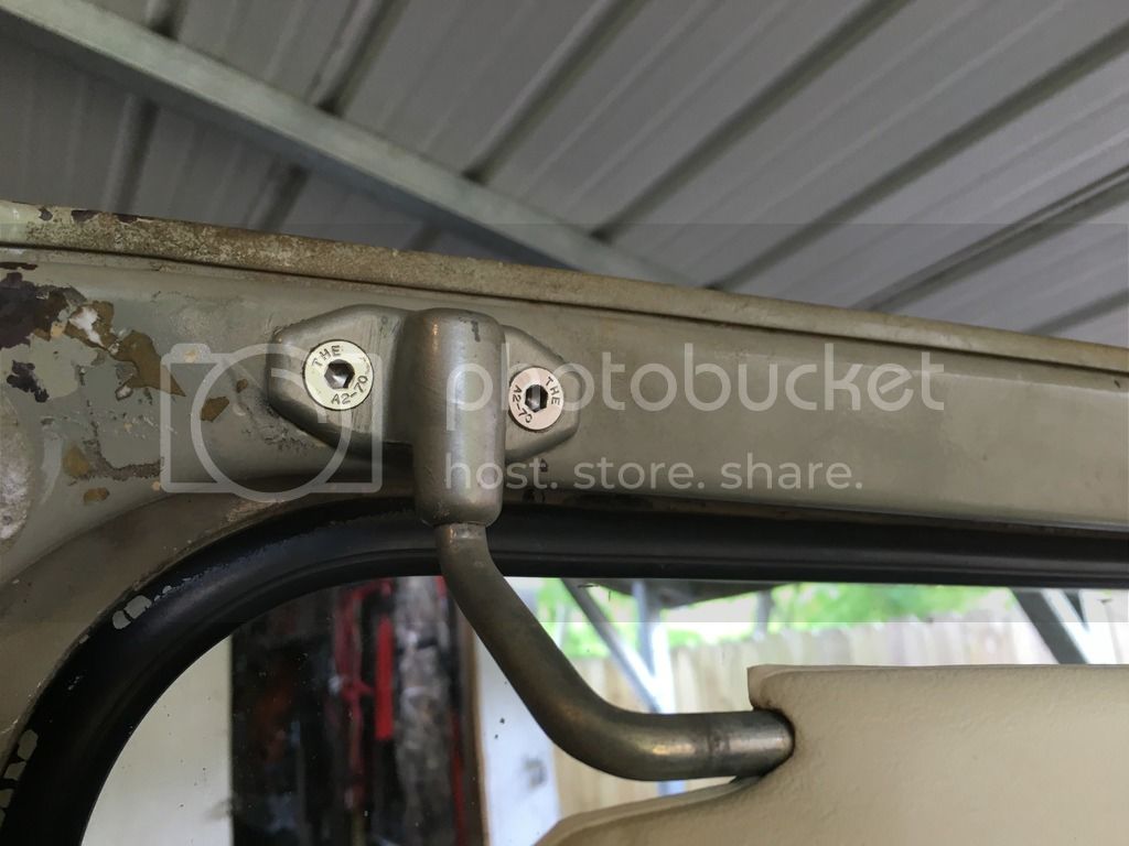

Replacing various bolts with stainless

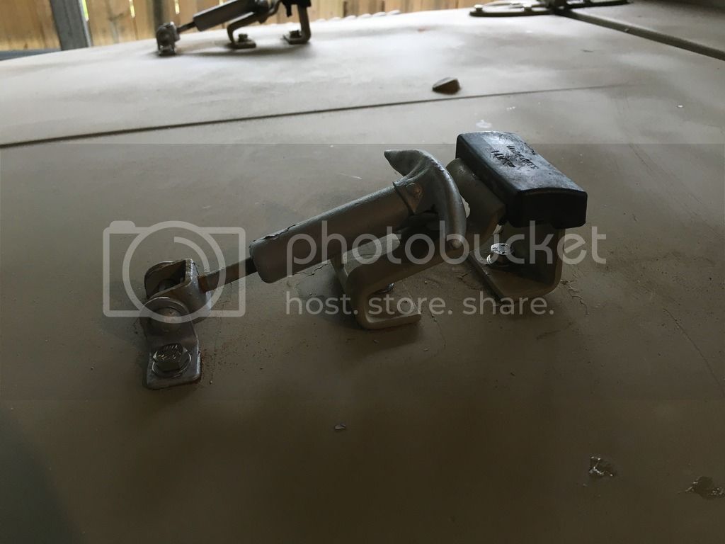

More stainless, and installed rubber hood bumpers:

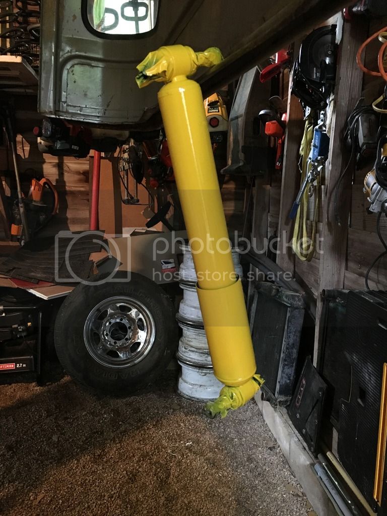

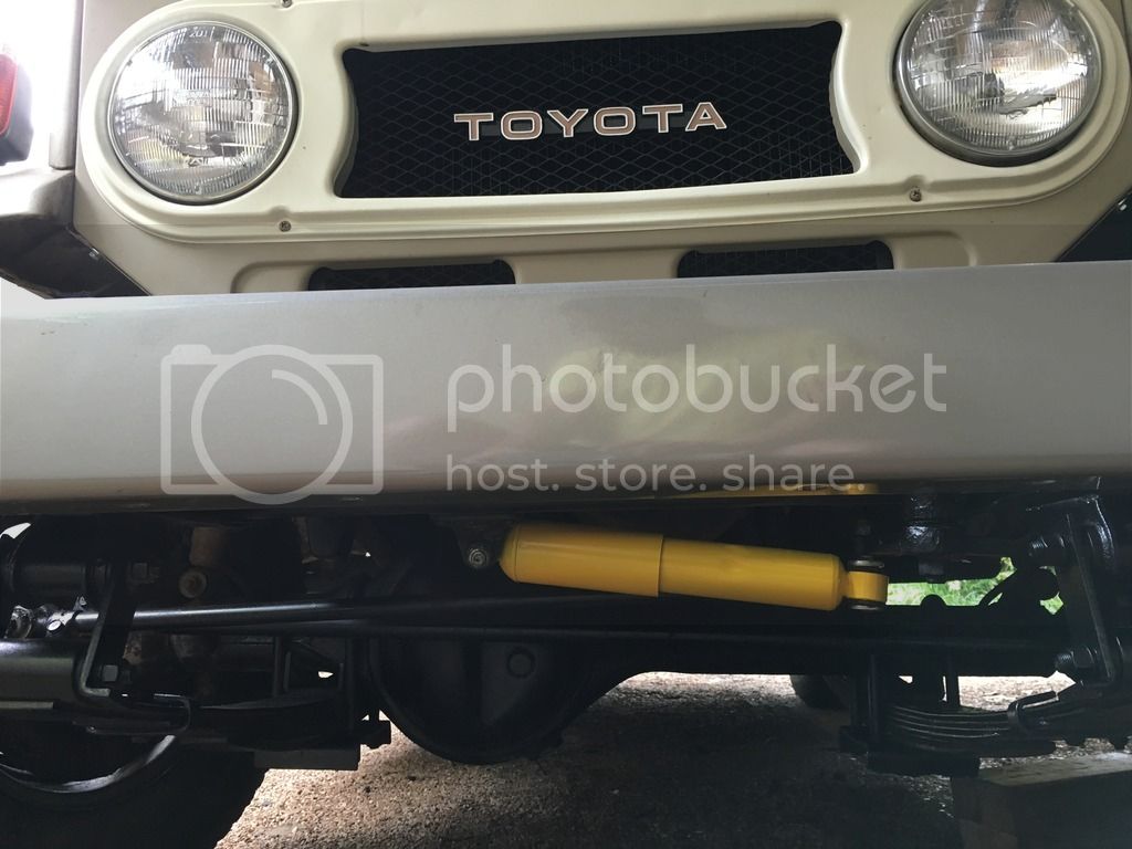

Pulled the front steering stabilizer/strut and gave it a fresh coat of yellow paint:
Installed (notice how well that undercarriage looks with a fresh coat of black epoxy:
I may pull the other 4 struts off tomorrow and give them a matching paint job.

Get yourself some new shocks.....they are like $30 each Monroe.......
If you want to make a difference, pull the spring packs apart, clean them up and paint them and reinstall with new bushings and paint. Get some 33x10.50 radials.....no, you don't need a lift to run them.......and rock out. No need for a lift but the skinny radials make all the difference.
Hubcaps and steelies if in the budget.....
That's the plan @wngrog
33/10.5 BFGs with pewter steelies with OME lift.
