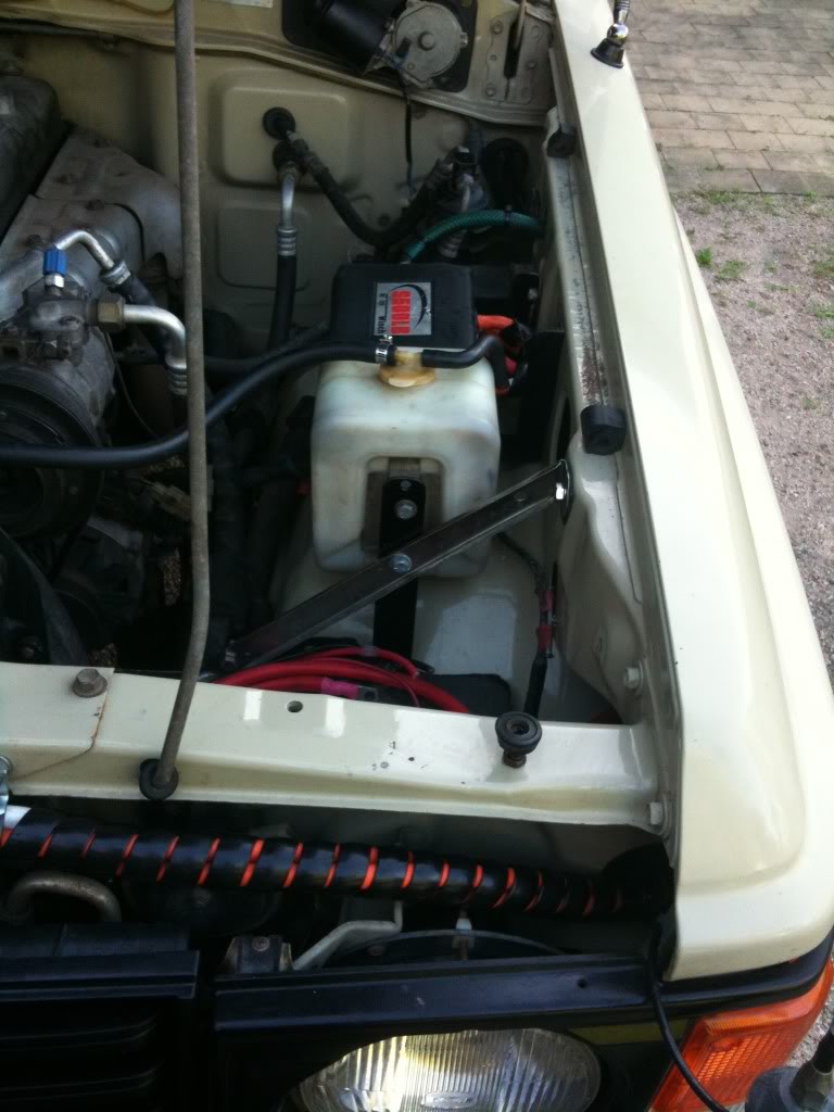

It's going to be the same both sides, but I ran out of the plates that I had for the actual panels, but I'll be able to do these at home. Also the Battery Tray and Overflow Bottle relocation turned out OK.....
The winch controller box bracket will pick up the two bolt holes you can see between the overflow bottle and the relay on the guard wall. I'll have to make another couple of holes and also maybe pick up a bolt hole on the top of the wheel arch as well to help with any weight/vibration issues. The plug for the winch in/out switch will face rearwards and the cable is alraedy run through the firewall. The cables from the control box (once extended) will then neatly go back through the holes in the guard and come out at the battery and also through the front bodywork to the winch itself.

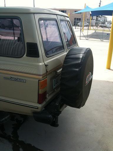

The rear wheel carrier now has an extra reversing light and will probably end up having a rear spottie as well. I haven't decided how this one will work yet, I may wait until I have a roof rack and mount 1 or 2 spotties from there instead.

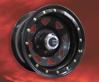

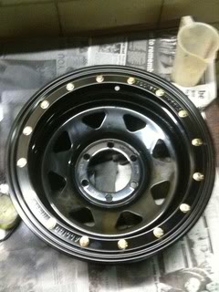

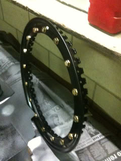

OK, basically ordered the new wheels today, went with these from Allied Wheels called "LockJaw".
They're an imitation beadlock rim for about $AUD $170 each. Dear-ish for a steel rim, but the guy I'm getting them off is going to trade all my old ones in as well as a near new BFG AT tyre that I bought which is the wrong size. Getting back to me this afternoon with what the trade stuff will be worth, so hopefully a fairly cheap changeover. Plus then I won't have to bother with offloading all mine on ebay or whatever....
The other one I really liked was this Baja II (U.S. Wheel), but I reckoned that these were going to be a lot dearer again.

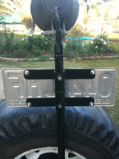

OK, not a whole lot of progress to report, other than it's stinking hot & humid today and I'll have to wait for my wheels to arrive at the end of the month. All I did today was make my new number plate mount - it's adjustable so if the tyre size changes it can be moved up and down.
Hardly worth a post, but it's still forward progress...:rolleyes:

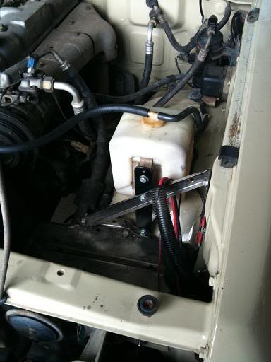

Slow progress is still better than no progress at all, I reckon. Finished making the winch controller bracket finally, and mounted it after re-wiring the controller with HD welding cable. I like this spot as it is protected by the overflow bottle and is nice and high - out of reach of water more often.
Wrapped the cables with hydraulic spiral wrap and used a couple of P clamps to secure it to the top of the radiator support panel. Came up well and is quite solid - only had to drill 2 holes in the engine bay for the whole project, but it took me a long time to get the bracket just right. Only thing left to finish this job completely is to find a spot for the handpiece other than the passenger floor. Thinking about pulling the handpiece apart and mounting the switch in the dash, but there could be some circumstances where you want to be out of the vehicle when using the winch. Any thought/comments?

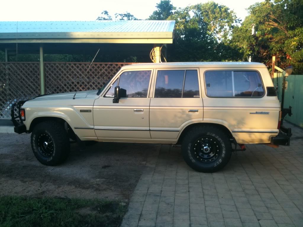

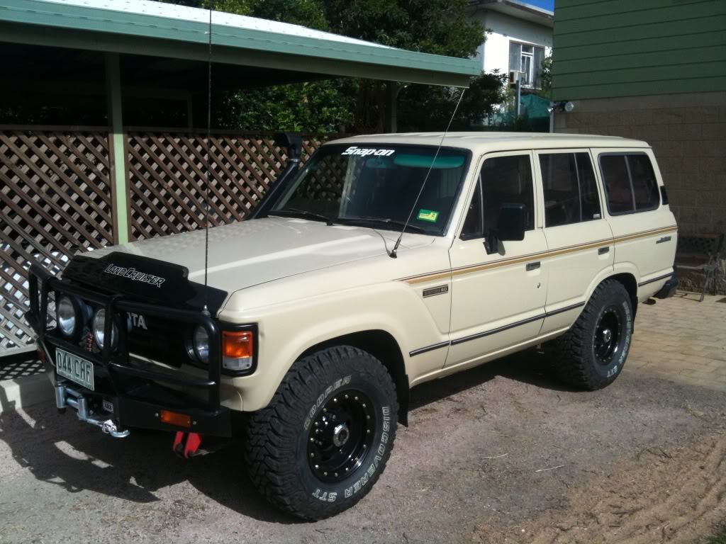

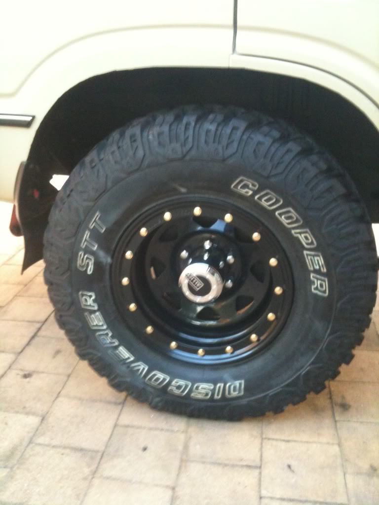

"They're HEEERRREEEE....."
They do serve to illustrate that my suspension is in serious need of upgrade NOW!!! It'll probably have to wait another month or so yet as we are flat out busy, but I am really happy with the look. They are only a fake beadlock - that ring just pops off like a wheel trim ring, but I reckon it looks good, even though it wasn't what I was expecting.
lookin good NQ,love the wheels but yeah ya need some lift.
Thanks GoldChaser, How're you enjoying yours these days now that all the work is done??
I did a few trips around in mine on the weekend and am in love with the new "rubber gearing". I thought that it might be a bit harder to get it moving from a start with the bigger tyres, but it actually seems to have improved that "stammer" that happens when you're in too high a gear. The only other change I noticed was in road noise at highway speed. Obviously much louder with the STT's on, but not till you get up around 100kph. 60 & 80kph they are still quiet.
No rubbing on steering lock-to-lock, but haven't tried flexing it at all. With springs and shocks as flat as mine are, there wouldn't be much point trying really......:doh:

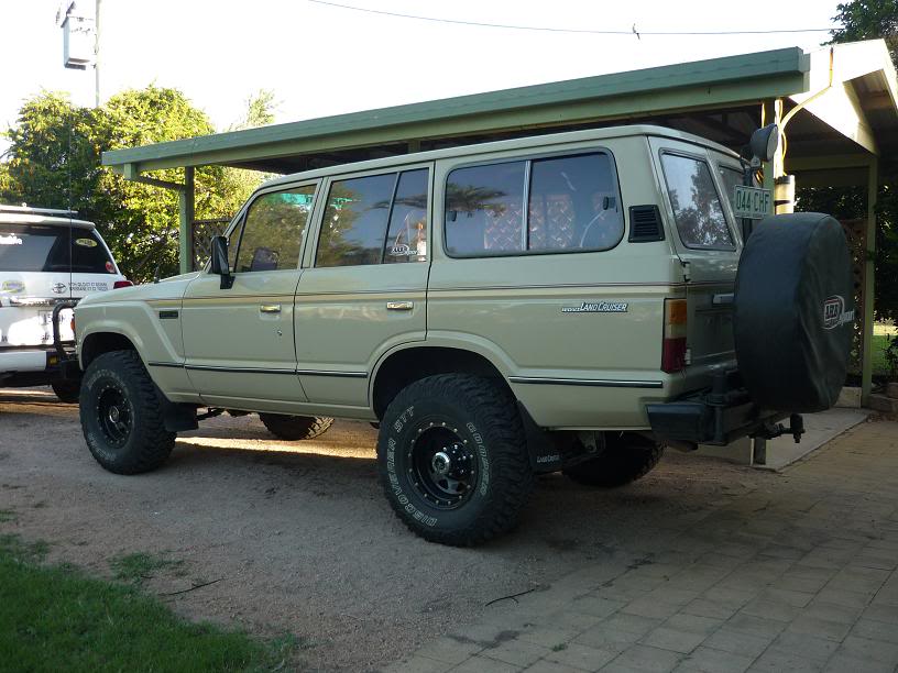

OK, finally got to do the lift that I've been desperately wanting. Went with OME Heavy fronts and OME Medium rears with new shackles, reused the old bushes (only done 4000km) and new OME NitroCharger Sport shocks with OME Sport Steering Damper. Had to wait an extra week for the front springs to arrive, but went and picked the lot up at once and fitted it all with the help of my wife's uncle (Thanks Colin!).
Had to do some slight modification to the upper shock mounting pins on the rear as they were too small for the bushes supplied with the shocks. All we ended up doing was sleeving the existing pins with hydraulic hard line and the bushes fitted perfectly. Had to file the inside of the tube slightly to get them on, but once started the BFH made light work of getting them all the way on. Also had to rotate and re-adjust the collars on the steering links/rods to fit the larger diameter damper on, but otherwise not too many dramas.
For the first few drives I could hear the dreaded OME clunk, but that seems to have settled a bit with a few kilometres. My wife has even been driving it, which in itself says that he ride and handling has improved. Anyway, I hear you thinking "Just get to the pics already", so here you go.....
Started here.....
Now it's up here...
A first I thought I'd been gipped on the increase in height but I was forgetting about the extended shackles, which made it woeful to steer...
Old height again......
and the new, improved version....

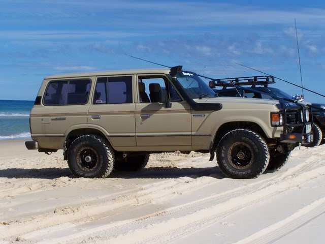

Since the last update, The Chief has done about 4000km of highway driving and about 300km on the beach at Fraser Island. Everything ran really well and had no major issues, except for the dual battery setup. For some reason the main battery now seems to go flat quite regularly and I have swapped the two batteries around, thinking the older main battery might have been on it's way out - no change.
I'll have to start looking at things like parasitic loads and alternators shortly to figure out what is going on there.
Fraser Island was great for the first couple of days until it started raining, but we drank a tonne of beer and had a great few days just the same. I had been worried that as soon as we hit the sand off the barge that I would sink like a stone with all the gear I had loaded up (2 fridges, 2x swags, 7 cartons of beer, BBQ, Gas Bottles, Tents, 2 x Tables, fishing gear and 2 x 40L water carriers etc...), but we dropped down to 20psi on the barge and drove off like we were on the highway.
The tyres rubbed a couple of times right on the front right inner guard as I was dropping in over the dunes and once when we were bottoming out in a washout going over Ningkala Rocks, but I was the packhorse of the trip and had the two fridges running all the time as well as most of the beer and all of the rum on board - this was my guarantee that I wouldn't get left behind if I got bogged!!!!
