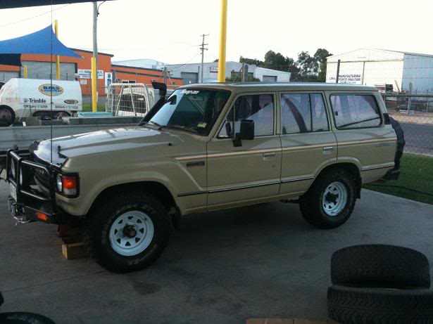

The Globe Bathurst rims were fited to replace some old and mismatched 15x7 white steelies, but otherwise this is how it was driven home from Brisbane, 1350km away. The tyres are 31x10.5 R15's and the springs & shocks are just flat as all hell. On the cards for the next month or so is the OME Heavy spring upgrade and new shocks as well.
Next came the extended shackles, bonnet protector and Hella Ralleye 4000 lights that were swapped off my recently departed 100 series work vehicle. The shackles at least made it look less obvious that the springs and shocks were toast, but eventually they just sagged back to their normal level of stuffed-ness

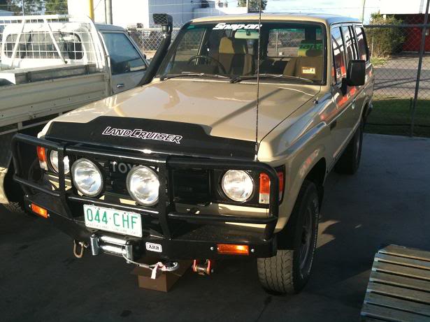

The next major upgrade was the purchase of a used early series ARB winch capable bullbar from a guy in Melbourne (about 2500-3000 km away). Managed to swing a deal that got it to North Queensland for FREE baby!!! Was a little rusty and had a couple of rust holes in it but with some strategic drilling, grinding and welding it looks as good as new and now has the indicator holes it it which the earlier ones didn't have. Also got a cheap 9500lb Moto-Zone winch through the Aldi grocery chain for $500 with 2yr warranty which has been fitted but not wired in yet. Plan is to mount the control box under the bonnet somewhere, so that it isn't out in the weather all the time. Also blacked out the light surrounds, grille and rear vent panels. I have also KillRust-ed the frame and towbar and repainted the rear bumper and fitted a used old-school Kaymar swing-out carrier. I'll post photo's of this once I get the chance.

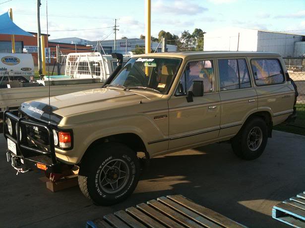

I fitted them on anyway to see how it looks - I did crack a minor horn over the looks so I guess it is starting to look about right. Unfortunately it also tells me that I need the new springs and shocks NOW....
The cardboard box under it is to soak up a small diesel leak from a perished hose, and it looks like the rear diff pinion seal is starting to leak also - I guess now the madness really begins...

As for the indicator holes, the bullbar I picked up was one of two original models offered for the F/HJ 60/61/62 series. From what I can tell, the differences were that one was suited to High-Mount winch appliocations and the other to Low-Mount winch applications. I only realised this when it turned up and there were some gussets in the front of the bar that meant that the Low-Mount winch I had wouldn't fit. MUD came to the rescue for me and I trawled through a lot of images and on-line .PDF's until I found pictures of the inside of the low-mount version and saw that the gussets weren't there. I couldn't see anything that looked like extra support/strenghthening in the low-mount version, so I just cut the gussets out.
Anyway, there were no indicator holes in mine and looking at a few around of various Oz websites, it looked to be a common theme. All the new models have them as standard now, but that has probably come about more through changes in laws than anything else.

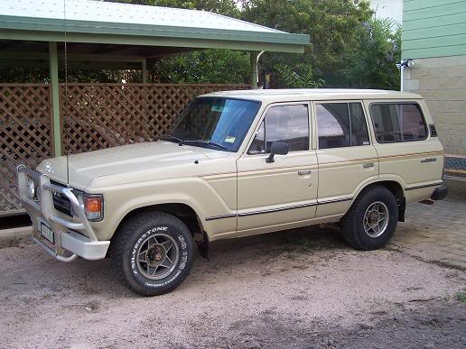

Also, I found the picture of the Chief when I first picked it up in May this year:

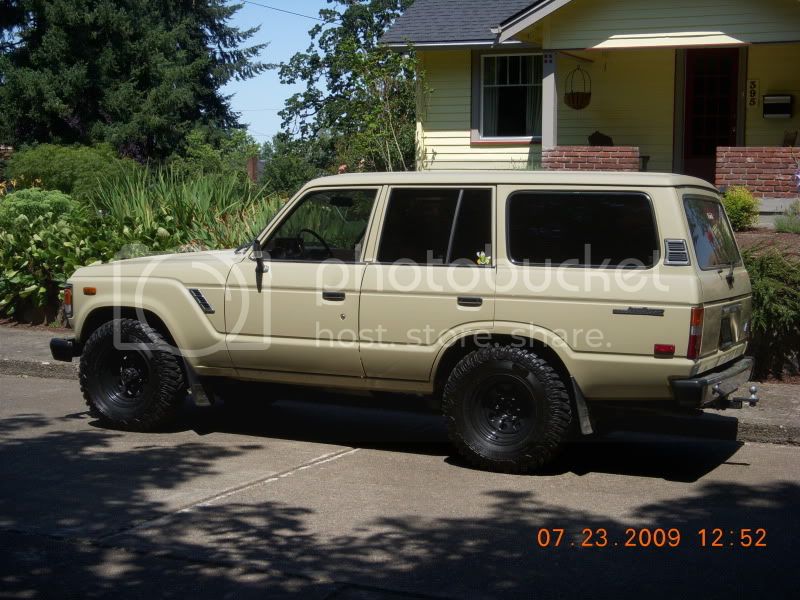

Gotta love the Black & Tans!
By trapper50cal, shot with E7600 at 2009-11-03
Glad I could Inspire/Condone/Justify/Enable a fellow Cruiserhead's addiction.
