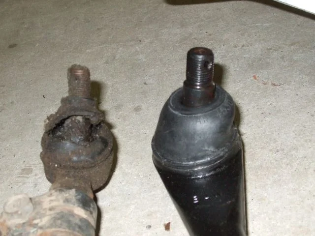

Based on this thread: https://forum.ih8mud.com/60-series-wagons/206974-fj80-tres-sua60s.html I don't think it's needed for a simple upgrade of the TRE's. Churning in the back of my mind is what to do about the drag link. I've no intention of SOA or more than the ~3" of lift that I have now. The reamer would allow adjustment of new hole such that the 80 series ends would work. Be interesting to see how a 60 series end fits in an 80 series hole.
attachment.php
Curious. Got any pics with a clean 60 series in it? The 80 part certainly looks to have a bigger OD taper in that pic, but it's hard to say by how much. The thread that I linked talked of the 80's dropping too far into a 60 hole and even showed a tapered spacer. Maybe I misread what was going on there?

The difference between a Dana 60 and an FJ80 series tie rod is very small. There are a few degrees of taper difference.
The diameter difference between a FJ60 series and an FJ 80 series can be seen in the pics, dirty or not.
What I understood was that while the taper is the same between the 60 & 80 parts, that there is a diameter difference. Oddly it seemed that this was in favor of the 60 parts.
The reamer converts a drilled hole into the tapered hole used by TRE's. How far you drive in while it's turning (slowly!!) determines how big the big end of the taper is.
