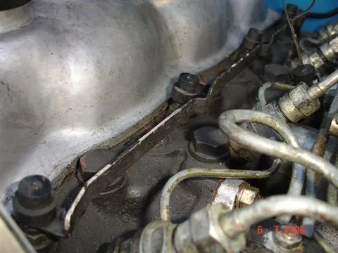

my bar and plug
PIc attached??

You mentioned my "black caps" (elsewhere) on top of my glowplugs Joe - Well I turned them up on my lathe from black nylon rod. I would have kept the ex-factory white thingies - Except the glowplug manufacturers reduced the sizing of the electrical terminal from M5x0.8 to M4x0.7 ---- So they no longer fitted.
Here a photo of an original ex-factory plug with the original white plastic thingie:
And here are the black caps I've got now:

So I think the 8.5V is a wise/cautious choice Greg.
But why try to buy a new glow controller immediately? Are you sure your present one is knackered?
And - Was I right in assuming your vehicle is like mine in needing "glow" for almost every start? (Even when the engine is still quite warm. - Say 30 minutes after it was last running.) - Cos an answer to this of "No" could mean Rosco's suggestion that you also have a fuel problem could still be right.:frown:

...and explains why Drew/Amaurer is getting 10.5V at his busbar. His glow controller has dropped the battery voltage by only 1.5V. If he fitted 8.5V plugs (hint hint) - his glow controller would glow brighter and he'd probably measure 8.5V at his busbar.
x2... I disagree only slightly about the numbers themselves, but Tom is right about the trend; using a low voltage rated plug will cause more voltage to be dropped by the controller, and the voltage seen at the plugs will fall. I don't expect that it will fall enough, however, to equal the voltage rating.
When I had a s***ty old battery I measured about 9.5V at my plugs. Switching to a bigger battery bumped that up to 10.5V. (This is due to the internal resistance of the battery, which drops some voltage too)
On my truck, I calculate that switching to a "6V" plug will cause the voltage at the plugs to fall to 8.3V. Similarly, I'd expect that using an "8.5V" plug would create actual plug voltages of 9.85V.
For your truck, measuring 10.0V on "10.5V" plug, I'd expect that you'll find about 9.38V on a 8.5V plug. I doubt that an extra 0.8V is going to blow up those plugs, in any case.

This is why I feel so "at ease" about talking to you and making suggestions to you Drew. You don't blindly follow what I say and instead you think everything out for yourself.
Sorry for prodding you and Joe towards 6V plugs - If you'd followed my prodding and done it - One/both of you could well have lost an expensive/irreplaceable glow controller! I blame the EPC for that :D.......... Yet I don't learn do I? I'm now prodding you towards 8.5V plugs . He he he. (Perhaps this is all part of a cruel plot to stop you people from stealing our kiwi cruisers?)
I think you have a sounder electrical knowledge than me and I see no reason at all to question your calculations. (They look fine - based on my limited electrical background.)
But wouldn't it be interesting to experiment to see how far off "your calculated reading" may be from "reality". - You gotta admit there are unknown variables here. For instance the resistance of the glow controller coil will actually change somewhat depending on how hot it is.
And where in the EPC does it even remotely suggest you should be running 10.5V plugs Drew? -At least the part number (19850-68030) for your vehicle on the EPC relates elsewhere (like on my plug packaging/boxes and on my plugs themselves) to 8.5V.
But then I know you have a lot on your plate at the moment - What with metal fragments in your oil. (- Sorry - I have no guesses as to what they're from and I do hope it isn't serious.)
And I do hope to post losts of stuff on my B-engine's compression readings, cylinder leakage readings, glow plug voltage measurements at some stage. (But don't hold your breath because Sandy :princess: is standing over me trying to get me back to "installing the new stove in the kitchen right now" etc etc. ----I know -----Instead - I'm sitting on the computer here :rolleyes:)
But Greg already has 8.5V plugs fitted and at least one of them is stuffed. Each of those things individualy (not to mention COMBINED) makes a nonsense of your calcs this time Drew. :doh: (My fault I know - We're discussing 3 different vehicles in one thread - with many different glow plug ratings being discussed too.)

PS. It is my contention now that we should ALL be running the same plugs (Greg, Joe, Drew, and me) - That is 19850-68030 8.5V plugs - otherwise-known-as ---- HKT PT-104 plugs.
Oh I totally agree! The biggest assumption (and I'm surprised no one called me on it) that I've made is that the 6, 8.5, and 10.5V plugs are all of equal wattage. On the one hand, this makes sense this they're all used in the same engine. Alternatively, however, why use different voltages if the heating capacity is the same? Toyota may very well have used different plugs based on the climate that the truck was sold in, or any number of [now] incomprehensible factors.
If my wattage guess is wrong then all my calculations are worth s***. I just like to banter. :D
Moreover, you're right that the resistance changes with temperature, on both the controller and plugs. The numbers I've been quoting are my maxima, in fact the voltage at the plug dropped by almost a volt after 25 seconds.

PS. It is my contention that we should ALL be running the same plugs (Greg, Joe, Drew, and me) - That is 19850-68030 8.5V plugs - otherwise-known-as ---- HKT PT-104 plugs.
I want to agree, as my low-intensity glow controller has always been a disappointment to me. If there is a better glow to be had, I want it... I just don't want to blow up my controller, useless as it may be. Engineers are notoriously risk-adverse.
.....I want to agree, as my low-intensity glow controller has always been a disappointment to me. If there is a better glow to be had, I want it... I just don't want to blow up my controller, useless as it may be. Engineers are notoriously risk-adverse....
Good reply Drew.
We don't even know whether your "previous-owner" may have fitted a different glow controller somewhere in your cruiser's life.
