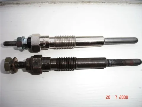

Glow plugs have different voltage ratings. The correct rating depends on what type of glow-control system is fitted to your particular vehicle.
Not only should you have compared your old and new "plug dimensions" - but you should also have compared their "voltage ratings" (stamped on each plug).
Mine are 8.5V plugs - You may be able to read the writing on them here:
(If someone else fitted your plugs - Then you're relying totally on their competence/experience to have done this.)
My experience is that internet-vendors (and their selection charts) often list the wrong plugs as being suitable for particular model cruisers.
If their voltage rating is "below spec" they are likely to burn out on their first use (or burnout your "glowcontroller). And if "above spec" - Then they just won't glow.

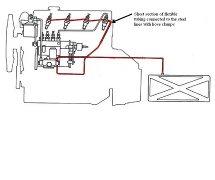

If there were a hole in a fuel line, wouldn't the fuel be leaking also? ......
No fuel leaks out if the leak is on the suction (below atmospheric pressure) side of your fuel pump. That is - all the section highlighted in red here:
PS. This diagram is for the B engine. I have a feeling that the injector bleed line (from the injectors) is run back to the fuel tank on some/all 3B engines (rather than being fed back into the fuel pump inlet as shown here). If so, leaks in that line won't contaminate your fuel with air.

Pulled a glow plug and it was burned through. I mean, warper, scorched metal and the tip was gone. These have been in for only about 3 months. How long does it normally take for glow plugs to burn through the bottom? Do you think I have the wrong ones in? I have the 8.5v, which is what came out of it, and what everyone instructed me to use on a 1981 Aussie 2H with a 12v system. I got them from Roodogs, who seem to know their stuff.
It sure acts like the glow isn't working, so this may be the case.
Should I buy the next size up? Is there a US version that I can buy locally?

No. You must have the correct plugs for your vehicle. NEVER change from the correct specification (unless you've first changed your glow-control system).
Did you lay the old and new glow plugs side by side? Perhaps the dimensions of the new ones were wrong (if the voltage was correct).
Also, choose a good brand. Like HKT. (What brand did you use?)
At least burning-out/damaging your new glow plugs is cheap to fix compared to having a burntout/damaged glow controller.
Crazykritters is another Aussi internet-supplier for glowplugs. And they stock the HKT (Japanese brand).

Yes. The new plugs were exactly the same size as the ones I took out.
OK. So your new plugs appear to have been correct for your vehicle Greg.
