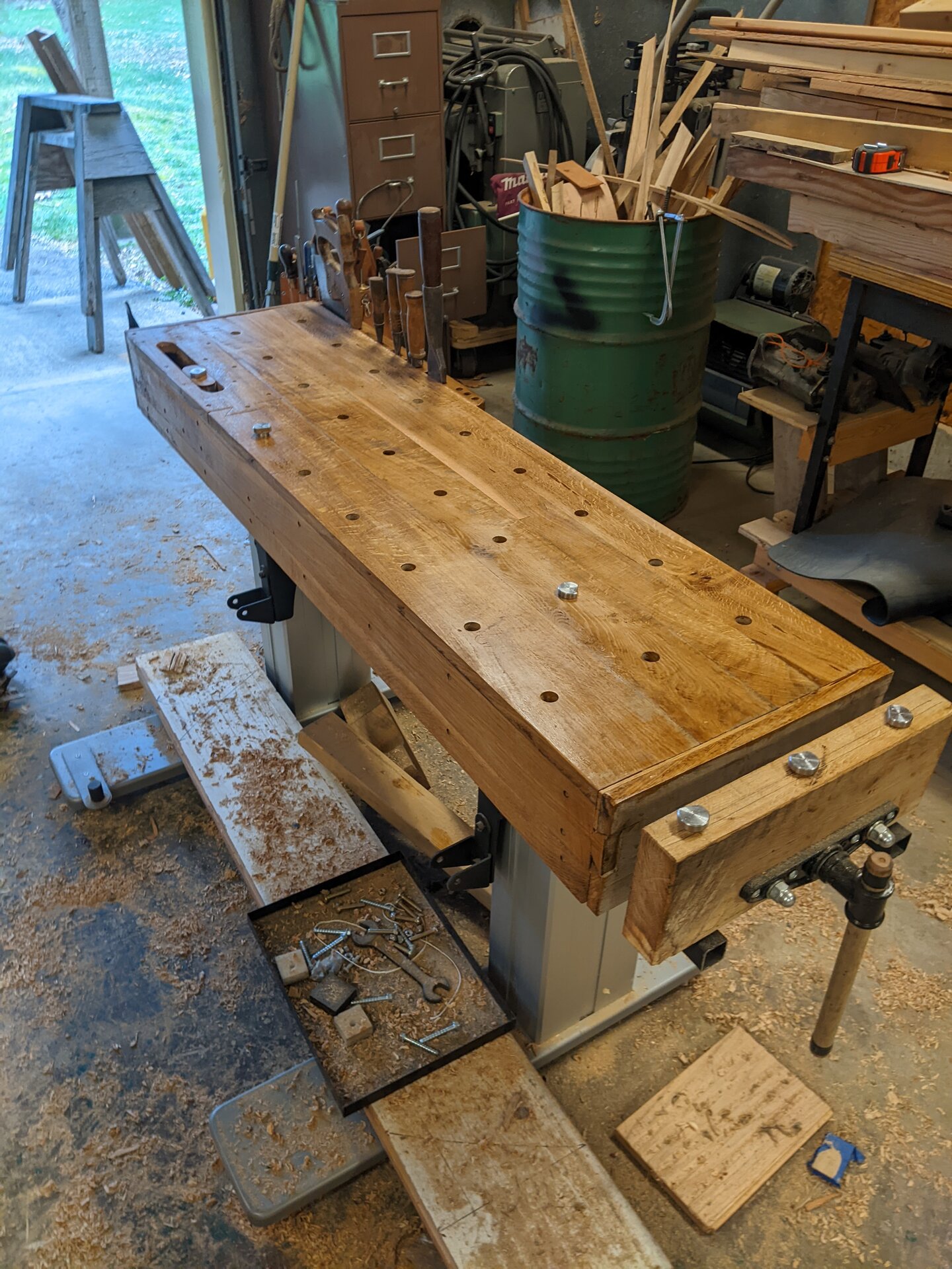

Have another set of those cool powered bench legs, so I'm making myself a faux Roubo bench.
Some crappy oak wrapped around an old chunk of laminated beam. Beam as a core to give it mass so it doesn't bounce around.
View attachment 3282065View attachment 3282066
I'll add a long vise to the side, just not easy to find acme rod and nuts around here. Could use regular threaded rod I guess. Just slow. :lol:
Still need to wire up the legs, and make a little shelf underneath it so i don't lose all those dogs, but it's getting there.

Thanks, should be nice. Clamping weird shaped s*** at comfortable heights will be freakin luxury.
Decided for the side vise, I've never attempted threading on my lathe before so it was a good chance to try it.
Kindof interesting mixing and matching the gears to see what thread counts come out. Looks like 8tpi, a fine thread of some sort ( didn't let it go for the full inch to count lol) and then the coarse 6tpi acme I was looking for.
Should be a 4th option too. No idea what that might be...:hhmm:
Really need a follow rest for something this long, but it worked ok. As long as I took light cuts. Some fine tuning to go.
Haven't quite figured out how I'll cut the nut plates just yet, but that's wednesday's fun.

Yeah it was a fun learning process. Slow on a 120 year old lathe but that's part of it's charm lol.
If I need dead flat I have a 400lb slab of steel on my other bench, this will just be nice for small jobs.
Just some wiring and the shelf now.
