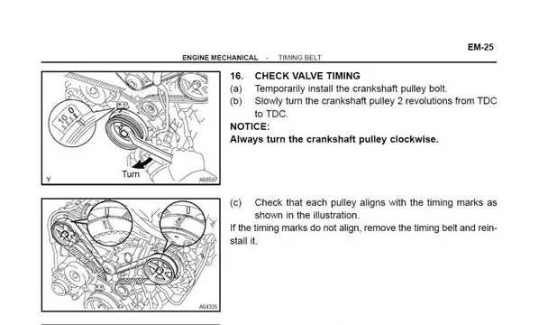

Any chance the previous owner had T-belt done and they have either the intake or exhaust cam retarted by just a tooth or two. I'm new to the 100 series but was a tech for 16 years and have seen a few belts installed with the exhaust cam retarded a tooth and for the most part the engine runs ok but under load lacks power.

I was thinking about the TB scenario a few days ago too. Could I visually check this by removing the TB cover? The TB was done at 160,000 Kms, the car has 210, 000 Kms. So if this is the case, its been driving around like that for quite some time.

Ok, so next I will pull the TB covers and check the alignment of the belt. Is this a 'drive belt off' job, or can I manage with leaving it on? Im sure I will figure it out when I get to it. It'll have to be next week though as I am going away for the weekend..
