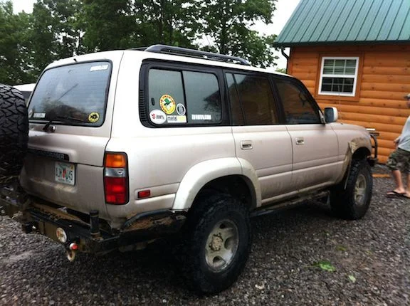

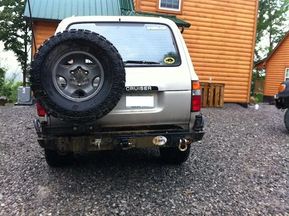

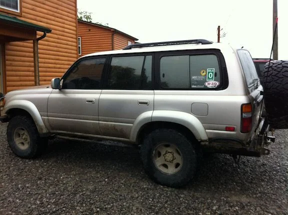

I can give you the low-down on the TJM progressives on a loaded rig.
Following are some pics the morning after a tough trail ride without swaybars. I think the extra compression the removal of the swaybars had contributed to the spring almost failing. It's "better" now, but you can still tell a slight DS lean.
