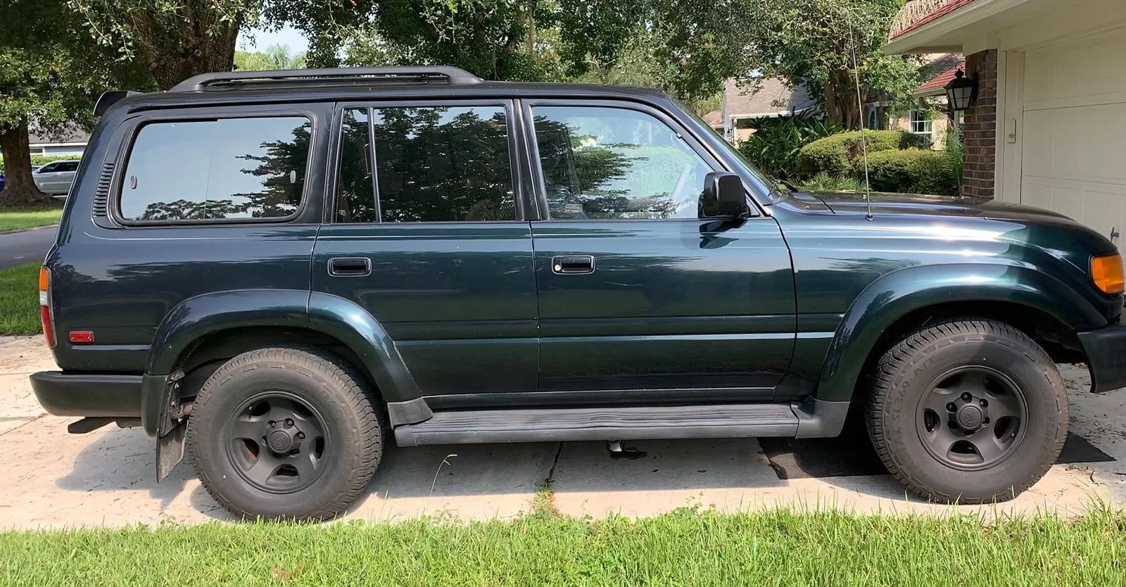

Not a garage queen for sure. The PO had the truck for all but the first year or two. I think he is in his 70s now and this was his wife's car in later years, he said. I've only had it a month or two.
I think the most expensive screw up is the paint job. It looks like select parts of the car got the rattle can treatment likely with no prep at all. Otherwise, it's just neglected maintenance and aftermarket parts that in some cases aren't correct.
First off, does the antenna retract? If not, light it on fire!
Nope, broken.
Just BS'ing, she looks like a very nice 80. Not many 70 year olds paint their wheels for their wife, I'm guessing the door handles were also painted... although I've never owned an emerald green 80, I think they should be color matched. Is that the rattle can part? I like her! Good platform! Maybe a transfercase leak/transmission? Figure out the troublesome codes and enjoy her!
Yeah, I think he did that a while back when it was "his" car. Even the spare wheel is painted. Well, assuming he disconnected the MIL bulb, I can't believe anything he told me but I am skeptical of everything regardless. The only thing that seems true is he didn't use it as an off-road truck. Especially with these China-bomb tires.
The rattle can was used on the hood, hatch, and around the rearmost windows. There's black drip marks around them and pretty much everywhere he painted.
