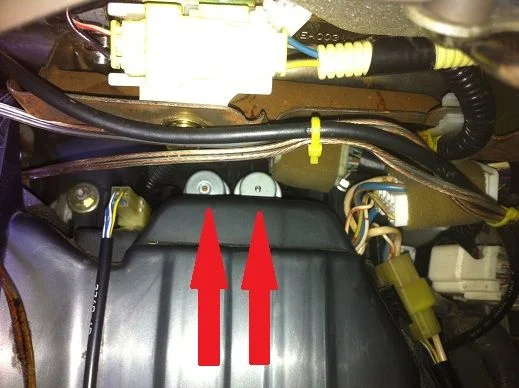

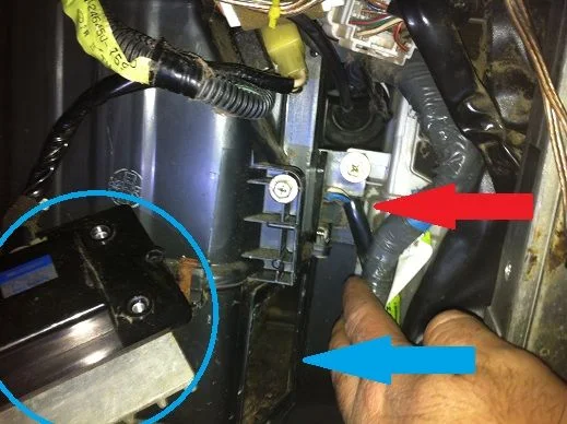

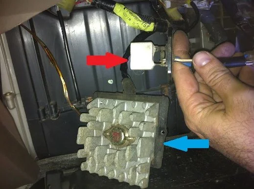

PICS PICS
OK so here are some pics... HELP ME!
The resistor pack seems to be somethign different on mine..
I bypassed it and still nothing.
Is there somethign else I am missing here?
Again relays are all fine, fuse is fine, bypassed resistor thingy, tested no good. Thoughts?

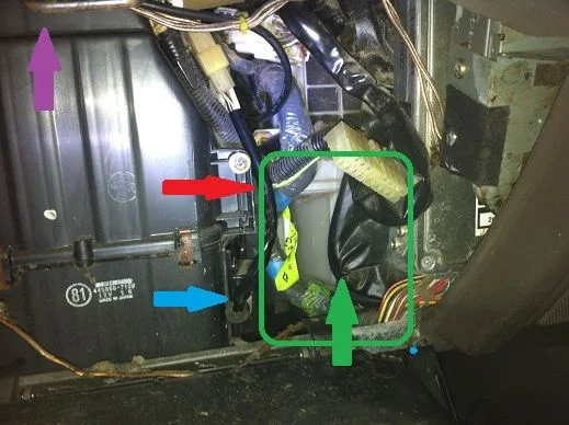

Purple arrow point to where relays are for those who may have similar issues.
more pics just for reference to help others
Hope this help some folks with the same issue as me
Did you check power and ground to the blower motor?
The motor gets switched power straight through the blower motor relay from the 40A heater fuse. You could jump that relay with no ill effects.
The relay gets switching power right from the 10A gauge fuse. It grounds through the AC amplifier.
The blower motor changes speed through the ground side of the circuit. The blower high relay bypasses the resistor block. If the blower doesn't work on high, the problem is not the resistor block. Again, I see nothing on the wiring diagram that suggests you can't jumper the ground side to ground, but I would disconnect the harness to do that as there is a splice that goes to the AC amplifier.

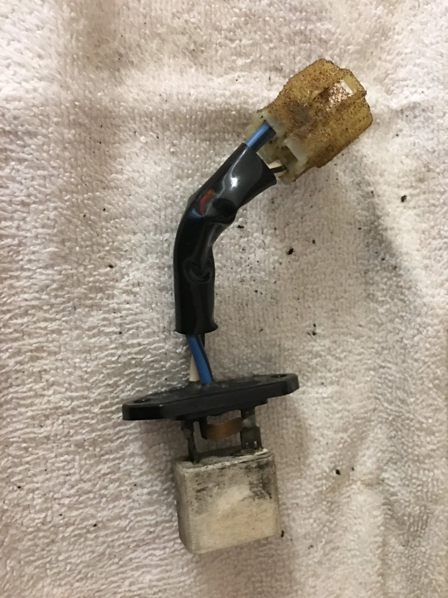

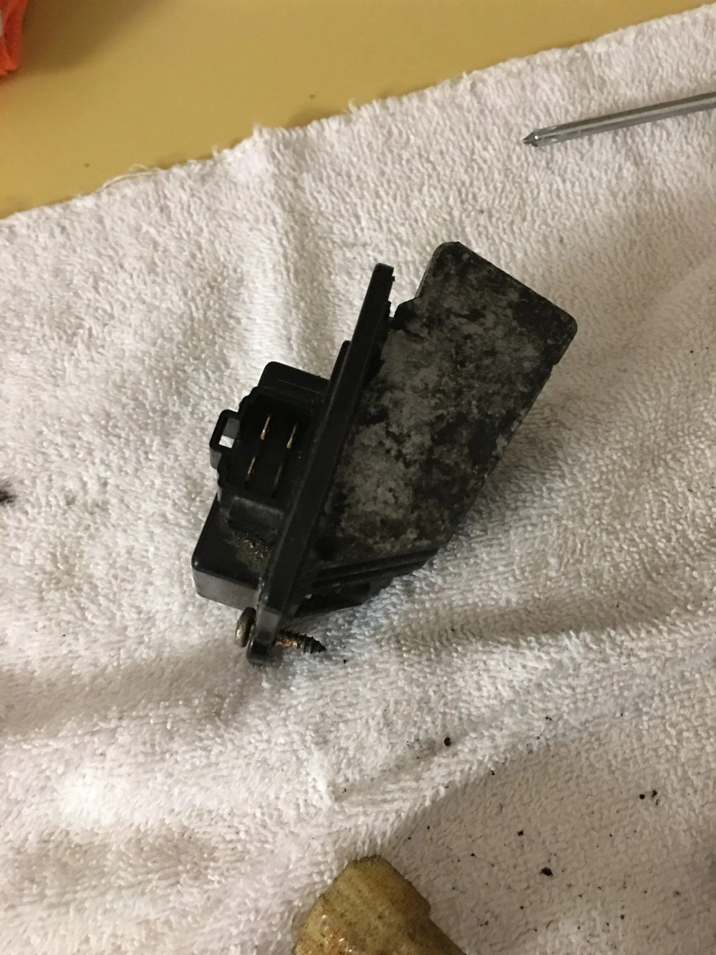

Sorry to dig up an old thread but, I’ve read thru this and many other posts and no one seems to say what they’ve changed to fix the OP symptoms? I changed resistors, changed climate control unit, and tested the blower resistor which I believe is bad as the continuity test says.
Those are the 2 parts I’ve pulled, top pic is the blower resistor? And bottom is the ac blower motor resistor? I’m not sure the FSM I have isn’t all that great in detail.
