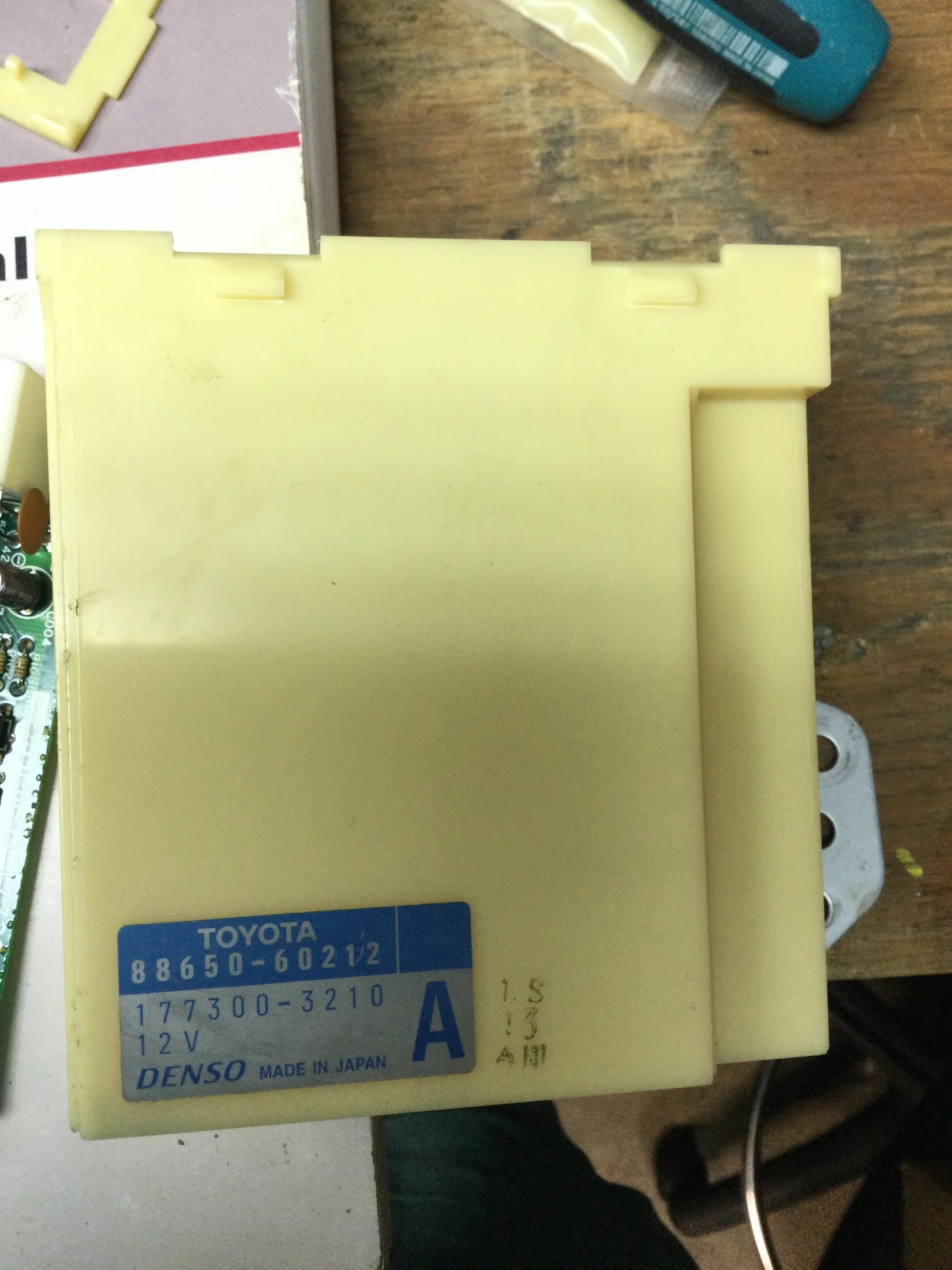

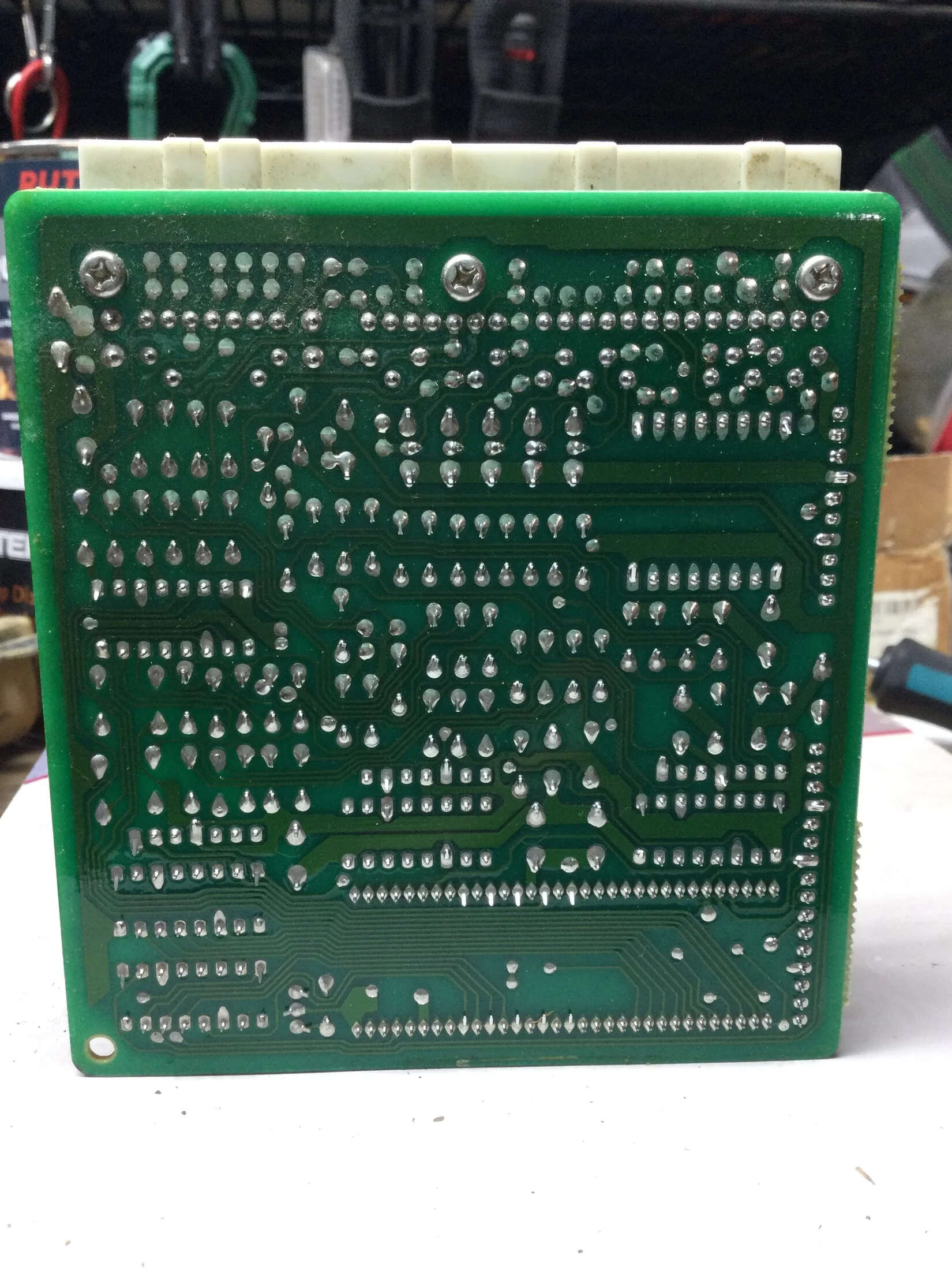

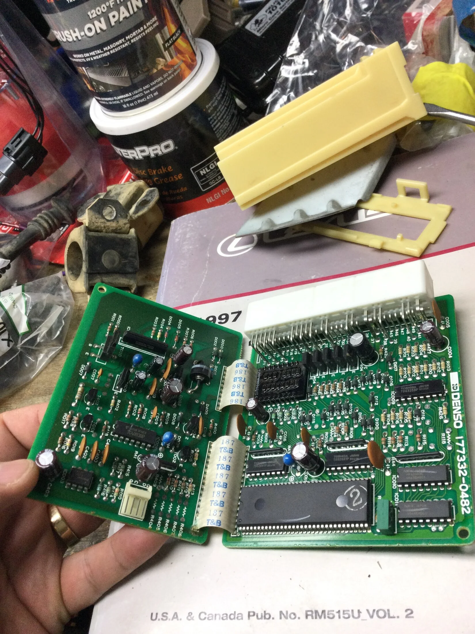

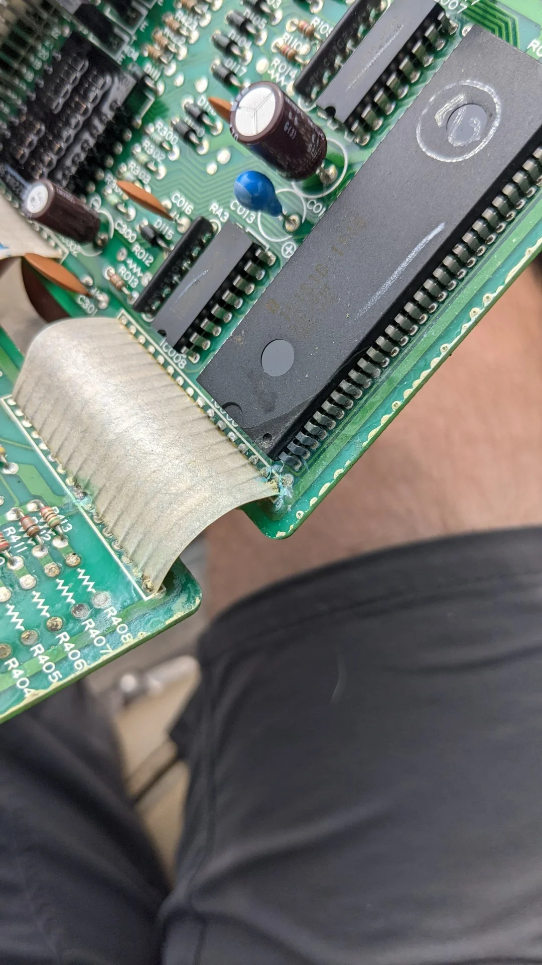

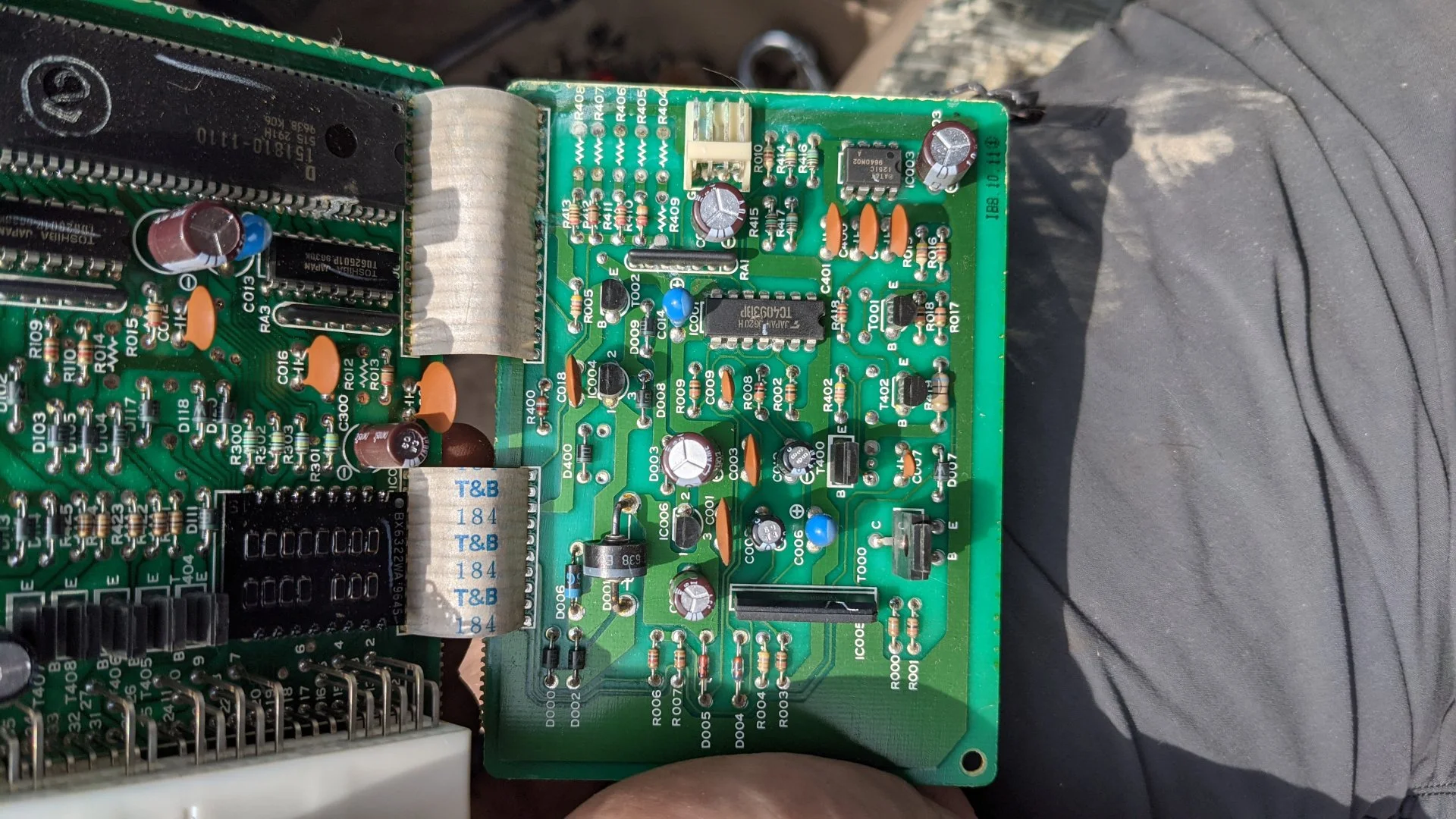

Pulled AC Amplifier (pics below) and it looks primo.
Based on the the minimal replies to this thread, I’m not optimistic but thought I should get it out there to the hive-mind
