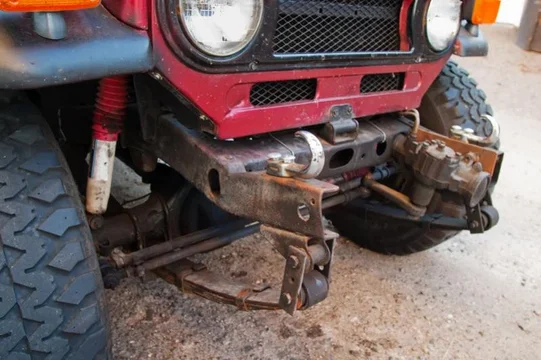

I just wanted to make sure nobody is planning to use carriage bolts to mount their tow hooks as seen in the pic on page 1 of this thread.
Nice shiny new tow hooks mounted with carriage bolts, really ? That must have been just to tie it down on the trailer cause a person would have to be seriously skewed to think that was in any way acceptable to use that hardware for that application.
Carriage bolts mounting tow hooks is a recipe for death for the guy towing you
Even if they are the proper grade it just does not fly IMO.
I just wanted to make sure nobody is planning to use carriage bolts to mount their tow hooks as seen in the pic on page 1 of this thread..
Peesalot - not sure what you're getting at - only pictures on page 1 are mine and the tow hooks are held on by the usual nut/bolt combo. They will be getting swapped out regardless before this truck sees any real work... The only place I've used carriage bolts is to hold on the bumper...
I believe he was referring to my rig which is at the top of this page. Another PO mod! :bang: It was soon rectified with grade 8 bolts. You'll also notice the wire wrapped around the cross-member, it held the radiator mount in place. :bang::bang: Also soon rectified.
:cheers:
:cheers:
You know, referring back to that picture made me notice something - your passenger side frame rail isn't boxed, at all...it's C-shaped. Is the non-boxed frame horn the stock configuration for all years? Mine is definitely boxed-in (you can see it in the shot of my bumper). Maybe I can chalk this up to the one thing done correctly by the PO.

Yup, neither of the front frame rails were boxed from the factory. Both of mine are now!
