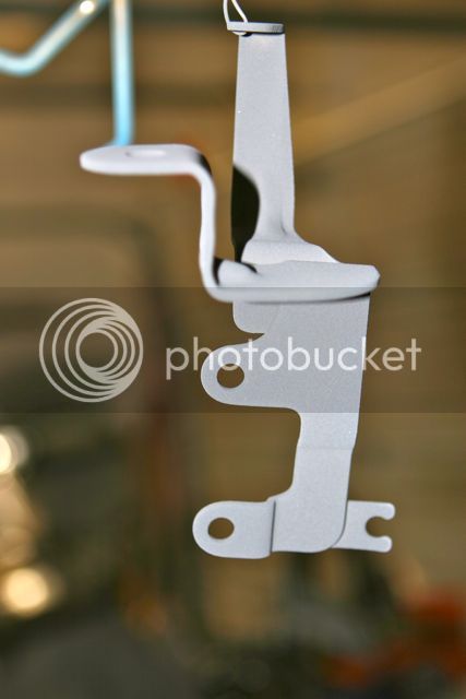

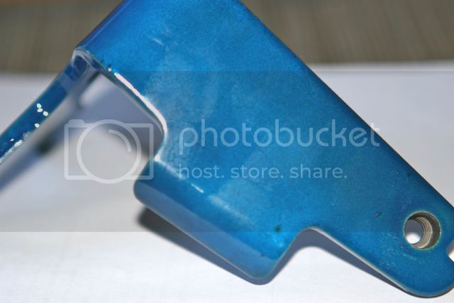

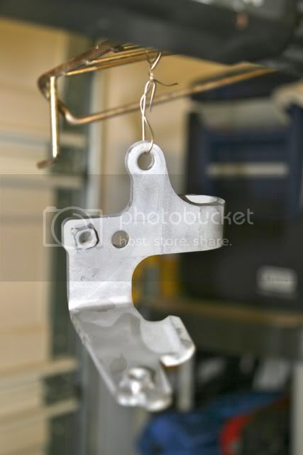

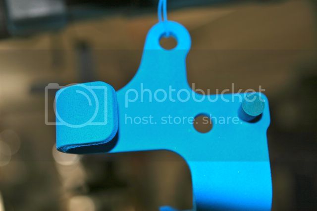

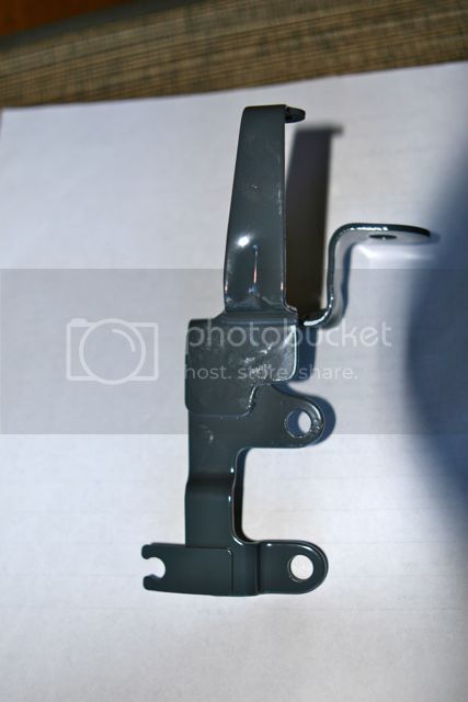

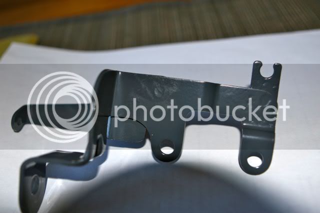

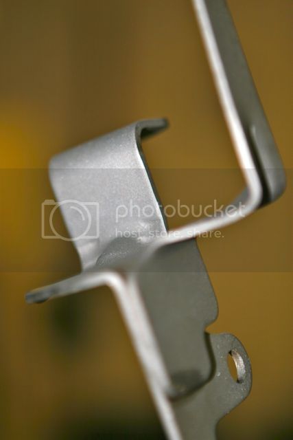

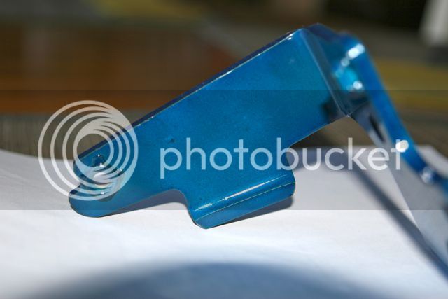

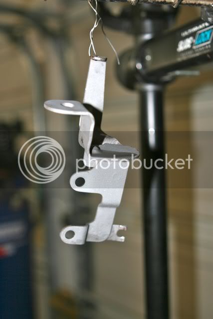

Also got the powder coating system going and had to do a test run this morning. Tried two colors on misc parts of the "install shelf": Dark Battleship Grey and Translucent Blue. It was pretty easy and clean up is as advertised, just blow off the extra and sweep it up.
Here are the pics of the first try, first pics, sandblasted, washed and ready for pre-heating...
Powder applied...
Freshly baked and cooled, ready for use, don't mind the smudges from my fingers...
I really like the "battleship grey" and will probably use that a bunch in the engine compartment. Really pleased with the results, pretty amazing...
