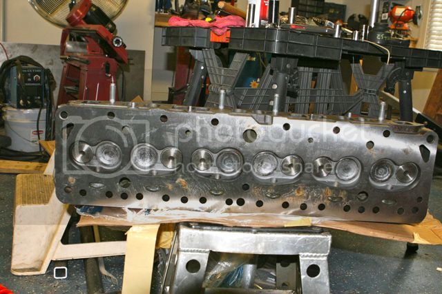

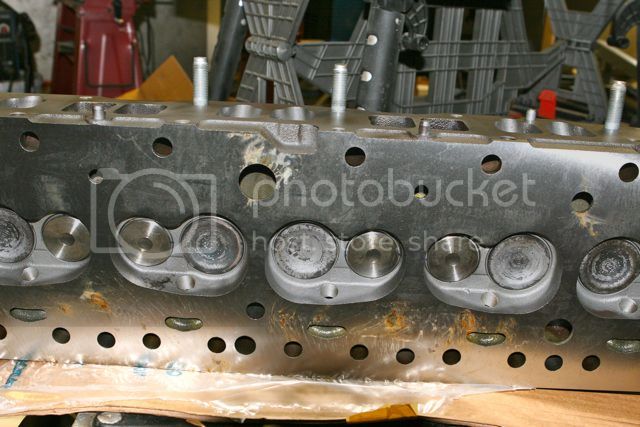

Due to the overwhelming endorsement, encouraging me to have some common sense, I did complete the tear down, dropping the block, cam and crankshaft off for cleaning and inspection. I also picked up the head after the work they did on it.
Here are the pics of the newly over-hauled head. They replaced the exhaust valves, cleaned, pressure tested, shaved 0.030 and did a "valve job" on it - $316 after tax...
