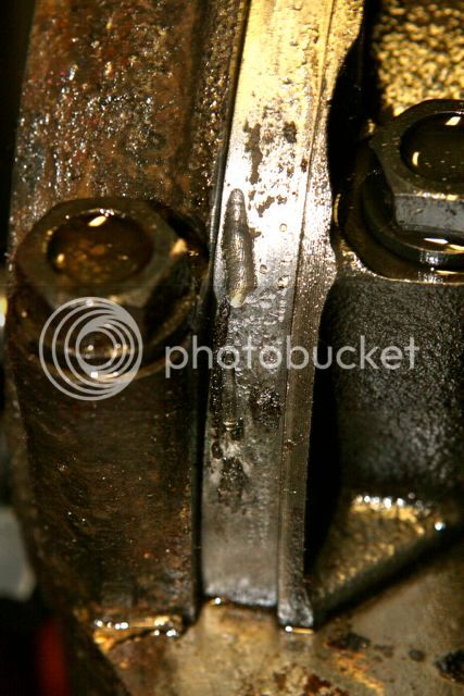

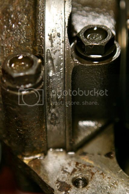

Got the time to get the oil pan off. Looks good to me but for the area where it was leaking. Apparently, someone decided to use some force to release the oil pan...
Not a lot of crud on the screen...

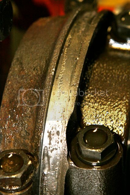

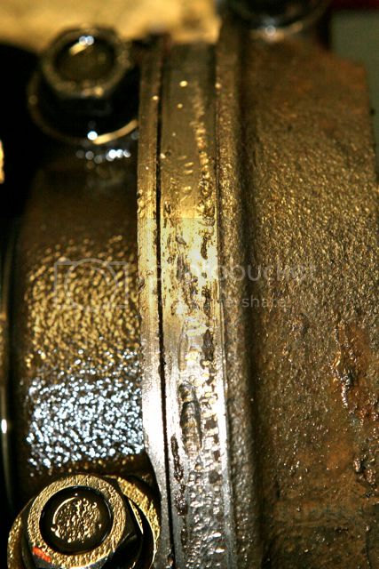

In another thread on the 2F-E projects, the subject of piston "drop-out" went on. This is how much is in this engine...
Interesting stampings...
No wonder it was leaking, gotta find a way to fix that...
Heck, i have used a screwdriver / hammer before on these and never did anything like that. A little extra black stuff should take care of that though. I should think.
I agree, gotta love the "black stuff"
lol
I've seen worse.... wouldn't worry about it too much.

Very strange to say the least. Can not tell on the pics how deep those are but if you think they are too deep then go ahead and get another cap. Should be able to but those still, Maybe ?? If not someone should have a good used one laying around. I do not right now but got an entire 2F here, that did run but had rod knock.
