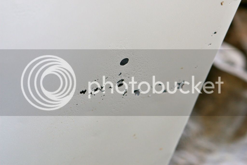

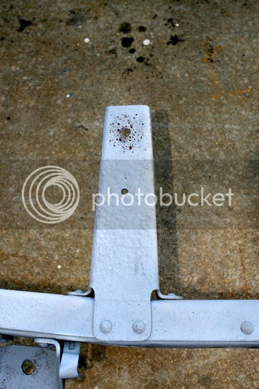

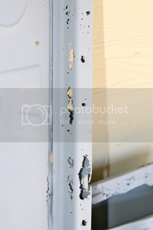

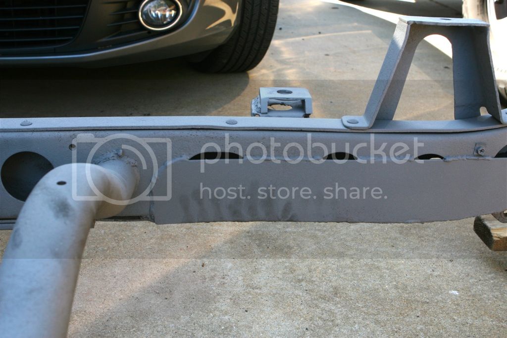

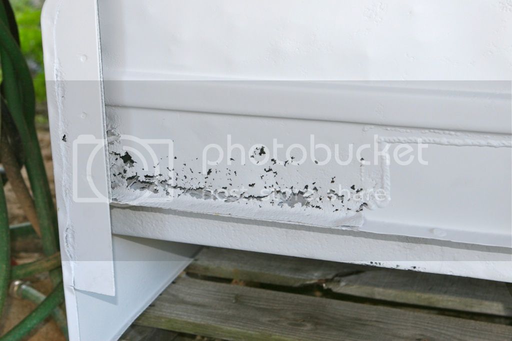

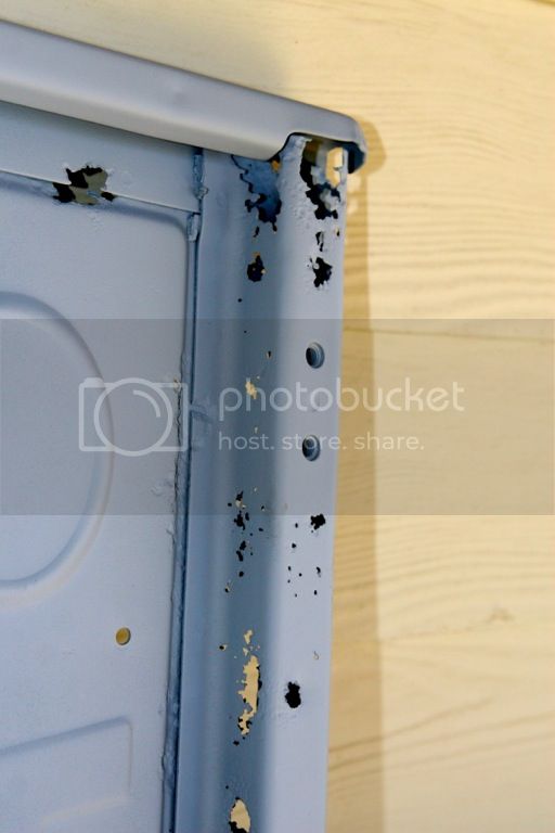

Analysis...Headache rack is golden but for having to remove the grate. Thats the best of the good, now for the challenging parts. First up, the windshield frame. Luckily, I've got a replacement already so this will be used for an experiment. The tub is in relatively good shape. Clearly it has had previous repairs, done reasonably and it needs repairs in a few spots...

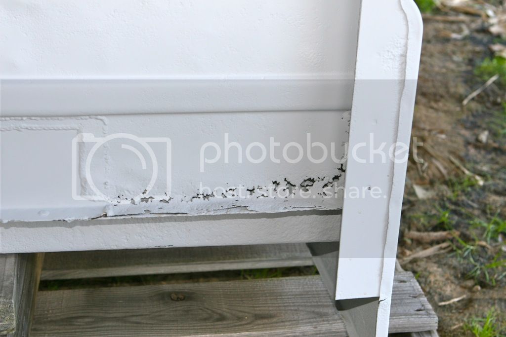

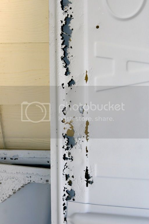

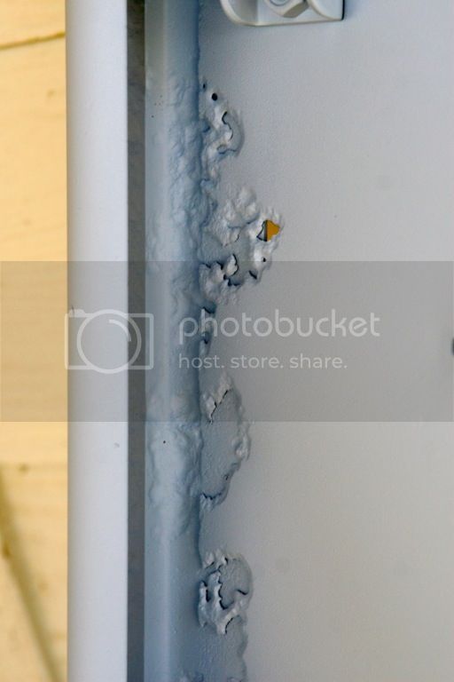

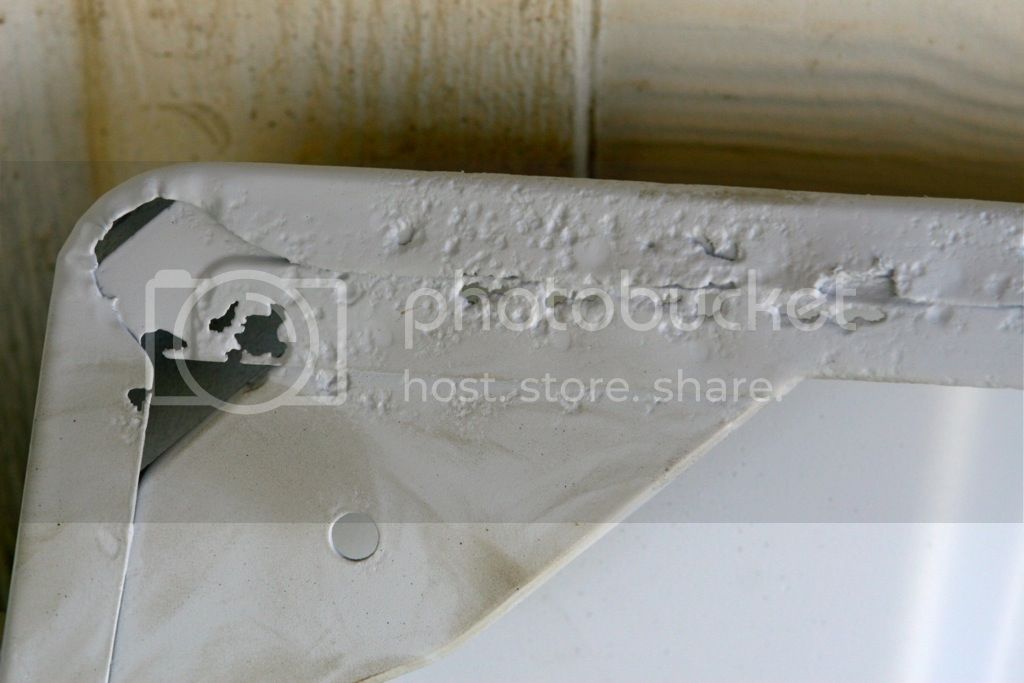

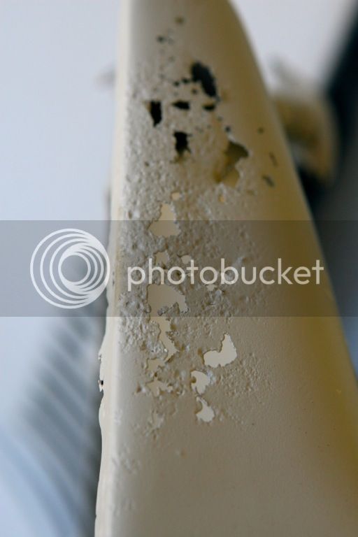

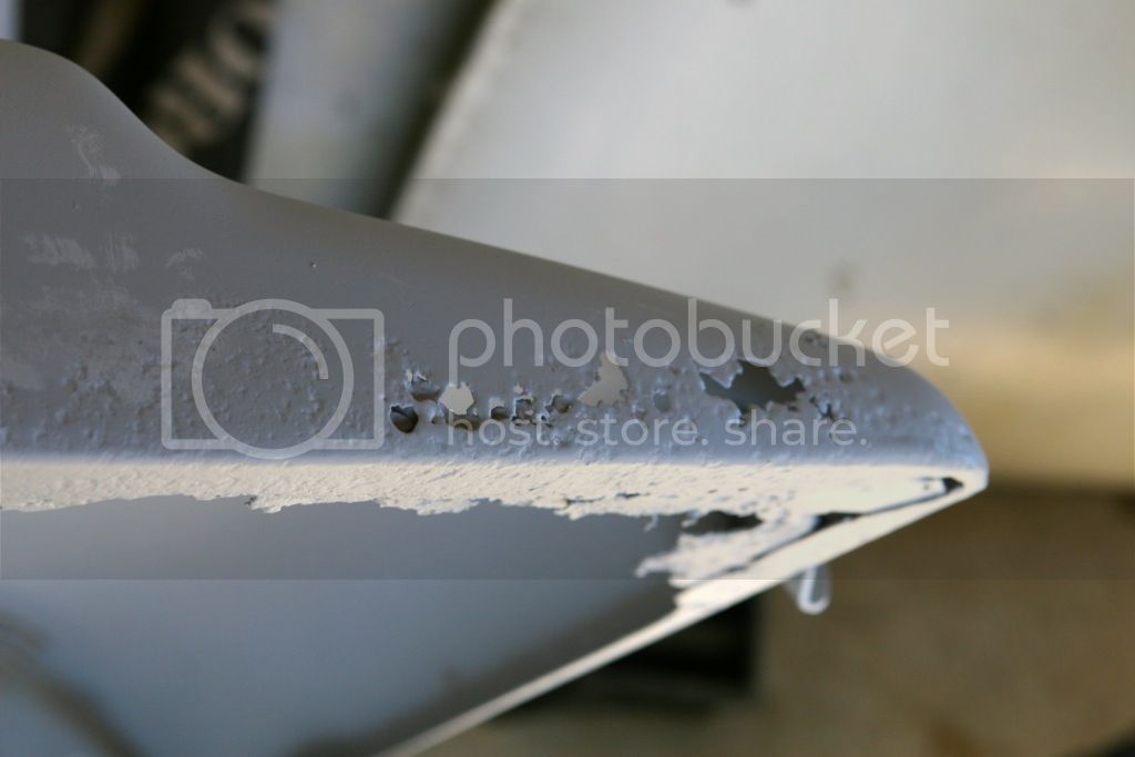

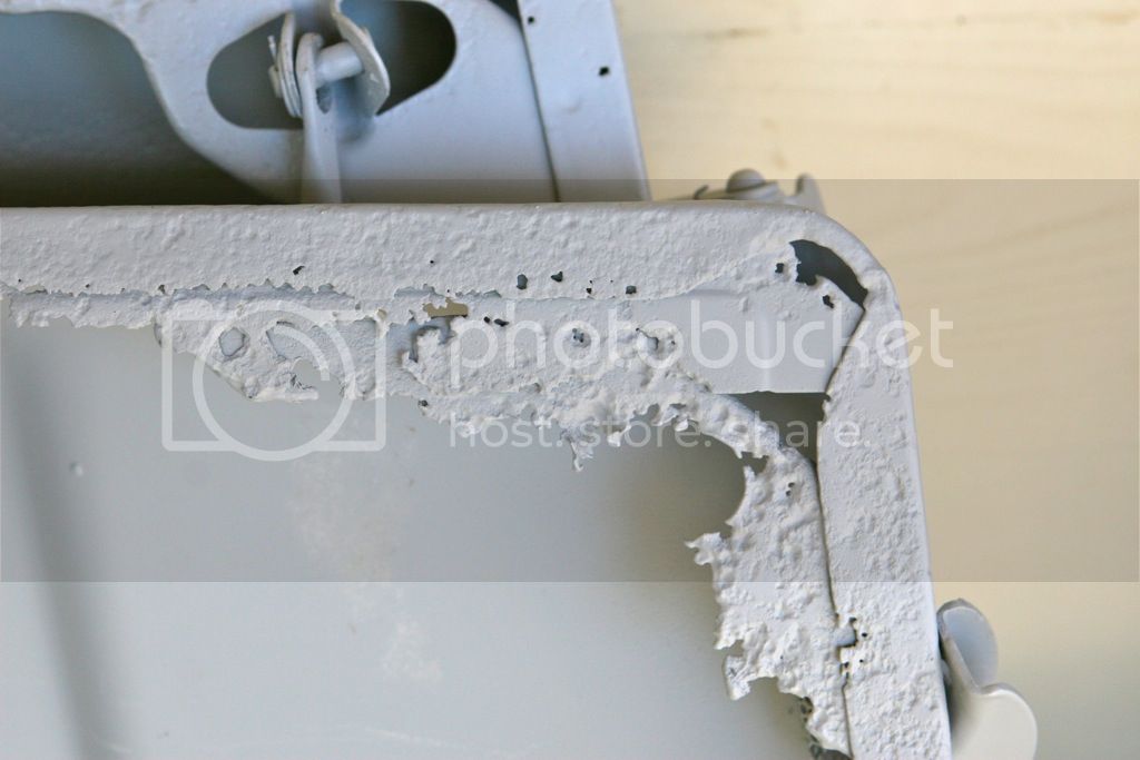

Next up, the tailgate. Major problems that I'm not sure how to even approach fixing it. This runs all along, under the lip...

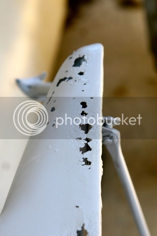

The, the bottom channel...

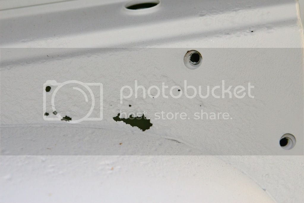

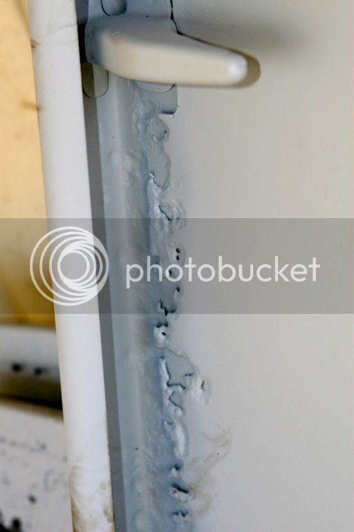

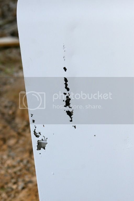

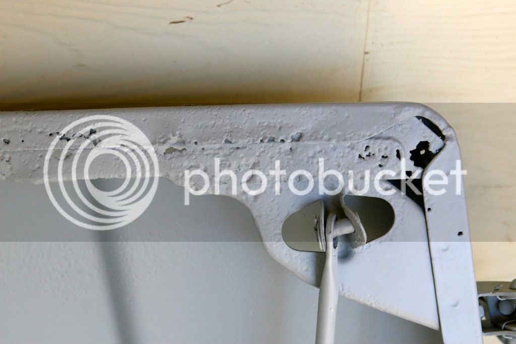

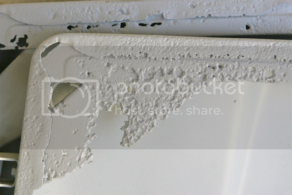

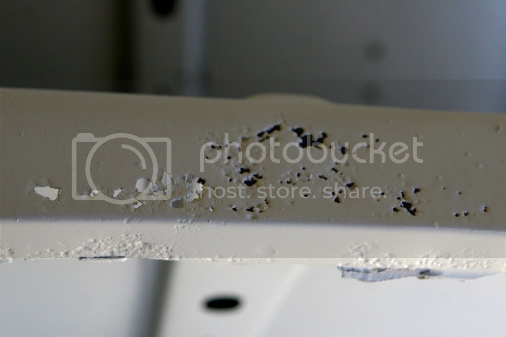

I've got two hoods, both pretty equally bad in the same spots...
Hood 2...

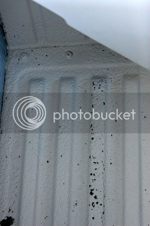

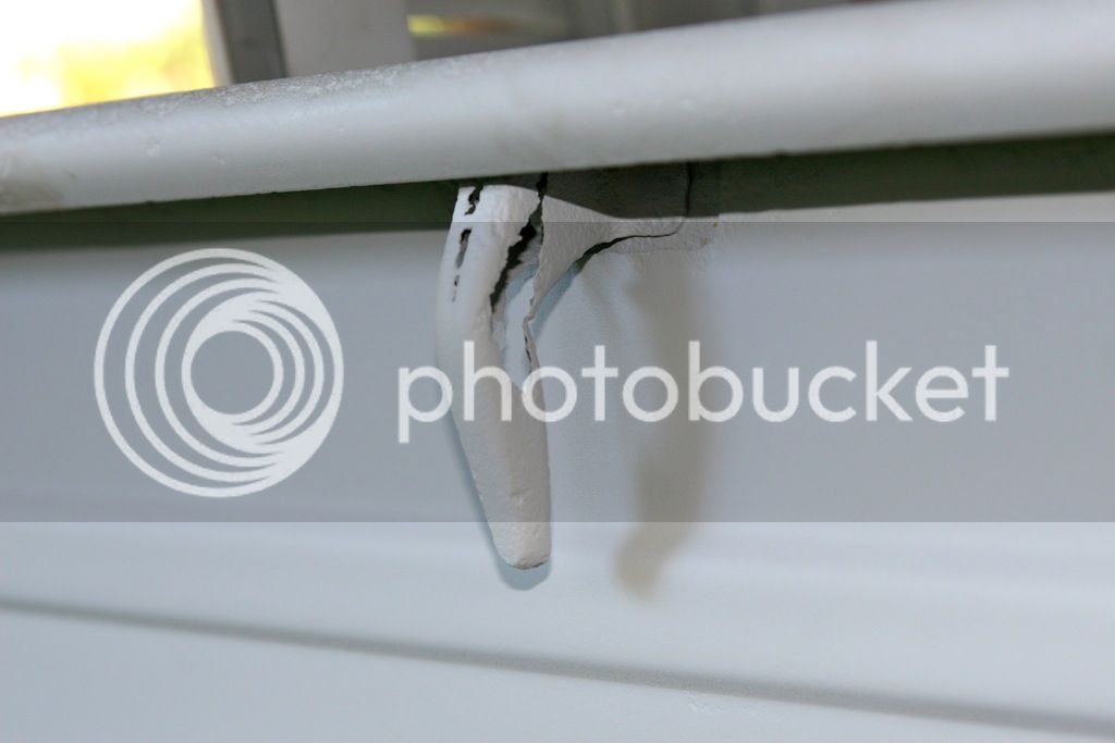

Now, for the bed. Its a mess also. The sides and wheel humps are the best, the floor of the bed has to go. My solution will probably be the easy route...wood planks like I did for the trailer. Here are the pics...

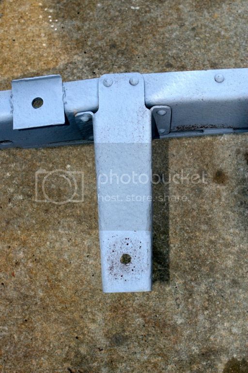

How/where am I going to source these tie down hooks. Most are gone, those remaining look like this...

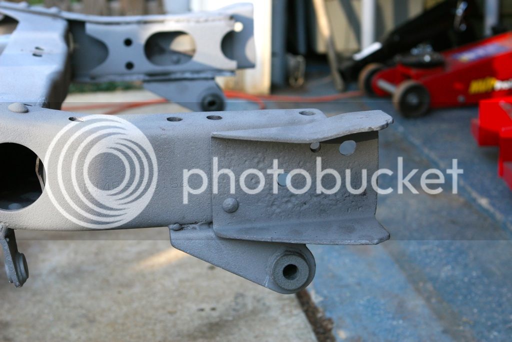

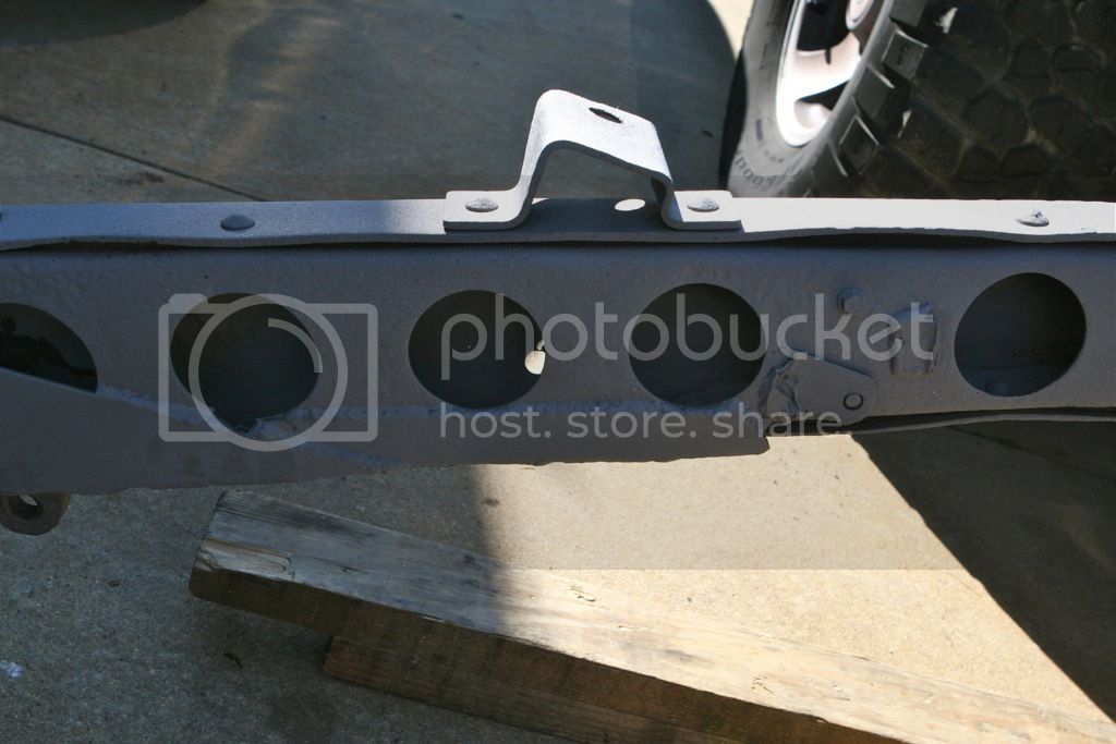

On to the finale, the frame. Good and bad. The front half is in fairly good shape. The back half is in fairly bad shape. Clean enough to see the VIN # on the frame...
A bit of notching to accommodate the FJ60 power steering pump clearance...

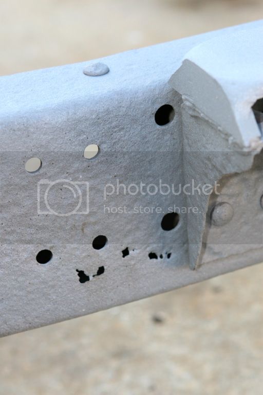

Not great but repairable for sure...

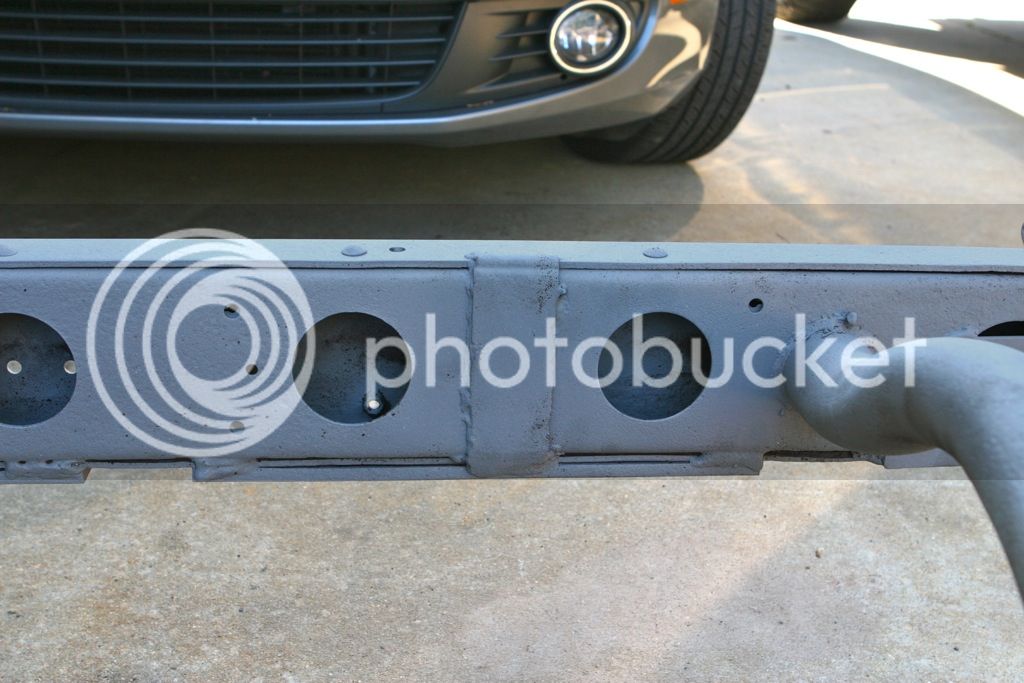

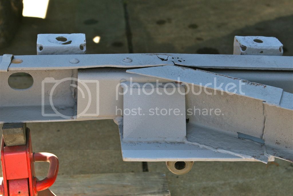

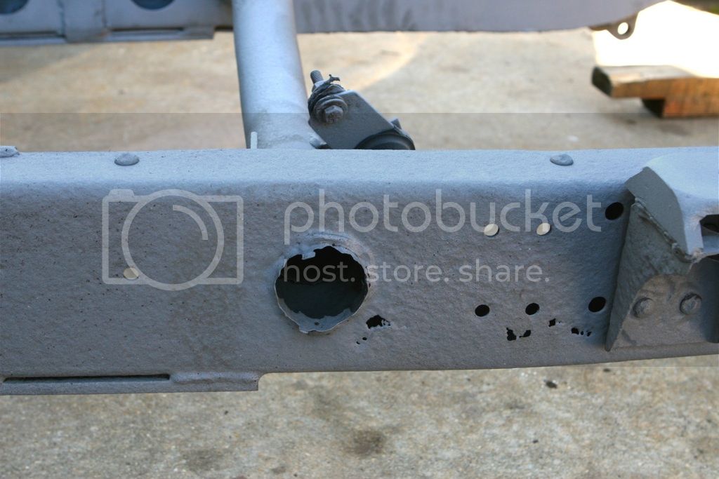

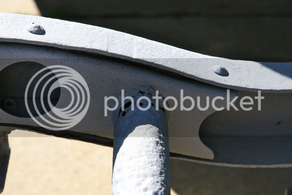

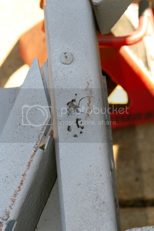

Now, the fun starts...
Don't know what's going on here but trying to keep things together...
Way to many holes around the cross-member...

This tie down is all sheet metal, yes?
