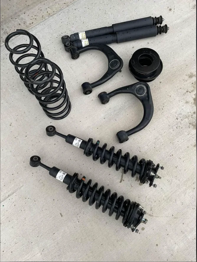

That makes sense what you're saying. I'm very new to all of this so I'm trying to learn. I was more talking about these items off a newer TRD 4runner:
It’s possible, but it’s a ton of money. Your 92 is like my 89, it uses torsion bars, not coil springs. You’ll have to get a long travel conversion kit from Total Chaos to use coils, and you still won’t use take offs. Most of the time it’s reserved for baja type racing trucks. You’re looking at $8-10k to do it right.
In addition to this, you’ll need new fenders, longer cv axles from the T100, and a couple of their steering components.
In short, I think you’re approaching it as a budget friendly option, you’re just looking in the wrong places. You have torsion bars in the front, and leaf springs in the rear. Are you looking to just replace a sagging suspension, or are you looking for somewhat of a lift?
