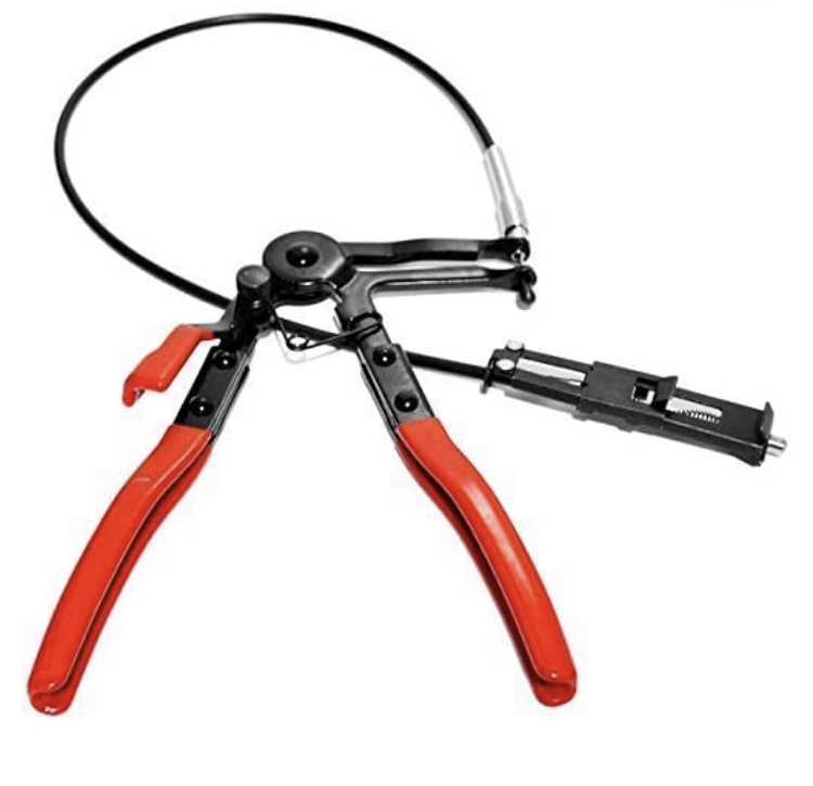

Hose clamp pliers make every job easier.
Amazon product ASIN B07C3LYZM7
