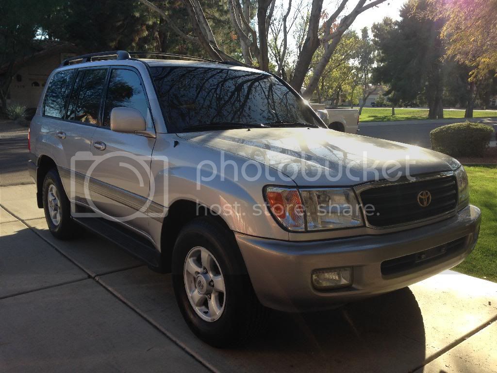

Vehicle: 1999 LC with 173k on the clock

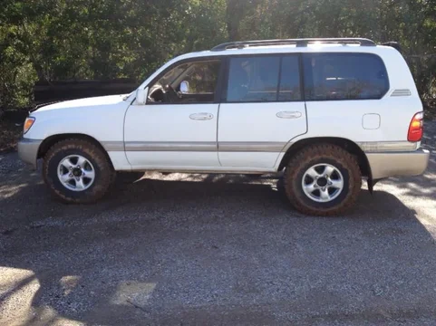

I have a 99 as well. Here it is with 285/75's before the OME 2.5 lift.

285/75/r16's installed. Pictures soon.
