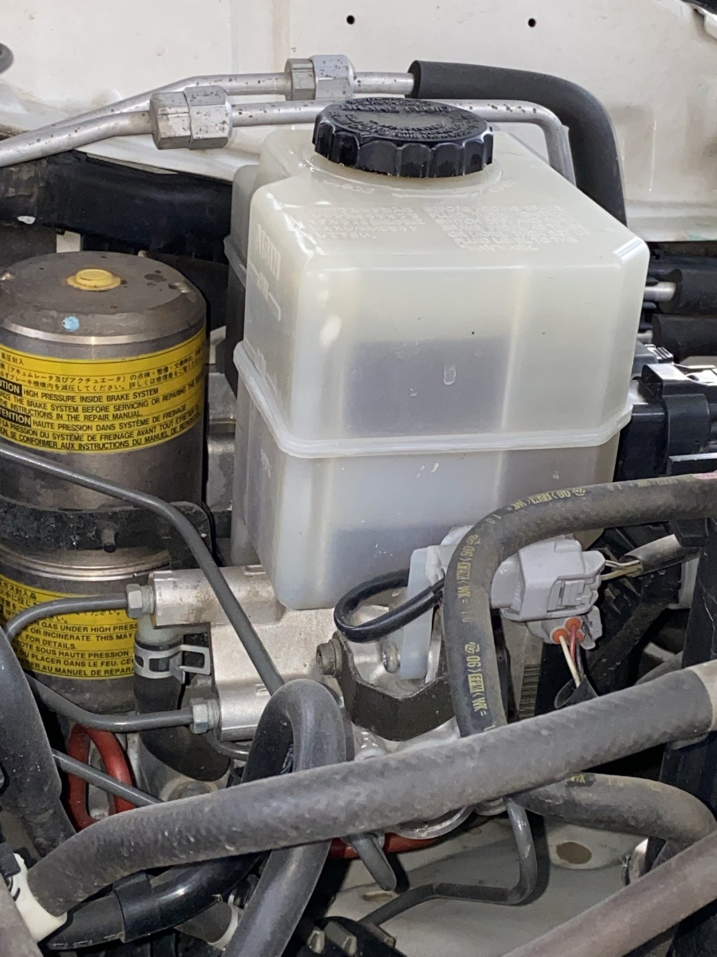

Anyway enough of my boring details, here is my question and I did attempt a search in the couple of weeks I have been lurking here. I see a lot of concern over the brake master giving out and the total brake failure thing, but can't find any threads on just chucking the system and putting a Wilwood or master from another model in its place. I know you would lose the ABS which I would be okay with, more than half of my cars are pre ABS anyway.
Is there some reason I am not taking into account that makes a swap like this more complicated than it is in other vehicles? It seems like there is room on the firewall for a MC and brake booster can.

The brake booster is not a conventional one and it has wires and computers etc. Mechanically you could replace it. I'm interested in that possibility myself.
It should be possible. I think this is uncommon because the factory electric booster seems to last about 200k miles and 20 years - which is a pretty good service life! Also, it is not dependent on your engine running at all, which means, you can stall your engine, run out of fuel or have any other issues but you can still use your brakes as long as the battery has juice.
That may not sound like much, but I have seen videos of ppl stalling on hill climb (yes, even with an auto!) and then immediately loosing their brakes - what comes after is usually not pretty!

I did just run across one that seemed fine. In that it did not signs it was about to fail. Fail in that fluid was puking out, but brakes still worked. Signs I look for are: fluid turning dark fast after a flush, stain reservoir, over filling, corroded brake control wire. It's wire was corroded and motors commutator had dead spots. But wire and motor replaced years ago / ~60K miles. It was fine until for some unknown reason it started blowing dirty fluid out the cap.

Besides, you can replace just the electric motor for $260 (parts only) from Eurton Electric in CA. I am a t 240K miles (2000 LC) and it is still good.
Might be a good idea to have a backup motor just in case. Pull over, get the new motor installed, bleed at the master pump and drive on..
