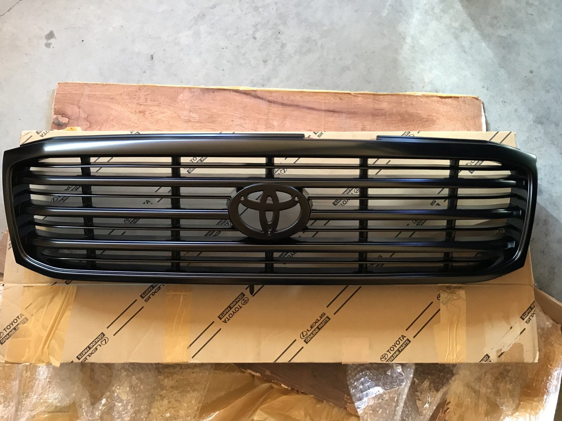

Chrome Delete Grill thread (53111-60330)
1620f065-af74-48d9-b621-883fec0f93de-jpeg.1948086
