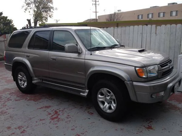

For our youngest. She was a bit slow to buy into it, but she seems stoked now.
For my taste, this is the pinnacle of 4runner styling.
School me on ECT and how the 4wheel drive works. It looks like it has 2wd and 4wd via the button on the shifter, obviously high and low via the shifter, and then a center diff lock button on the left of the column?
I tried 4wd before I bought it, but I didn't notice the diff lock button until after. It doesn't have a locker in the axle.
I literally bought it from a little old lady who only drove it on Sundays. She said she had insurance that was only good on weekends, and another car for commuting. 115k mi.
