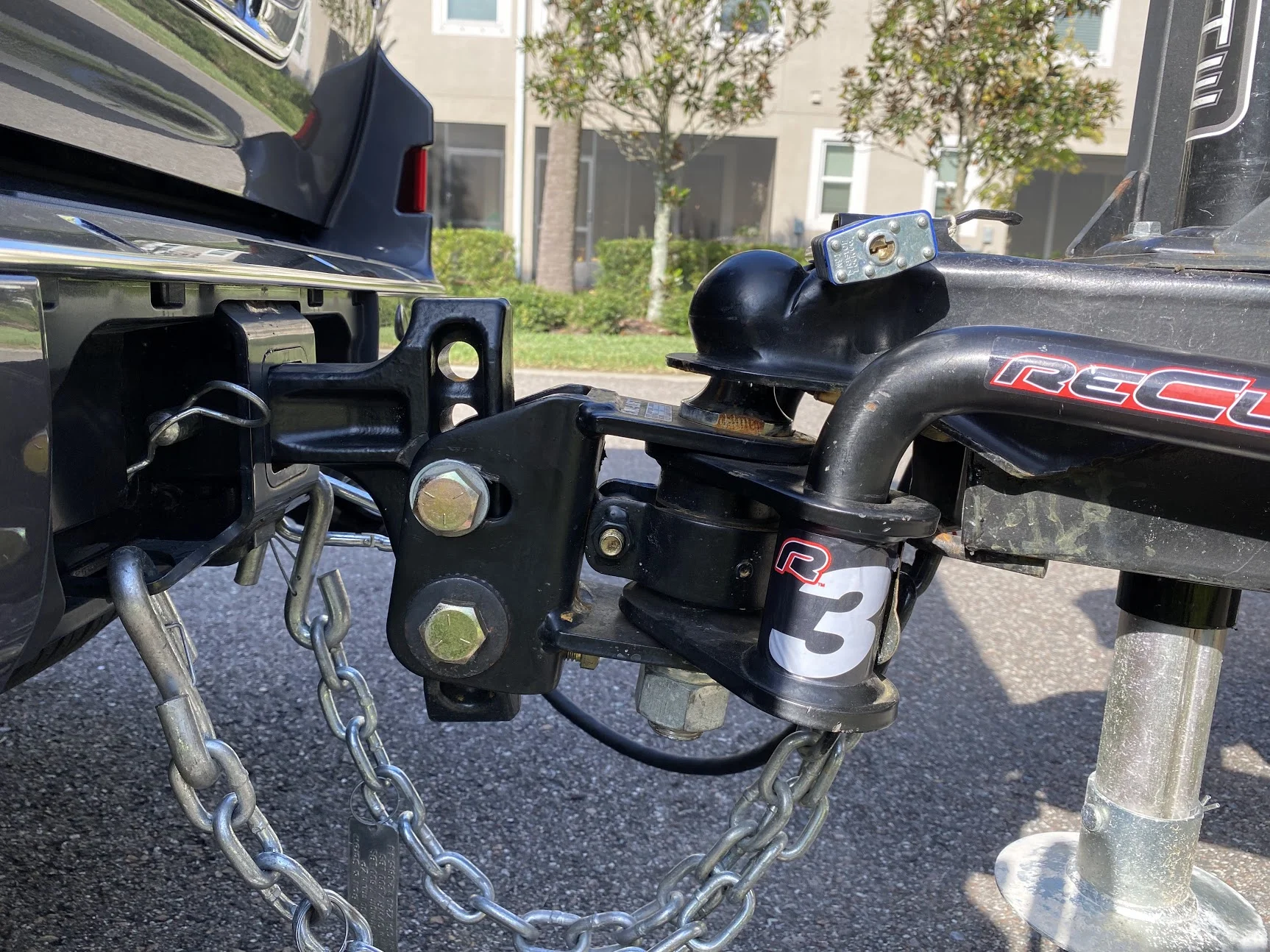

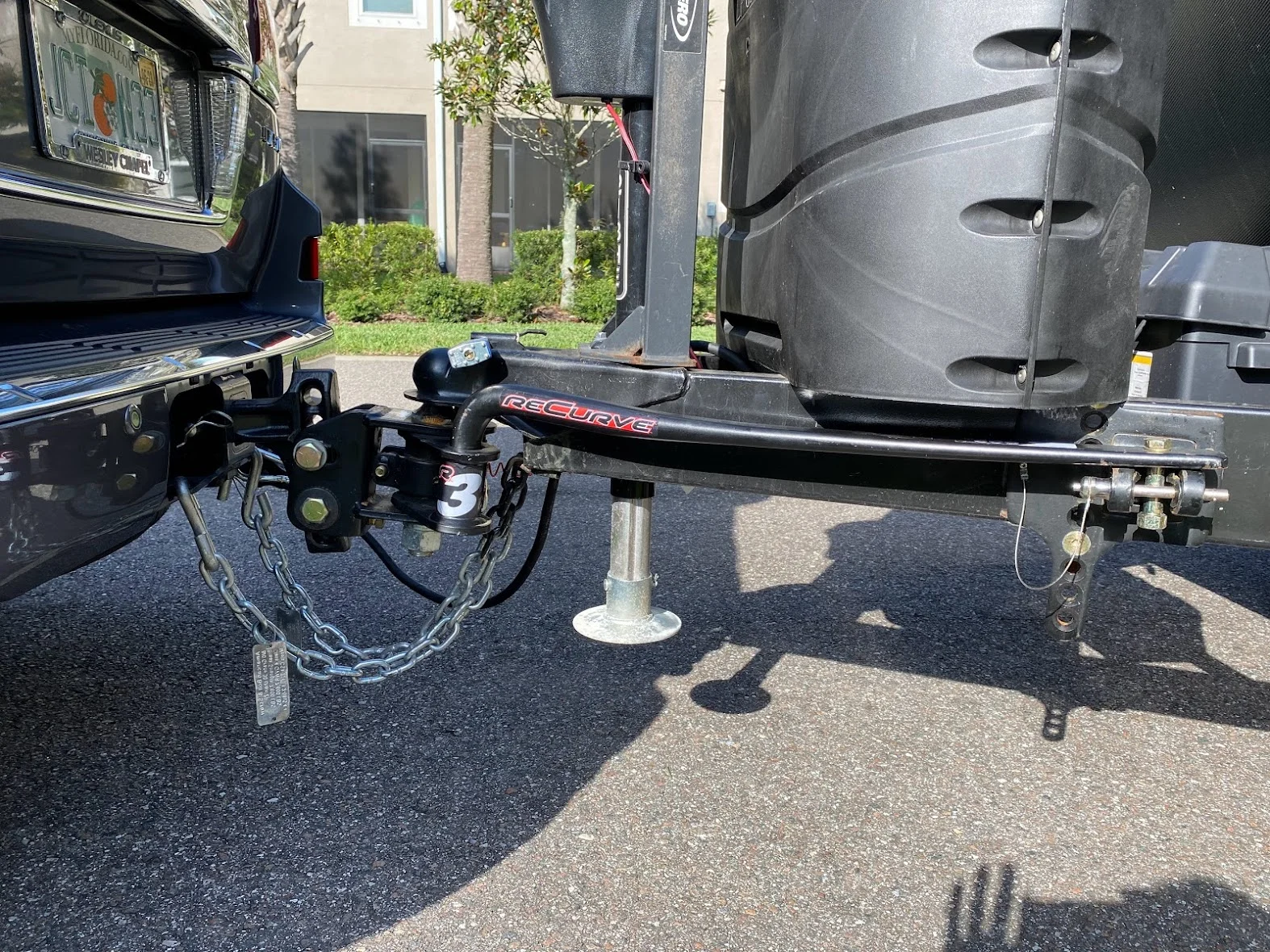

UPDATE: Took my shank to a machine shop and they drilled another hole through at about 2" closer to the ball than the original one. Had them reposition the ball to a downward slope of 10 degrees. Retightened the anti sway hex and the thumbscrew to lock in the new position. This has transformed the towing.
- No poirposing
- Very little sway
- Feels great on the road

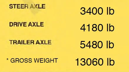

Including a new weight report after hitch reposition and trailer full of fresh water and gear.
- No poirposing
- Very little sway
