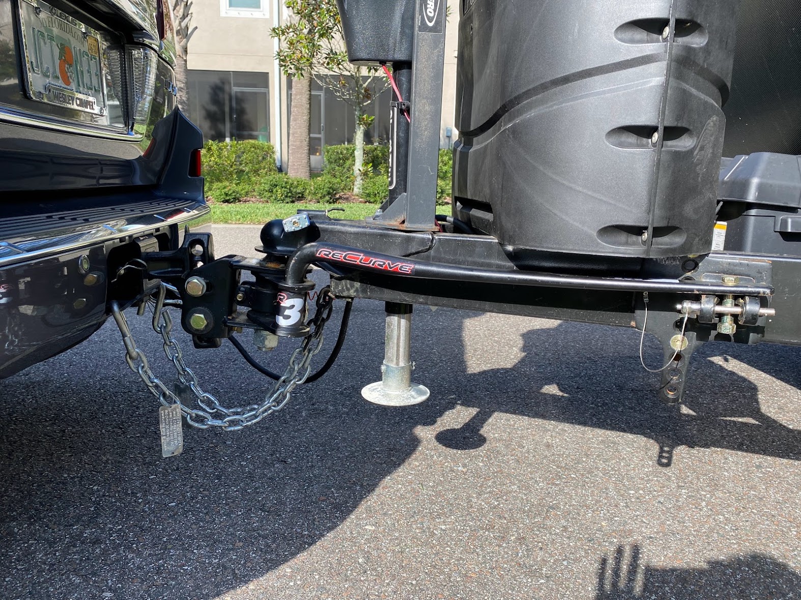

Let me know how this work out for you. I have a 2013 LX 570 and tow a travel trailer of about 5000 lbs. I have this wd hitch ReCurve R3 Weight Distribution Hitch Kit - 1000lb, 2 5/16 - https://www.eaz-lift.com/products/recurve-r3-weight-distribution-hitch-1000lb-kit
I've had some issues with sway so I am thinking I need to adjust the sway control on the hitch. Towing my travel trailer doesn't feel very good and as such I am shying away from longer trips. Have only gone about 3 to 4 hours one way so far.

Would you have a picture of the hitch from the side view? Maybe a closer in shot and then overall?

This is the hitch I use.

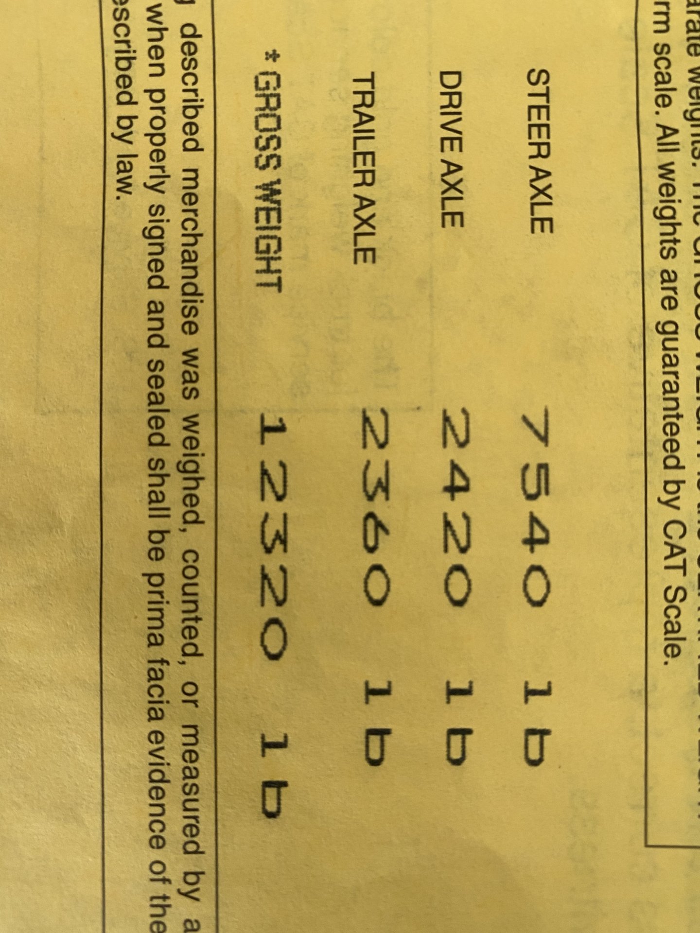

Overall, the Lx fees plenty powerful although very thirsty. It’s the floating in the suspension that gets to me and I believe it may be my tongue weight pushing us to payload issues.
See my pics for why I think this to be the case.
I am way under rated tow limits as my trailer loaded with basics is just under 5,000 lbs (matches manufacturer specs). I don’t believe I was setup properly at the weigh station as I believe I should have had my front and rear axles on different scales as opposed to on the first scale. I am under the GCWR and under on tow capacity but at/over GVWR with the tongue weight on the truck. I am thinking I should redo the weigh with the truck properly across two scales with the trailer on one. At the time of the weigh I had my family of 4 and a few basics on the LX but in no way were we loaded up for a trip. I did have a full tank of gas.
Thoughts/input appreciated. I hope this helps the OP as well. Ultimately the LX has a respectable payload of 1285 lbs considering some pickups have similar payloads with lower GVWR ratings.... All this to say that if I can figure out how to get the "feel" of towing my RV optimized and within spec, we should enjoy our RV experiences and have more of them. Just need to make sure I'm chasing an impossible payload #.

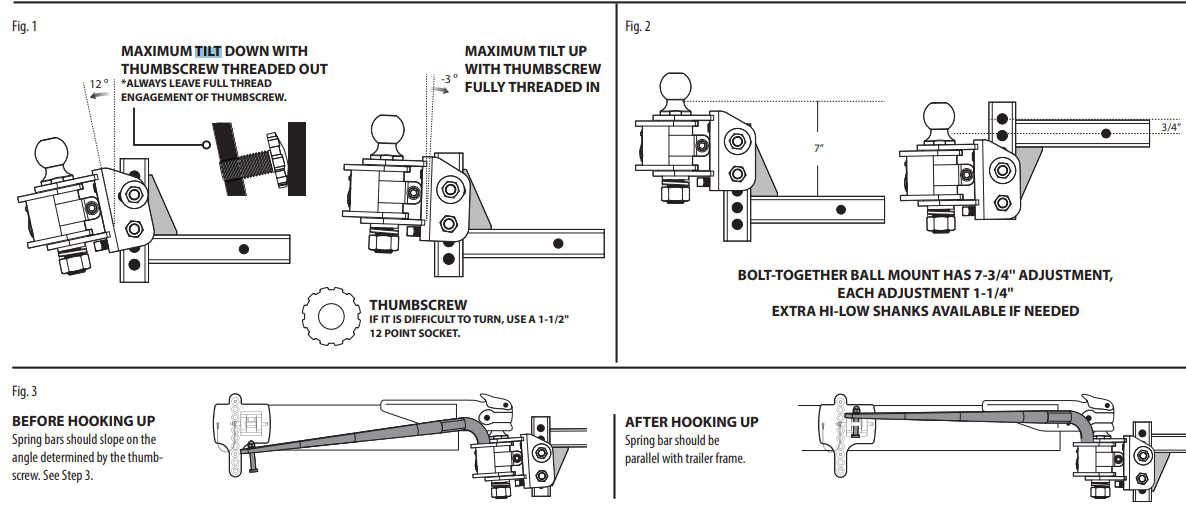

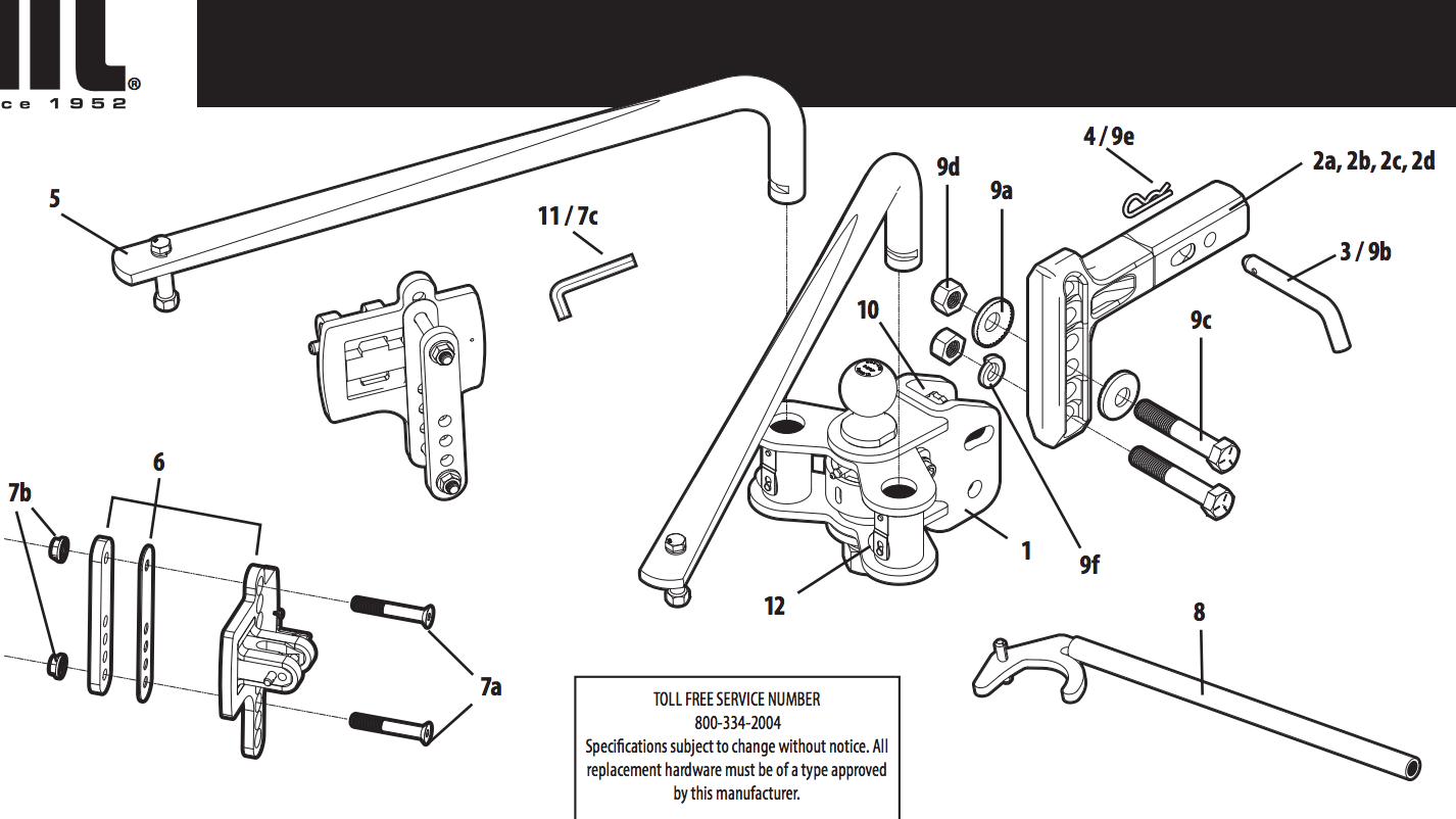

My WD hitch using tension bars and they slide into a bracket on each side of the trailer tongue. There are two points to close them in, one closer to the frame of the hitch then the other. I tend to use the one closest to the frame (parallel). I am going to try to adjust the anti sway tension with the adjuster allen bolt. Not sure how to put more tension on those bars other than experimenting with the two positions I described. See the snapshot of the hitch attached.
EDIT: Just learned that in order to add tension to the anti sway bars I will have to adjust the angle of the ball hitch with the thumbscrew referenced in the diagram as #10.

Ayup! You got it that you'll need more down angle on the head (Fig 1 & 3). That's what ultimately transfers weight or front axle load restoration (FALR). If you've maxed out the head angle and still don't have enough tension, you may need to raise the hook-up brackets on the sides of the tongue.

Including a new weight report after hitch reposition and trailer full of fresh water and gear.
