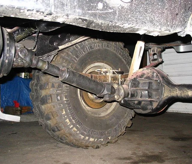

Any pics of you4 set up? Particularly the rear drive shaft. Thanks again

350 to sm465 long AA adapter 3 spd tcase. Drive shaft pic

I haven't mocked up the drivetrain in my rig yet so I'm basing my plan on information I've gleaned from this site and others. Originally I was going to go spring over with fj60 axles but now I'm not really building a rock crawler and I thought that sprung under that drivetrain would be too long. Based on your picture that looks like a sweet setup, I don't see a problem at all with that rear drive shaft.

I don’t think there will be much of a difference. Between spring over and spring under really. If u look at my t-case ebrake to the crossmember tube In the frame. U can see my t-case is almost in the stock location. So I think you should be fine with a almost stock length rear drive shaft. As long as all your stuff fits in front of the crossmember tube your good I have seen guys cut the frame crossmember tube right out of the frame and still run a short driveshaft in there or guys running an automatic tranny they still seem to stuff a short drive shaft in there and make it work. Just something for you to think about.
