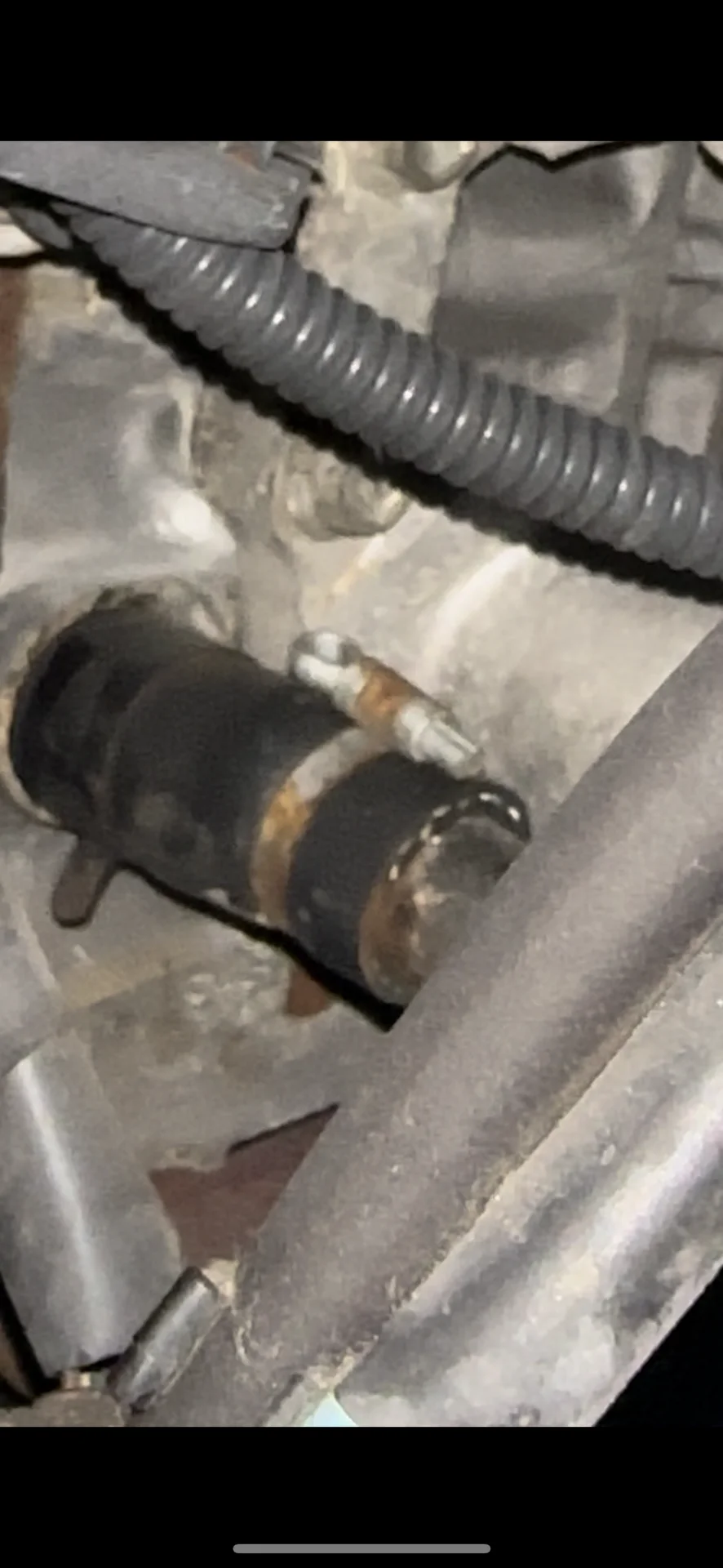

Just got a ’97 FZJ80 and I’m going through the work of baselining and building confidence in the rig before taking it on longer trips from home. I’m new to the platform so really didn’t do good due diligence wrt common Fzj80 problems before purchase but so far seems nothing is terribly wrong with the truck
I haven’t had any coolant loss issues in the two months of ownership so far — but only about 600 miles driven. I do have full service records from the PO and from what I can tell, all the hoses are original. After spending too much time in the forums and learning about how frequently the PHH fails, I took a look at it. Rubber seems to be in good shape, no bulging, but I do see signs of leak in the rust at the junction of the metal and rubber. Wondering if others think this is an urgent, do-now fix or if I can get by until a trusted shop can get at it.
Obviously there a lot of threads about PHH so apologies for starting another. I have done search but each PHH is different and hard to search images for similar looking ones :)
That's original. You'll see its true condition when it comes off. Replace it & all the other coolant hoses, using constant tension clamps, not worm drive. Replace the heater control valve if it's old (top center on firewall, typically it will have turned brown if it's old)

its not so much how it looks. No lie, mine looked just like that. Driving just 2 miles from walmart, I noticed a leak and sure enough, it was the PHH. Didn't have a mechanic but I was able to read a lot of threads and took the job on myself and addressed a bunch of cooling hose issues along the way.
bottom line, its 25 years old, you should make it a priority to fix it.

I wouldn't stop driving it, but I wouldn't go on any long trips with it, either. It's well down the road to eventual failure, how far that is is anyone's guess, but I'd rather fix it sooner than find out how far away later is.
Pull the wheel and reach in after taking the splash skirts off. I found it rather easier than it often sounds here. IIRC swiveling the down pipe helps line things up, I think it took maybe 90 minutes.
It's more than 25 years old and it's the original factory hose. Consider it preventative maintenance.
