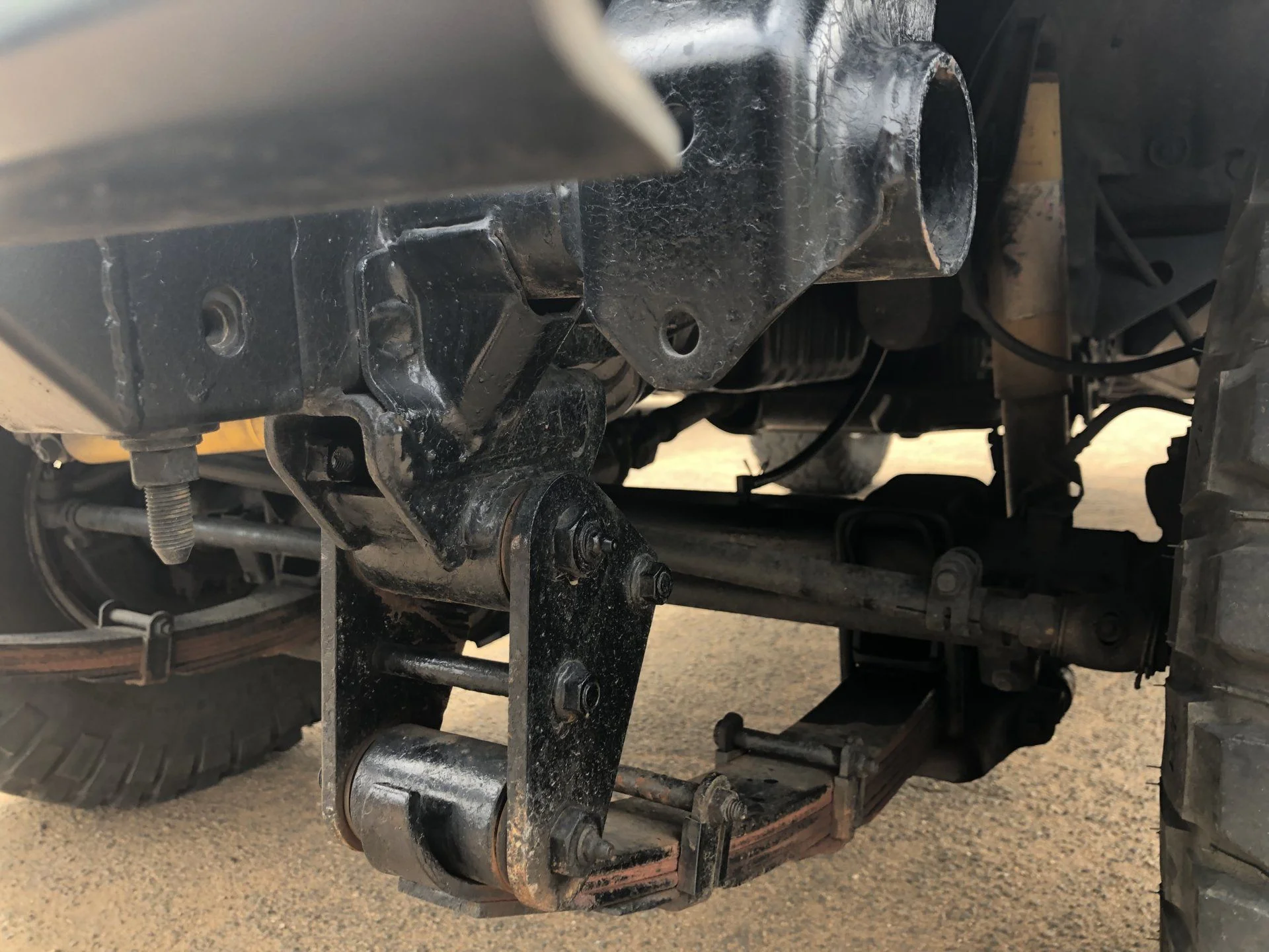

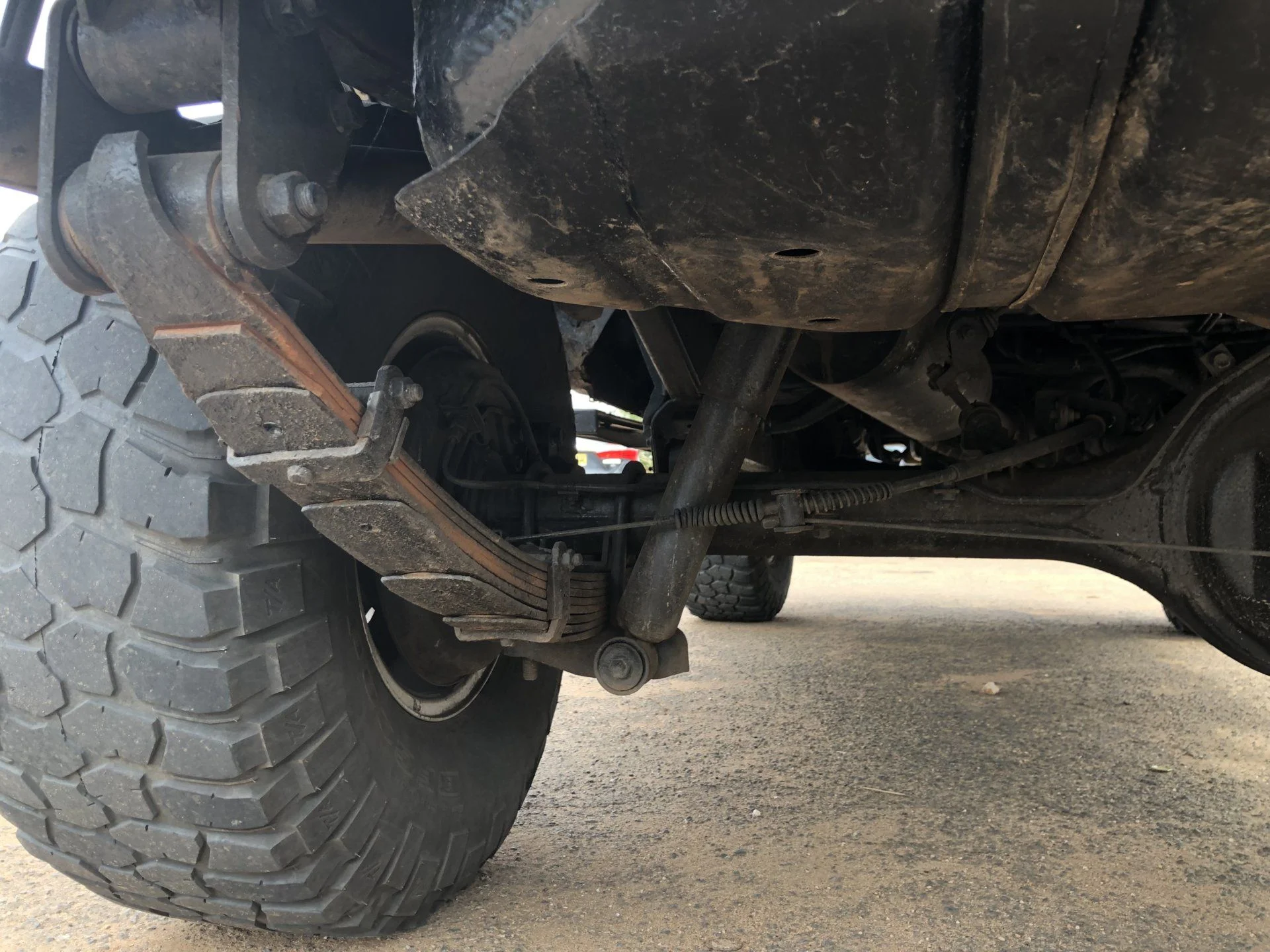

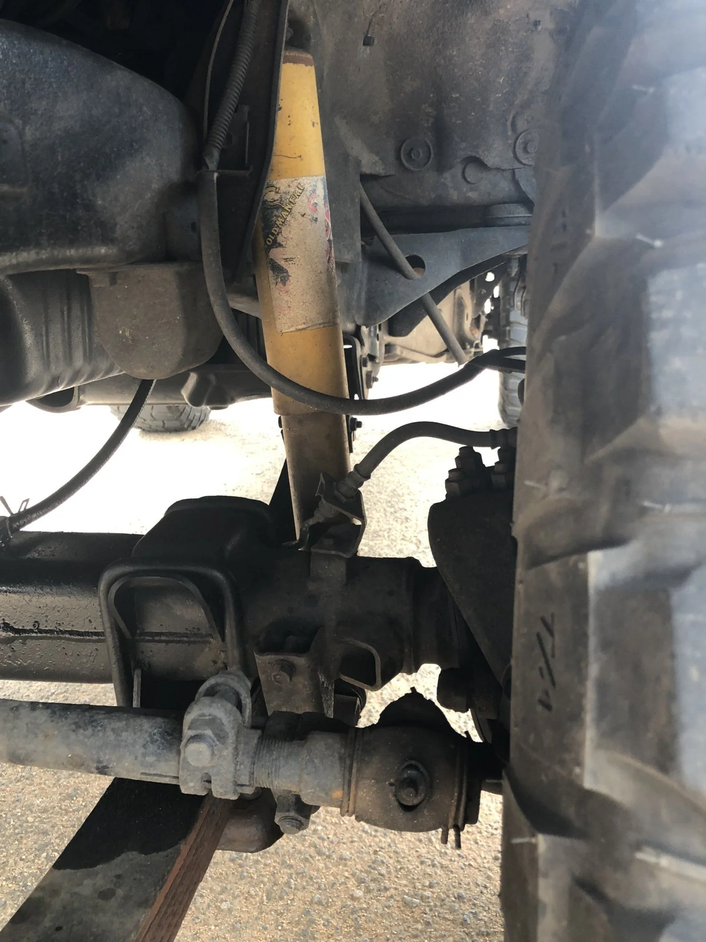

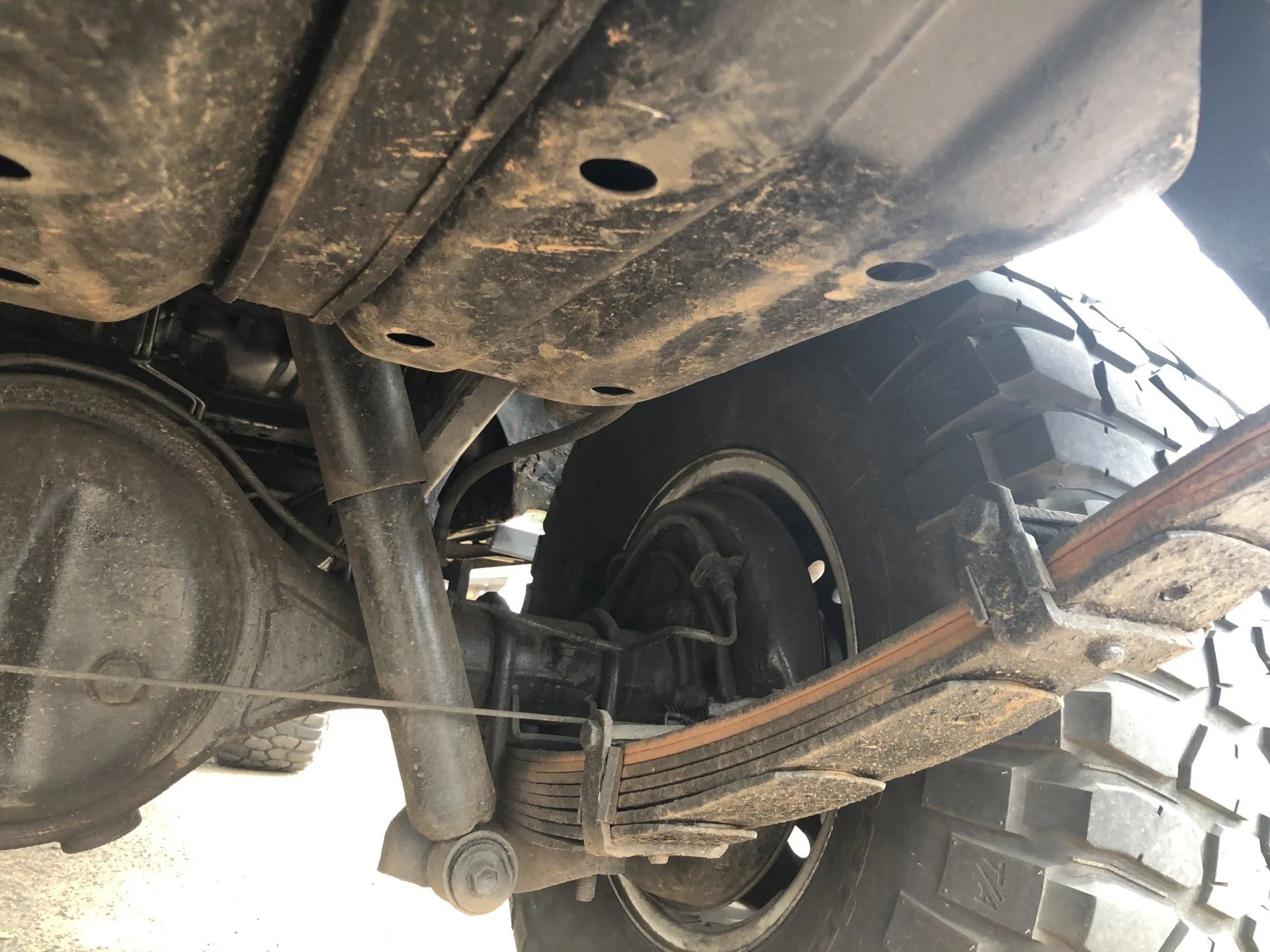

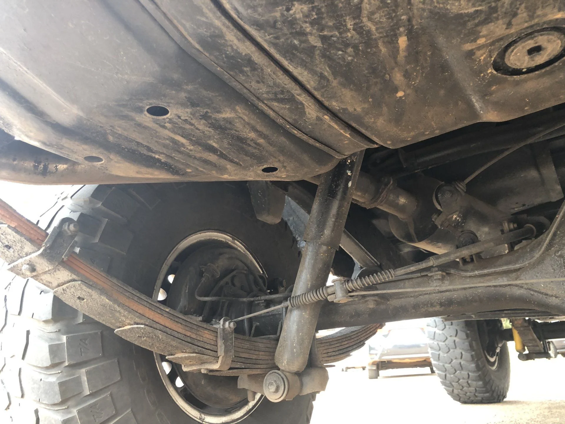

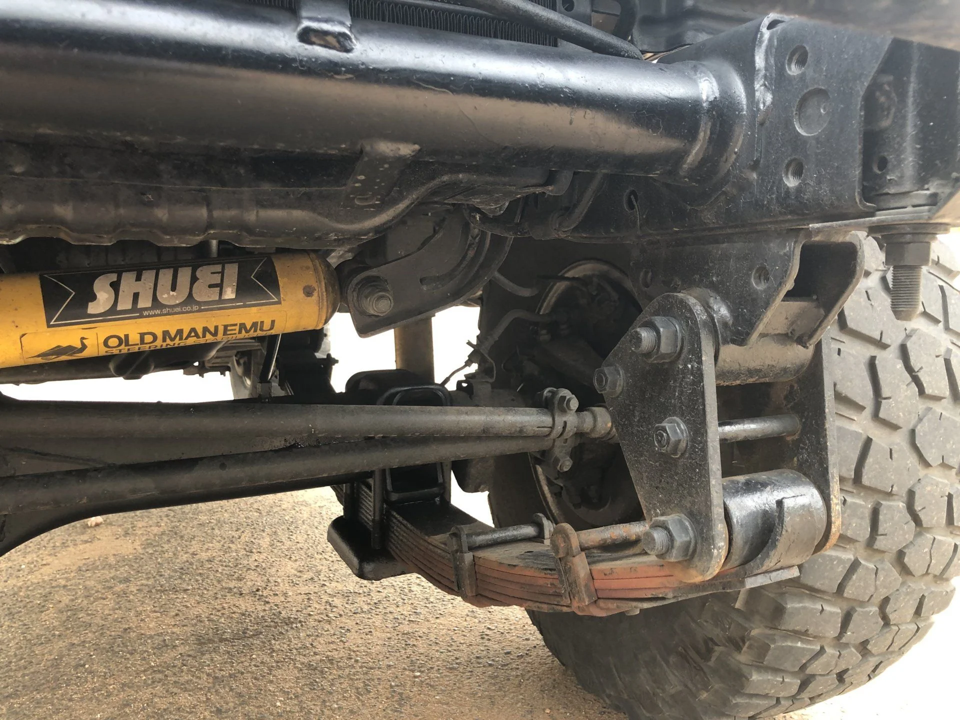

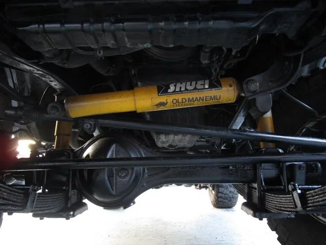

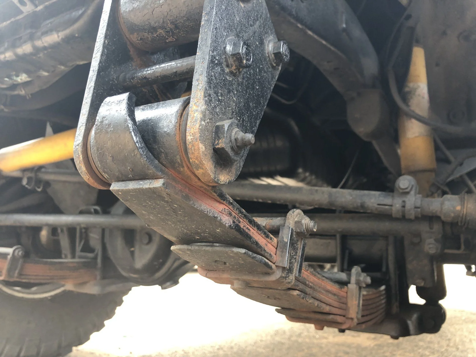

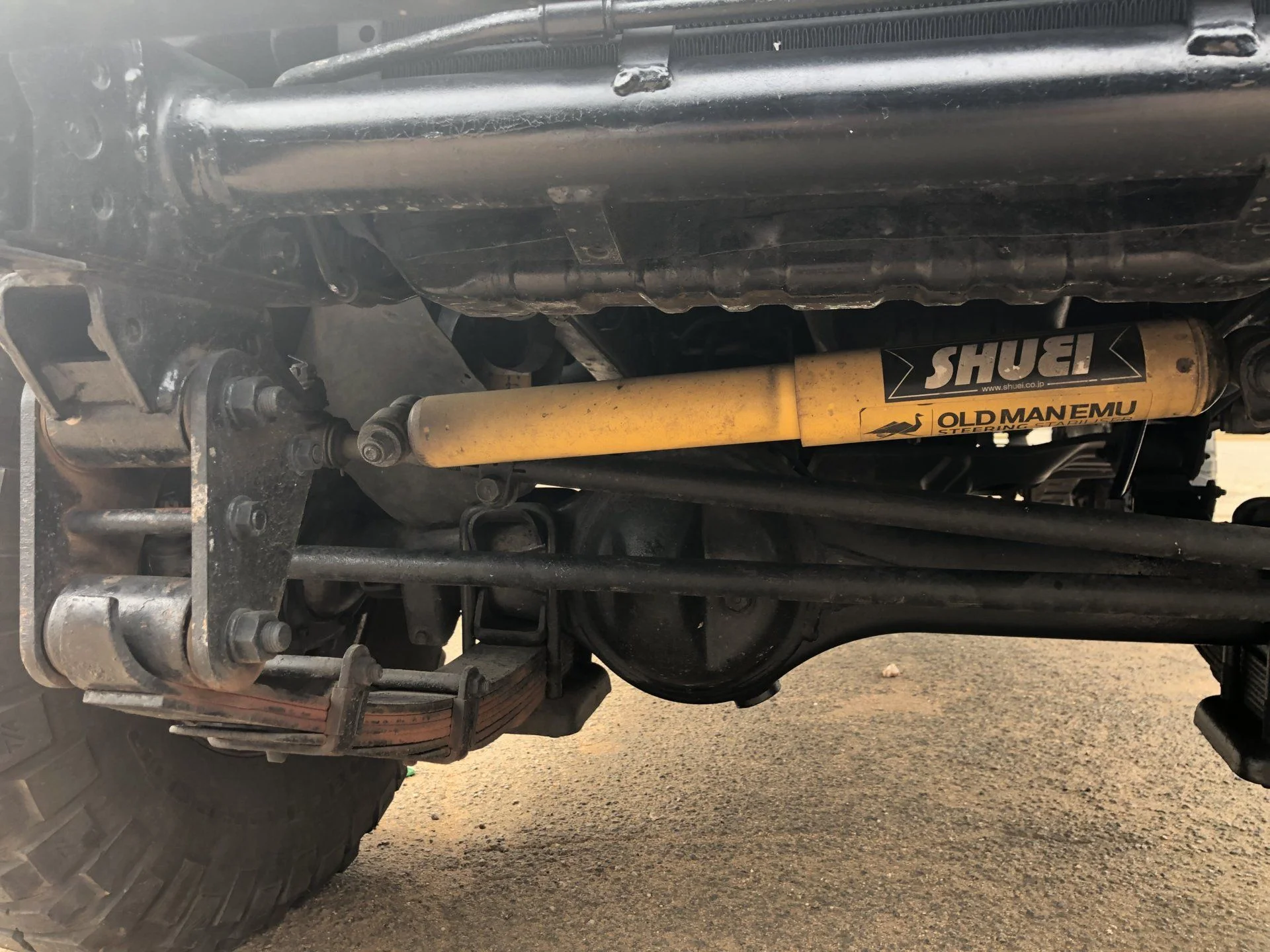

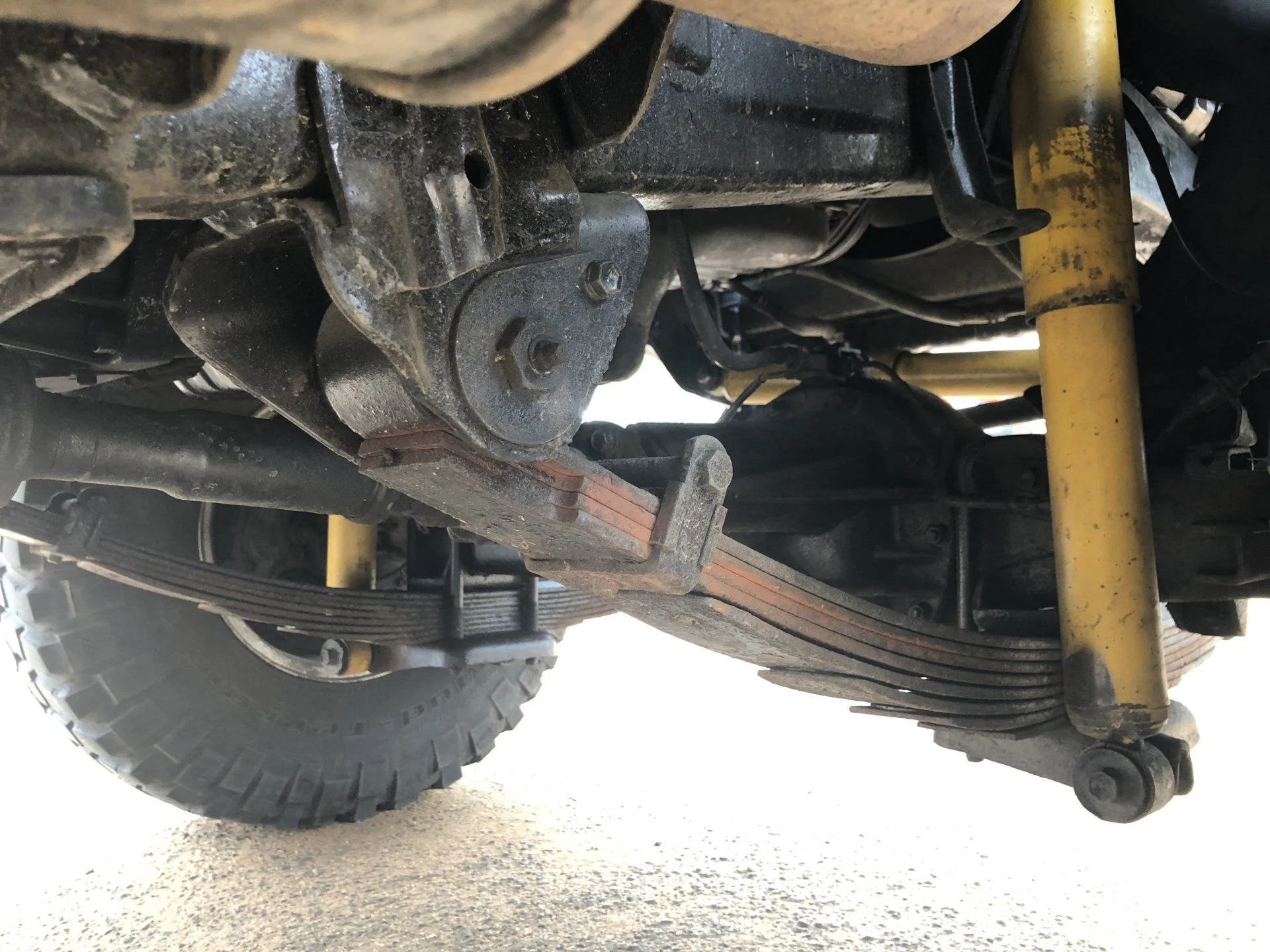

Thanks guys! I’ve uploaded a bunch of pics to check out.

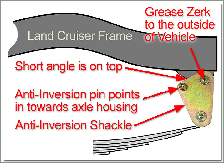

Did you grease the anti-inversion shackles?
Also, you could try to lubricate between the leaf's on the leaf springs.
You can also remove a leaf.

How to align shackle mounts with anti-inversion shackles?

It appears to be an ARB Old Man Emu kit, which is usually regarded as a nice riding lift kit. That said, some people have found they need to take a leaf out of each pack and/or clean lubricate between the leaves. Also, I agree on greasing the shackles, could definitely help.

looks like extended shackles in the front and not in the back. don't know if that would possibly cause a rougher ride. I would say it probably is riding like it should, it is leaf spring set up. I had a BJ-70 and I thought on road it drove quite nice for a leaf spring set up. I now have a ute(pickup) and I don't think it rides any better than the -70. Off road they will be a bit rough unless you can get some fancy custom tunes leaf springs. Have you ridden/driven in other leaf spring vehicles? Did they ride better?
I agree with Lazifarm. BJ7* can use the same leafs as 75 series in the front and 60 series in the rear. If heavy duty leafs are chosen, the lighter MWB models will have a fairly stiff ride. Try loading a few hundred kgs into the rear. If the suspension is good, it should ride very nice. But for everyday use it will be too hard. So you may need to take a leaf out of each corner.

I would grease the shackles.
It appears that the PO did not replace the rear shocks. A common practice it seems: the PO of mine did the same thing. They look like small bore OEM Toyota.
I would change all four shocks.

Do you know where in Japan it came from? New shocks, new bushings, let some air out. I would only recommend removing leafs it you are planning on not adding bumpers.
8 leaf packs in the front is high constant load and will result in a very hard ride. My hzj75 had 8 in the front, rode like it was welded. I have taken 1 leaf out, it was better but i am going to take another out.
I would load up the rear with a fair amount of weight, and if that fixes it take 1 leaf spring out of each pack. Grease it up first. Taking leaves out is the cheapest option if it can be accommodated.
