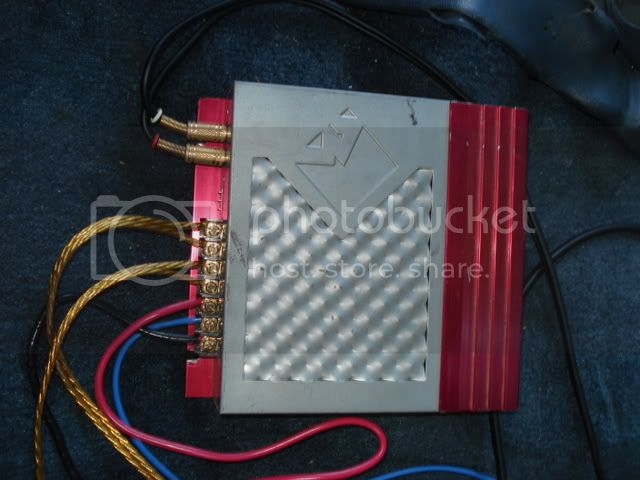

I had an old Rockford 2 channel 150W amp that I used to run my subs off of. It did well and was in the range recommended for the Polks. I wired that up to the new deck and installed it under the seat. I can't wait to see how it sounds with the new speakers. It is the Rockford Fosgate RF 2.6X. I can't find a pic right now but will have actual pics when I finish the install (I left the camera out in the truck).

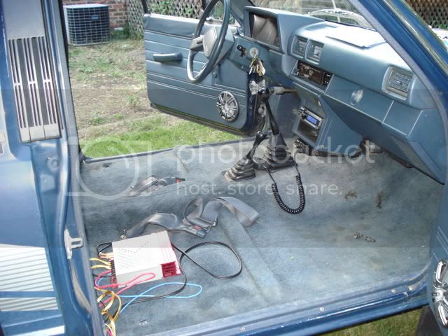

Amp setup as of Saturday (I just hooked up an old 6x9 in a box to get me through the weekend):
Today I went out to the boonies to pick up a new seat from Boheefus off of TTORA. When I got back my new speakers were waiting and so I pushed off work a little more and knocked out the install. Here we go...
One speaker installed, the other hole cut, and the first time it occurred to me to take pics :) :
Speaker installed. Yes, I slipped with the drill and poked a hole in my door panel. Yes, I am mad about that. I'll try to fix it later:

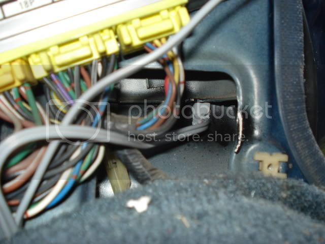

Sorry this came out fuzzy.. This is how I ran the speaker wire from the door. There is a hole that goes through the hinge so I just made it a little bigger and ran the wire behind the hinge so it wouldn't get pinched. That goop on there is silicone just in case:
Here's where it comes into the cab:

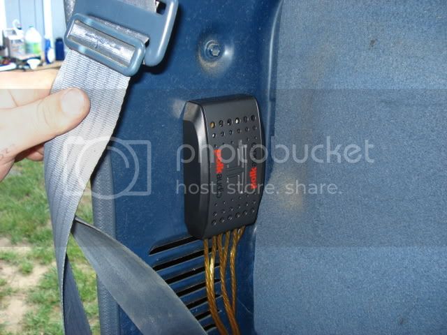

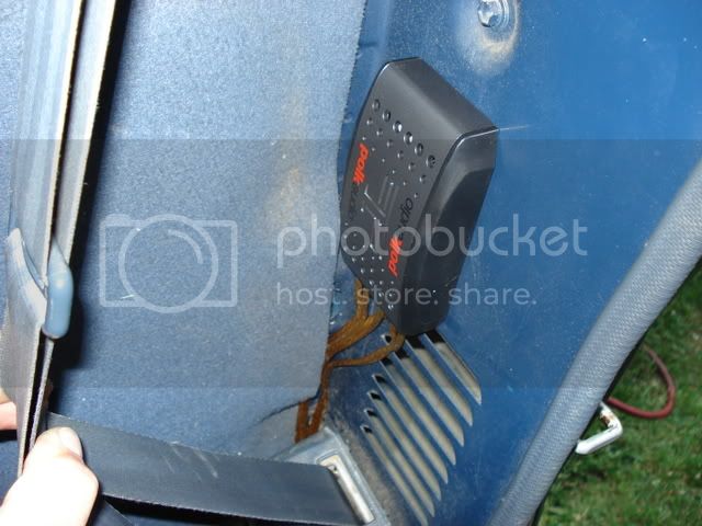

This is where I mounted the crossovers. Yeah, it's not ideal to have them that far away from the speakers but I think it'll be fine. They are mounted very solid with 2 self-tapping screws and are pretty much concealed by the seatbelt and kinda behind the seat:

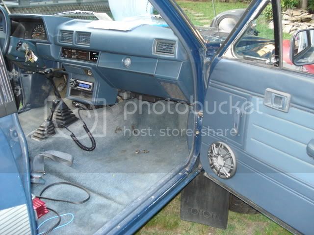

New stereo installed:
Other speaker installed:

1- Why didn't you mount the crossovers right beside the amp under the seat?

1- I didn't want the crossovers to be so near to the amp because of interference, noise and such because of the high power. Maybe paranoid but it made sense to me ;p. Plus, there really is no use for the place where I mounted them and they're not getting tangled up with all the amp crap.

3- I forgot to take a pic of that. I cut a slit in the boot for the engine harness and ran it through there. I just sealed it up with some silicone. If you end up running it up the other side you can normally poke the cable through with the speedo cable.
